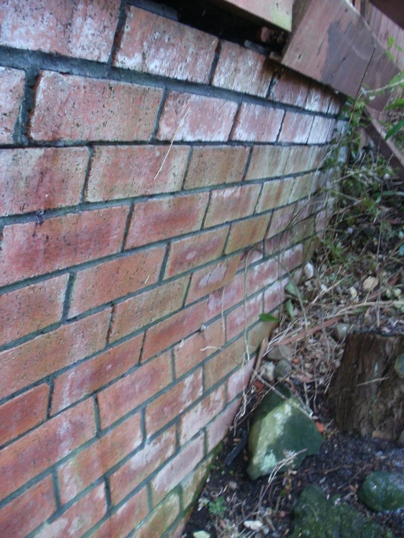

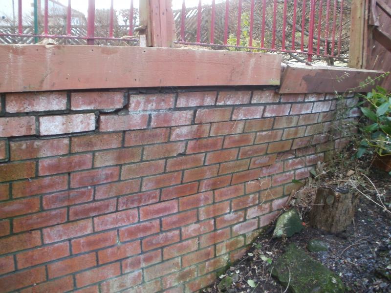

A garden retaining wall on our boundary grew a worrying bulge yesterday following the strong winds in recent days. I've removed the fence panels above the wall as we believe they were acting as a 'sail', contributing to the fail.
The bulge appears to be affecting just the top 10 courses or so, and I wonder if I should just remove that top part and rebuild it, or would it be wiser to take it down lower (all the way?) and start again?
The wall runs for 15m between our and our neighbour's houses, though only one end (away from the houses) is affected - so far. It was built 25 years ago by the house builder with a height difference of 5 feet between ground levels, and sits approx 5 feet from each house. There's no sign of drainage (no weep holes) so wonder if that needs to be addressed to avoid future/bigger failures.
Should we try to re-use the bricks or use new ones? Should I play safe get a structural engineer in?

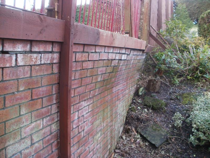

Would help to have a shot longer away.
If there is no immediate danger then maybe wait and see?
If not it looksl iek the bottom half could possibly stay.

I've added a photo from further away. The bulge is to the right end, and you can see where I've removed the fence panels above
Unless there is damage to the left side a repair may be the best thing but it could get messy if they have to start taking the frame off from above
Are the walls tied together if any way? You might be able to see down the broken part.
It looks to me that there is mud on the other wise of the broek part so perhaps that is pushing into the wall causing it to break.
In your shoes I would call out a building/bricklaying person and ask them to check it over and provide quotes for vaious options.
You should dig test holes at the very LH of pic 5, and just where your garden begins to rise below the bulge in pic 5. Remove just enough, dont open up large holes.
When the foundation is exposed bring in a structural engineer. Prior to the SE visiting, discuss this matter with your neighbour, and think who will pay for any work?
This might be party wall territory so discuss this when calling a SE, and have your deed plans available.
Given that the movement was sudden then its serious and requires immediate action. Up or down, no kid's should be allowed near that wall.
Given the rising ground, the height of the wall and the proximity of both houses then the retaining wall was incorrectly built in the first place eg. no buttresses. SE's sometimes recommend a formed up steel and concrete retaining wall with a brick facade - but wait and see.
