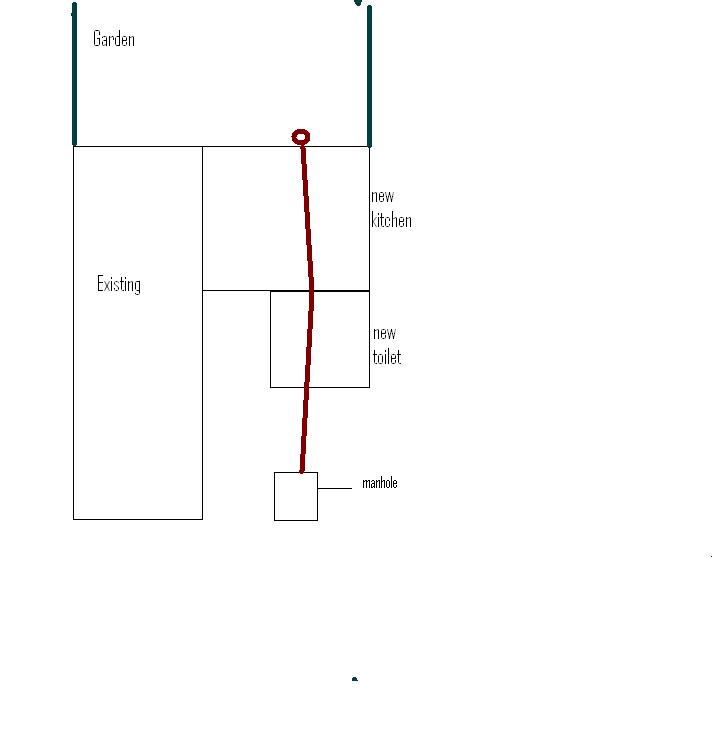

fall on a drain
I tried to ad a diagram i did in paint, but didn't know how to upload. however its just as i've described in the post.
Is it not clear?
I'll the have a gully outside the kitchen,
B) Is it ok for rain water from guttering to go in to gully? might sound a little dumb but ive been told a soakaway is better for something to do with regs.

How were you going to run the rain water into the kitchen waste if it's inside?

I'm not sure but I suspect you'll have to, at least, have a rodding point in the WC stack and feed the whb waste into that same stack. You might have to install an IC at the join in the drain run, (an airtight or double seal cover) By putting a 'y' junction to the main run from the WC stack, you might get away without an IC, but I'm not sure.
I think your kitchen waste will not be a gulley, but a simple rest bend, but you'll have to make an airtight connection. The u-bend under the sink will be your trap. How will you provide w/m or d/w connections? It's possible to provide these with traps, I think. Again you might need an IC at the join to the main run, or provide some rodding access at the sink. This might be just by disconnecting the sink waste.
The start of the run is the gulley outside, but you may not be able to feed rainwater into this, so why is it there?
If the intended extension is beyond this, then that will be the start of the run. Anything else will either join via 'y' junctions or ICs.
Which way does the run go from the existing manhole 'cos you can't introduce new inlets against the flow.

So add the positions of the WC, whb, sink, w/m, d/w, exisitng flow of waste in the manhole.
Any surface water drains?
What are you required to do with the surface water from the new roof?
