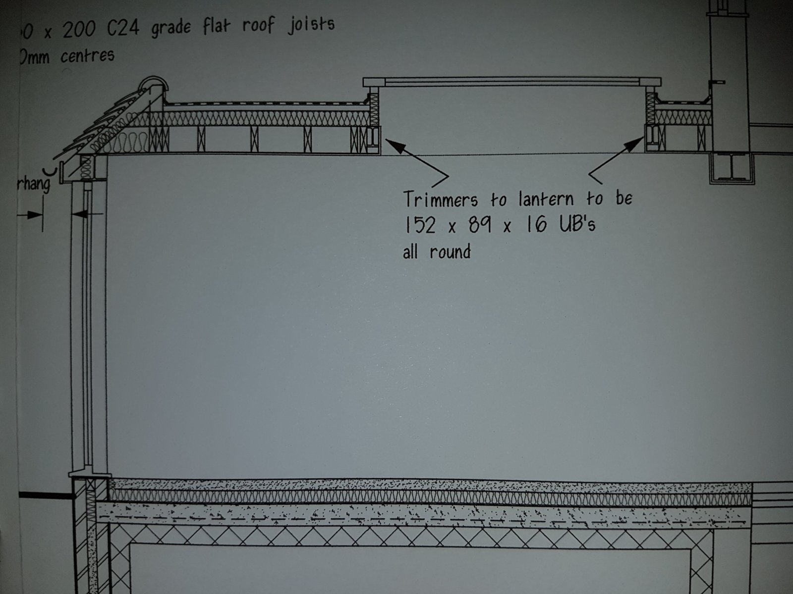

Evening All,
I have an extension to be built with a warm flat roof, likely format, 18mm deck, VCL, 120mm Roof Board / PIR type insulation like Kingspan TR27 and a built up high performance felt membrane, probably 3 layer.
There is also a false pitch where things look a bit more tricky to try and get continuity of insulation.
What is the normal accepted approach to try to get similar levels of insulation / air tightness in that perimeter corridor, beneath the false pitch, around 3 of 4 sides of the extension area?
The false pitch is pitched off struts from the flat roof joists 400mm back from the walls.
The struts and the false pitch roof joists are 100mm deep.
The designer appears to be showing insulation bats between rafters, nothing actually written in text and in addition, 165mm insulation [edit: boards] sitting just above plaster ceiling level between flat roof joists just in that false pitch corridor. Not in rest of flat roof due to warm roof being present.
Worries me that corridor area, (the outer ceiling / roof cavity), could become trapped with warm / moist air with tight insulation between rafters below the warm deck level.
The ceiling plaster board is specified foil backed but won't stop everything, that is what the VCL is for?
Would it be better to fit insulation board between false pitch rafters, like 50mm or 75mm between the 100mm deep rafters of false pitch and then another 50mm or 75mm underneath the false pitch rafters? Aim would be to try and get similar performance to the 120mm insulation on rest of roof to avoid issues, edit: Cold spots, condensation, drafts...
If I am on right track, could you or would you put a vapour control layer on the underside of that insulation below rafters to help seal for airtightness or better let moisture vent through the breather membrane and plain tiles?
Image attached.
Appreciate any help. Thanks

Looks exactly the same as my extension. Basically a warm deck flat roof hidden behind a tiled pitched roof. I treated the 2 parts as separate entities. Warm deck as specified except I used GRP on top, then for the pitch, I treated it like a loft. Used 270mm of loft insulation. No vapour barrier as the eaves are vented so along with the breathable roof membrane under the tiles, should deal with any condensation.

Although Pilsbury is the false pitched/flat roof meister, I'll add my 2p's worth.
Fill it all with insualtion. Celotex directly under the deck and tiles, a then quilt. No air gaps, no ventilation.

Unless it's changed the current standard for roof insulation is 100 between and 160 over the joists. With joists all the way up, it would be more than 260 overall.
U value would only be .22 with no joists whatsoever with 200mm, so 200 between wouldn't really be enough.
Ps your designers should have calculated u values and thermal bridging limiting u values, also done condensation risk analysis for any non standard details they are proposing.
It's not for you to go changing it afterwards as they might not take responsibility for it being ok.
I'd recommend going back to them and asking for more details.

The whole principle is that if you remove cold surfaces, and remove air voids, and remove potential for air to get into the structure for good measure, then you remove the condensation risk.
The problem with vented flat roofs (your problem) is getting through-ventilation. Your lantern well, and the pitched section will prevent this without ridge and abutment ventilation - which can be unsightly and awkward (plus costs and potential for defects) and which can all be avoided by designing them out.
The detail in the drawing is lacking!
The flat roof is a warm roof construction. Pitched tile roofs are generally cold roofs, esp on houses as insulation is generally at ceiling level.
The last tiled skirt job I did, an orangery, I built with a warm tiled roof. That was insulation in between and over rafters. I did counterbattens to form ventilation for the tiles.
The detailing I got from the Tyvek/Dupont site (membrane supported over insulation fig 34).
I did it that way as it seemed to be a more robust details, the insulation of the whole roof is a warm construction method, with insulation running across the outside all the way. The eve detail is awkward to avoid a big lump at the gutter line, but I managed it work it out fine and the project was for a listed building.

Regarding ventilation, isn't the only bit if this roof that could, possibly be needing ventilation, the cold roof area below the false pitch. Which maybe isn't cold if filled totally with insulation...
Isn't the rest of the roof conventional warm roof? So no ventilation required beneath the deck, assuming a VCL installed above the deck (bonded to it) would be installed and then insulation on top. That is tried and tested? It just seems the junction between the false pitch and area under it is messy and so much less clear.... Or am I missing a bigger picture....

Why construct a warm flat roof and a cold piched roof? Why not have them both as warm roofs?
Moving on from that, why have an area of air below the warm roof insualtion when it can be filled with insulation? This will allow the reduction of thickness of Celotex under the deck/tiles by using quilt to compensate for less Celotex, or will create a much better insualted roof by using quilt to supplement Celotex.
That's what I was alluding to in my first post, in the construction of a completely insulated roof structure.
Then there are no issues in venting, part venting, designing an interface between the two or even the potential for air leakage by having any sort of void - vented or not.
