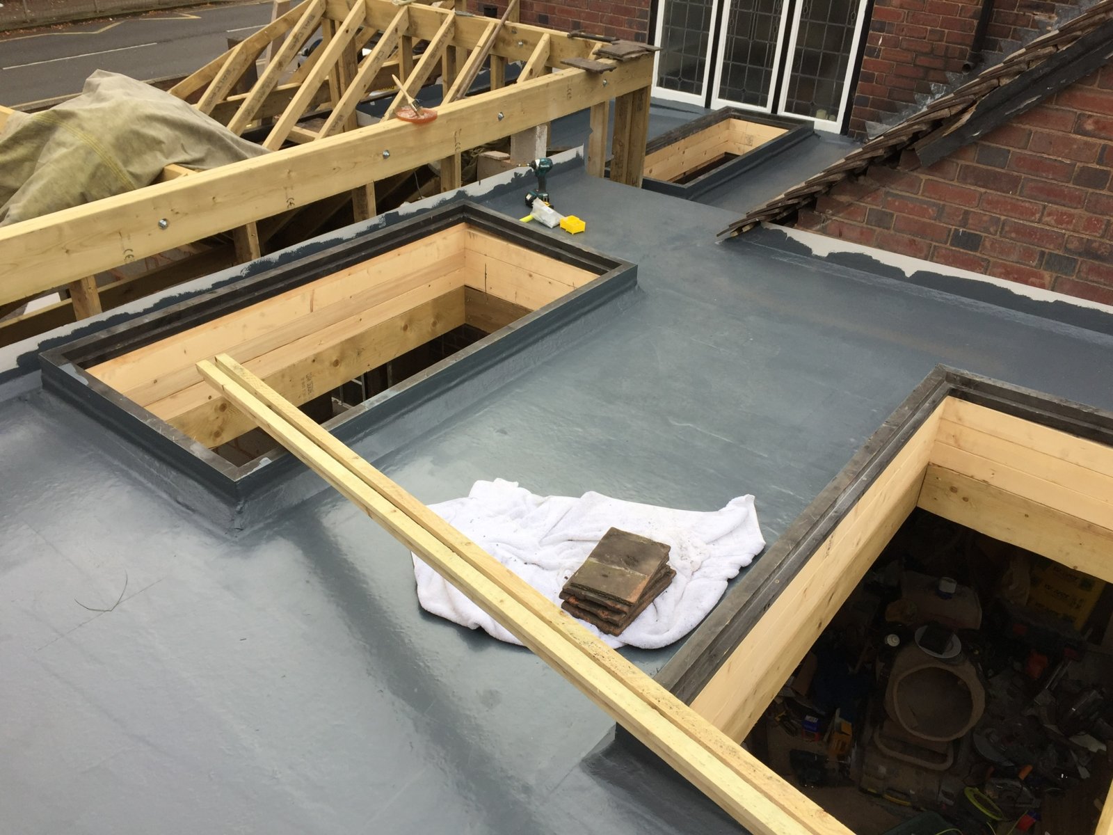

My flat roof lights had 75mm kerbs. So I just used 2x4 to build up then fixed the kerb on top. I then fixed some 18mm osb to bulk out the outside a bit before fitting some timber fillets to get an angle to GRP over. Seeing as timber isn’t too bad in transmitting heat, I figure that layered 2x4, Osb and timber fillet with GRP over isn’t gonna be too bad at heat loss..... I think......

Thanks for you photos, the roof membrane GRP and detail stuff looks good to my non builder but technically focused eyes.#

If you think about it, timber windows are jusr timber between the cold outside and inside the house. They dont suffer condensation, at least not on the timber!
My main business is building timber orangeries, we do a 90mm glulam timber upstand with 25mm celetex externally.
