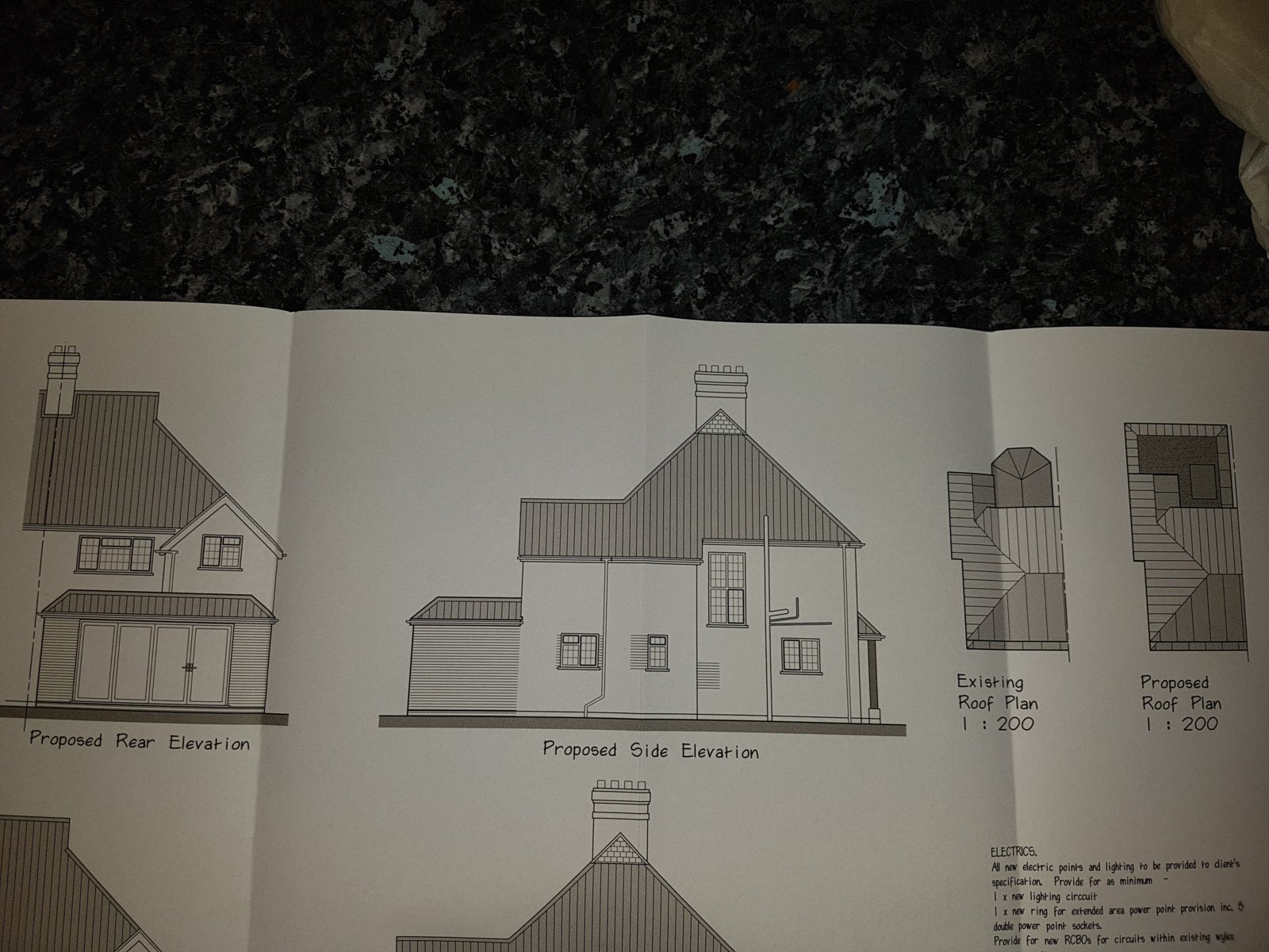

Thanks for you interest and reply. Really do appreciate all the input.
Sorry, my lack of roof detail experience may show, I do not know what seggy ridge is, depsite a google search!
The reason why plain tiles are used is to match existing roof pitch and elevation finish. I'll upload some more elevation views. What is the problem with the plain tile layout at the start of the pitch, is it there is not enough overlap of the ridge tile?
I agree re the drawing of the insulated upstand and condensation vulnerability. That was my totally worry when I first looked at all this before worrying about the area under the false pitch which I just relied on the designer for.
Some builders who have quoted have told me they just build a timber upstand and I have said "no way" to them. It is the weakest insulation in the whole roof structure and the highest point, and glass creating cooling when hot air hits it too..... It is a fair size too 1.5m x 2M. So the perimiter of the upstand is not insignificant.
At least he has shown it insulated but as you say, it appears to have no structure around it!! I can get him to add it in the drawing and notes. So I would be thinking a ply box section with uprights (section studs? every 400mm). And assuming a width of the upstand of no more than 90mm, 18mm ply box work, that leaves no more than 50mm for pir board, (comapred to 120mm in the warm roof) but I can't see any way around that.
That has to be far better than an timber kerb upstand right?

Lantern upstands (kerb) like all flat roof lights should be 150 minimum so that a proper seal can be made below the cill and reduction of splash and drip problems, and for future maintenance.
Then, bearing in mind that heat is flying out through the glass above, and there is only a bit of upstand section above the roof, you only really need 25mm of celotex lining the inside to take the cold surface away. More insulation would be better but lantern designers don't tend to allow for this in their cill widths. A ply box section would theoretically provide more insulation, but is not worth it in practice as the gains are minimal compared to the effort and cost.
The upstand is generally a couple of sections of 50mm timbers fixed together, and fixed on top of the double joists/trimmers. The depth of these timbers depend on the furrings and need to allow for 150mm above the deck at the higher end of the roof. So need to be quite deep.
BTW that drawing not only is a poor detail, but does not even show any furrings on the joists, nor a sloping lantern. You're getting a trully flat roof and lantern glass. That will be fun.
I am not trying to be funny but what exactly did you pay for? Did you get building regulations drawing? If you did has your designer provided them?
Looking at the first image posted it looks really lacking in detail and would not be accepted under full plans.

The upstand design will need to be sympathetic to the space you have regards the roof window jambs and whether they can deal with the extra bulk, without encroaching onto the glazed area.
It could mean that the bulky upstand structure goes beyond the footprint of the roof light as opposed to the more favourable (that's why the architect drew it that way) roof light overhanging the upstand.

I know about the 150mm upstand. In plans it is roughly 150mm. When I was talking about 90mm I was more talking about the width of upstand which you are terming cill width I think. I was just thinking if you made a 18mm ply box section with segment uprights you could get up to 50mm board in there.
So you would normally see 50mm timbers for upstand with a single layer of 25mm insulation then internal plaster compared with my more complicated ply box section? OK. I agree there is a lot of heat going through the glazing anyway.
I think when I view the plans I am also viewing with the specification text and how I know it should be done from my knowledge. Agree the section could do with a lot more detail. There are firings in the text specified at 1/60. And a box gutter to one end besides roof light with two outlets. No details of depths / falls etc but my calcs suggest firings would need to be about 105mm if allowing 25mm for the box gutter.
Yes all the roof lights require min 5 degree pitch so that is a given. Firrings aren't shown agree. Can ask him to and yes this is a building regs drawing from an ex building control guy and his plans do get through. I am planning on using a private building control inspector.
Thanks again. It does tell me I am adjusting things too much in my mind and the detail sections should have more detail / thought.

Yes exactly. Most of the flat roof lights (5 degree pitch) seem to be about 90mm allowance including plasterboard. So 75mm without. So it is either a ply box section or as woody says timber with 25mm... My box section would seem higher performance , but maybe not worth it for another 25mm pir?

I would do it how he has drawn it. I would build my flatty. I would spike the rafters (faux roof) to the ends of the joists. Lay the flat roof insulation material so that it butts up to the slope of the rafters. Then construct a small ply upstand on top of the deck insulation and fix this to the rafter ends.
The remaining quilt can be fed in from below or between the rafters.

But the whole point of drawings is that they are accurate. Obviously that shows how it is to be built, but it also shows up how it should look like and line up, and any discrepancies are seen and designed out. Also the builder knows what to order.
What I see a lot of, is poor drawings (copy paste from the last job) and just drawings and not design. Then when the builder comes to build, things don't fit in as they should, as they are drawn, and then the client either gets a bodge or is hit with lots of claims for daywork to sort out the design.
For the roof light, typically cills are 150mm wide so by the time you have two timbers for the upstand, and the external overhang, there is no much left for insulation. So that needs designing properly, otherwise it looks a bit crap internally.
Non of this gets picked up by the building inspector, as it's all quality. The drawings will pass, and the inspections are typically about the structure and safety.

Ok. interesting. Yes, that what I was thinking about the back of the strut for the pitch upstand, although to be fair he hasn't shown it or called out in text that it is formed in anything!! So another detail required....
What I was really referring to, when I asked you about the insulation detail, is the sort of mixture of having a warm roof, with insulation between rafters on the pitch and a cold roof insulation approach, by having insulation at ceiling level, immediately below. There is no ventilation from the pitch or would you want there to be. Have you seen it done like that with that insulation arrangement before?
Curiously, the ceiling section drawing looks like quilt but in the spec he has written 170mm celotex board. But wheather it is board or quilt it is still a normal cold roof set up?
Presumably the pitch will be unventilated, as no ventilation is specified, insulation is between rafters but looking though that pretty good guide by tyvec linked by a previous poster, he could do with a bit more detail on the pitch roof section, like eaves carriers, and is AVCL required under the false pitch warm roof (vapour layer required) etc etc. But then would that create a problem being above the roof level insulation...
