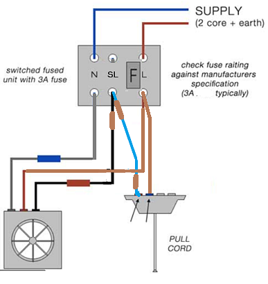

Wanting to fit an extractor fan in bathroom which can be controlled by a dedicated switch. I found the attached solution on here but when I switch the isolator on the fan starts and totally ignores the pull switch. is there a flaw in the diagram.

Fans generally run for their set time when they are switched on for the first time.
The first time being every time the isolator is switched on.
How long have you waited for the timer to switch off?
Show us the connections in the fan, and tell us what each wire is.
That seems to make sense, will try leaving it running in the morning when I have a bit more time. Many thanks for the help, really appreciated.
Your advice was spot on, working perfectly now.
