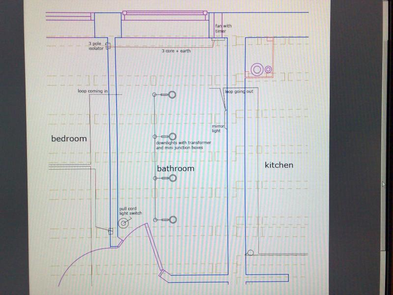

Before I ask the question its best you guys know some details:

Question:
I have 4 12v down lights (plus 4 small junction boxes) that I will be putting in the bathroom and also have a fan with a timer. I will have a pull cord light switch inside the bathroom and a 3 pole isolator on the other side of the bathroom wall in one of the bedrooms.
I want the fan to turn on with the lights and to remain on for 15 minutes or so after the lights have been turned off.
I’d like to know how to connect everything up so that it will work the way I want it to. At the moment I have some 4 core cable going from the fan location to a box on the other side of the bathroom wall which will hold the isolator. I also have the cables from the lighting ring coming in both sides of the room.
Thanks in advance for any help guys!

Thanks for the reply skenk but to honest i still dont fully understand!
Below is a plan of my bathroom (hopefully) and how the cabling has been done so you can see the current situation abd what needs to be done.
Just to be absolutely clear on whats what:
blue lines - walls
black lines - 1.5 T&E
purple - doors and windows
brown - 3 core + earth
yellow - beams and the notches cut into them
If someone could explain in laymans terms what needs doing id really appreciate it!
it's going to get awfully cosy in that pullcord...
take the "loop in" and "loop out" to the switch..
take a 3C+E from the switch to the fan isolator
take a T+E from the switch to the lights..
if you can fit a double pole switch it makes life easier..
put the brown from the loop in, loop out and 3C+E in the L ( feed ) terminal of the switch, the blue ( grey sleeved blue of the 3+E ) from the same into the N ( feed ).
then the brown of the T+E and the black ( sleeved brown ) core of the 3C+E into the L ( load ) terminal of the switch, and the neutral of the T+E into the N ( load )..
if you don't have a double pole switch then all 4 neutrals go in a terminal block..
alternatively you can do the same with a JB ( small enough to pull out through the light hole ) at the first light..
brown from loop in, out, swich and 3C+E in terminal 1.
blues from loop in, out and grey sleeved blue from 3C+E into terminal 2
blue ( sleeved brown ) from switch and black ( sleeved brown ) into terminal 3.
lights then connect to terminals 2 and 3 ( N and L respectively )
thanks for the detailed response coljack.
Since i already have a single pole pull cord and a few mini JBs i will probably do that method.
When you say for example "black ( sleeved brown )" do you mean i need to put a brown sleeve over the wire before it goes into the terminal like you would with a green/yellow sleeve for the earth wire?
yes, this is to indicate that it's a live or switch wire, and not a neutral..
you can buy twin brown cable for switch drops but no one usually bothers unless they're doing a whole estate or large install..
