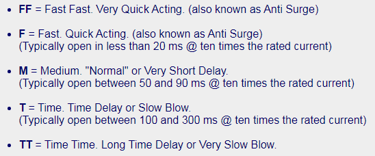

You still don't appear to have read the link I posted (I am assuming it is correct).
You will see that the relevant current is ten times the rating of the fuse so the various speeds of the different types of fuses are quicker/slower for the same current.
At lower currents the fuses will take longer than those times in relation to the times stated.
No 30A fuse will blow at 31A.
That would mean it was alright at 30A then vapourises at 31A - it doesn't work like that.
Have a look at these graphs:
https://components101.com/articles/choosing-between-slow-blow-and-fast-blow-fuse-for-power-protection#:~:text=If the fuse is changed,the startup of the circuit.&text=If a circuit has a,needs to be immediately disconnected.
