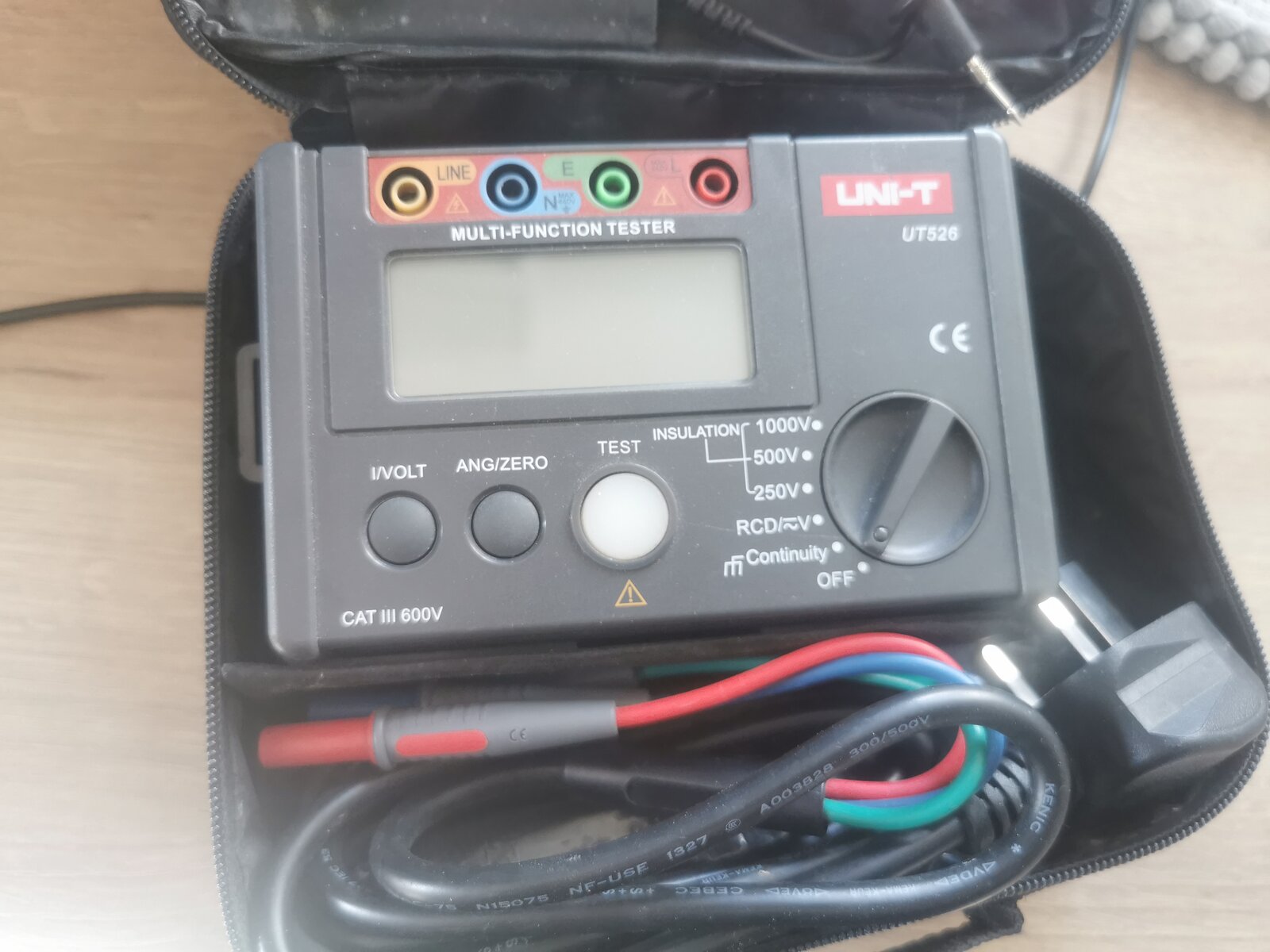

According to the picture of the CU.Are we sure the lights are on RCD circuits?
Or that the RCD works?According to the picture of the CU.
It's assumed that the RCD will trip at first. However, you're saying that the MCB did. It could have been that the L-E fault current was so high that the MCB operated very quickly before the RCD had a chance to operate.now that's a line to earth fault so should of tripped the rcd which leaves me with more work as to why the rcd didn't trip

No the tripping stopped so I cut back the damaged cable and refitted the switch and now the circuit stays energisedWith the switch 'hanging out of the wall' as shown in your pic, is the tripping still occurring?
