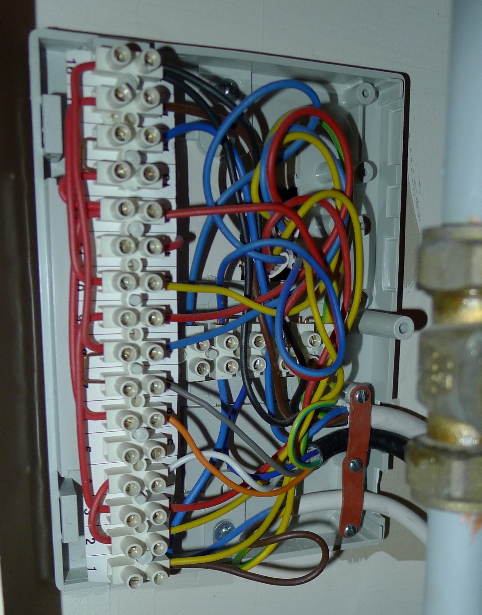

Part of the wiring centre detail:
16: CYL SAT .. two black wires going to the cyl stat (Why two? Looks like a 6-core cable)
15: CYL COM .. brown wire to the cyl stat
10: HW ON: Yellow
9: HTG ON: Red
8: HW OFF: Blue
7: Mid Pos valve: Grey
7, 8, and 16 have connecting links.
10 and 15 have a connecting link.
Two photos attached.
Looking at wiring centre what is the wires going into terminal 1?also with so many blues surely it needs sleaving on them to work out what is what?

Then there is nothing wrong with the valve.
The problem is this: when HW is on at the programmer and the cylinder stat has switched to SAT, because the water temperature is high enough, there is no voltage on the grey wire. This could be due to a faulty cylinder stat or a wiring fault.
The cylinder stat can be checked using a meter. Looking at the pic of the wiring centre, the required links (7-8 and 8-16) are in place, but it might be worth checking that all the screws are done up tightly, including the screws in the cylinder stat.
Why so many wires to terminal 16? There only needs to be one from the cylinder stat SAT terminal.

The two black wires from T16 are duplicates. The Cyl stat cable has six cores, which seems unnecessary but not actually wrong.
I agree the installer did not make a very tidy job of it.
I will first try a replacement MV. If this does not cure the problem (for £57 inc VAT & delivery .. reasonable price to pay) then I will eat a slice of humble-pie, go through that wiring centre connection by connection, label each wire, test for continuity, and draw up a schematic of what I actually have in that's rats-nest before changing anything else :-)
