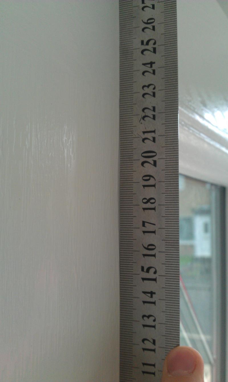

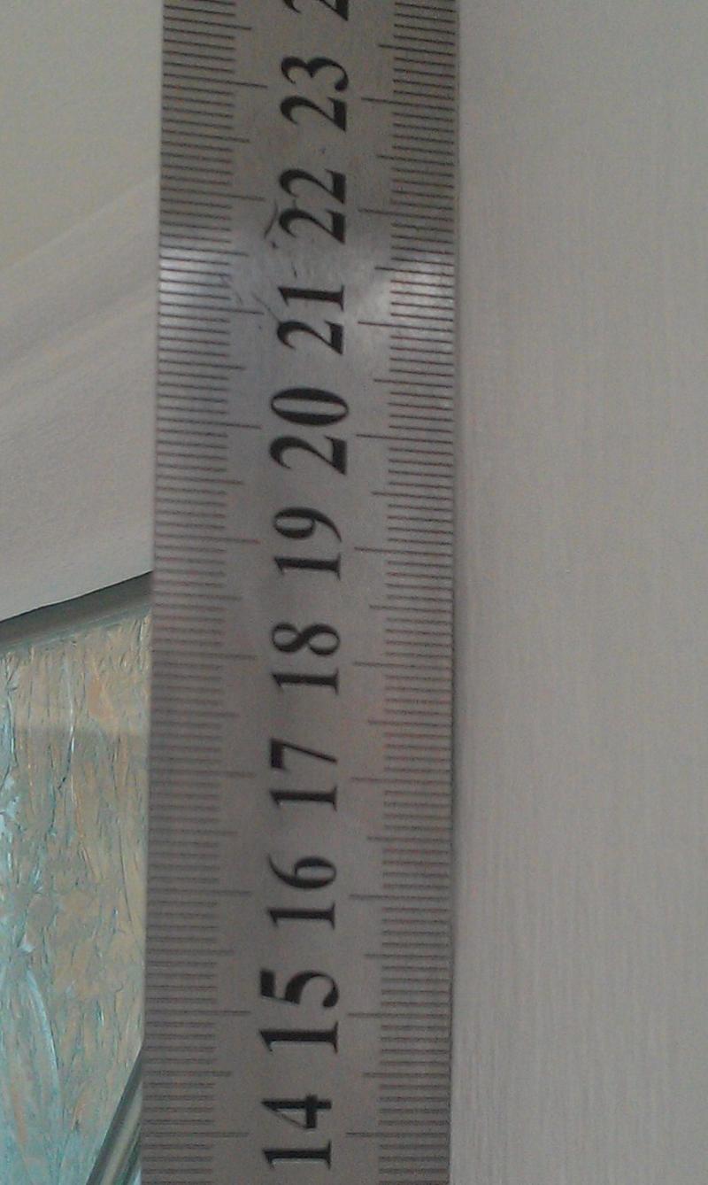

He has since done so. I have now noticed that the door leaks through the bottom of the glass. On further inspection there are indentations surrounding the glass. See images attached.
He has agreed to come and look at it but I think he's going to suggest filling with silocone, which I believe is a temp fix.
My first question is, what should be done about these dents and leak, and secondly, how many chances should I give this person before I just tell him to take back his porch and I order one from the next supplier?

If the door has dents in it, it could due to the overtighten of the blocks inside the cassette causing the door to squash, if its not that then the door must be faulty and should be replaced, either way we would send an enginner out to do a report, when and if your supplier gets in touch with us.

As this fitter replaced the door slab only, he re-used all of the fittings from the original door, re-fitting the glass and cassettes himself.
I have since had the fitter back out and he has said that he believes that he may have, as you suggested, overtightened causing these dents.
Should he be doing this himself?

Now if he has overtightened and caused indentations in the new slab, then i suggest if it bothers you that you request a new slab from him. he only has to tighten them finger tight and they will be secure enough.

As you said, he did confirm he believes that the dents (which you can see above have caused a slight gap) have been caused by over teightening them.
He has advised that it should be resolved by just loosening it up. I'm unclear if this will 'bounce back' as such, or if it will leave a permenent dent? Do you know?

he can loosen them , this means removing the silicone around the internal cassettes, taking them off and then loosening the screws onthe blocks a little , then replace the cassette and reseal, then leave it a few days and see if the dents close up with a 50/50 chance.
with regards to the colour of the door if its a diff shade of white, then he can take this up with the supplier if ur not happy, altho if its within the white tolerence zone then thats it, they usually check this with a color tool.

I can however say that the grp surface can and most definatley will fluctuate in width during the manufacturing process.
This can lead to (annoyingly) slight gaps between the grp surface and the cassette. This is standard in the industry and if noticed can cause issues to domestic customers giving the idea that there is something wrong with their door. Infact making the doors is just as frustrating when seating cassettes as the last thing we want is water gaining access through the door. The reality is that the bonding between the grp surface and cassette should be quite fierce in it's positioning as to fill gaps and deflect water and to over compensate for any manufacturing floors.
