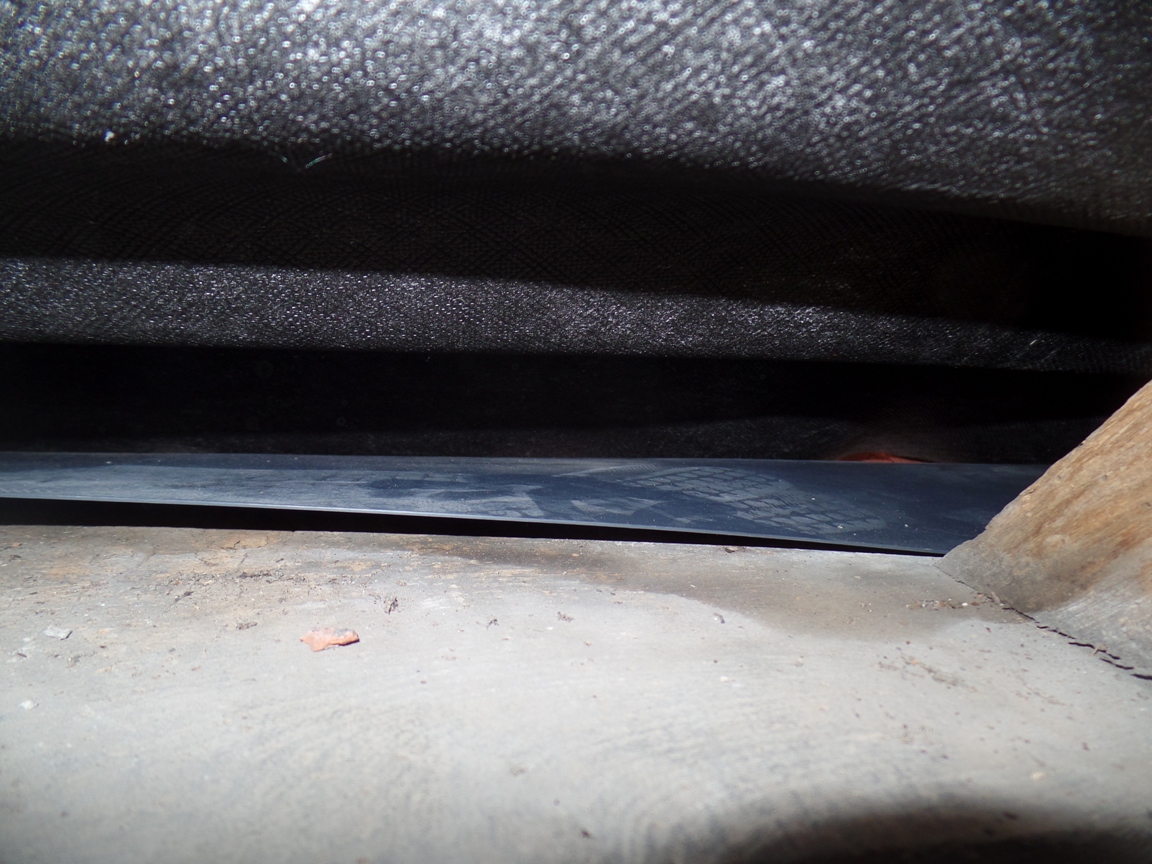

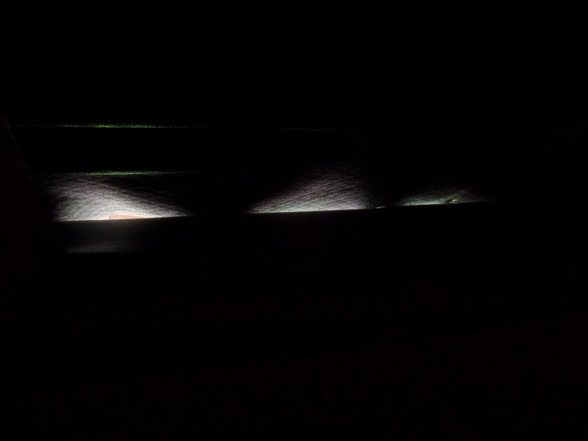

looking for any opinions as I'm not sure if I'm being picky about some work.
Had a roof re-covered, it's a old roof and the rafters are at the inside edge of the wall plate, not the outside edge. As a result the felt support tray wouldn't reach the rafters and instead has been nailed flat to the wall plate. As a result there is a gap between the felt and the wall plate where you can stick your hand through to the outside world.
Now personally I don't think this is an acceptable installation but that may be from the POV of a DIY'er so wondering if anyone else had any thoughts ?
coupla pictures in links below to visualise.
Thanks in advance for any thoughts.
Jake

I would have put in a piece of timber to support the trays.
Are these lead linned gutters?
@datarebal - odd, I've tried those links and they should work. I've uploaded them directly now.
@catlad - not lead lined no
@bobsuerita - prior to this renovation it wasn't, as part of this vents have been installed, they're under the felt support strips that have been nailed flat!

They are called underlay support trays. These support nothing. incorrect installation from what i see
so still unvented then
that must be a hell of a kick on the first tile they should of put small spockets on the rafter feet
