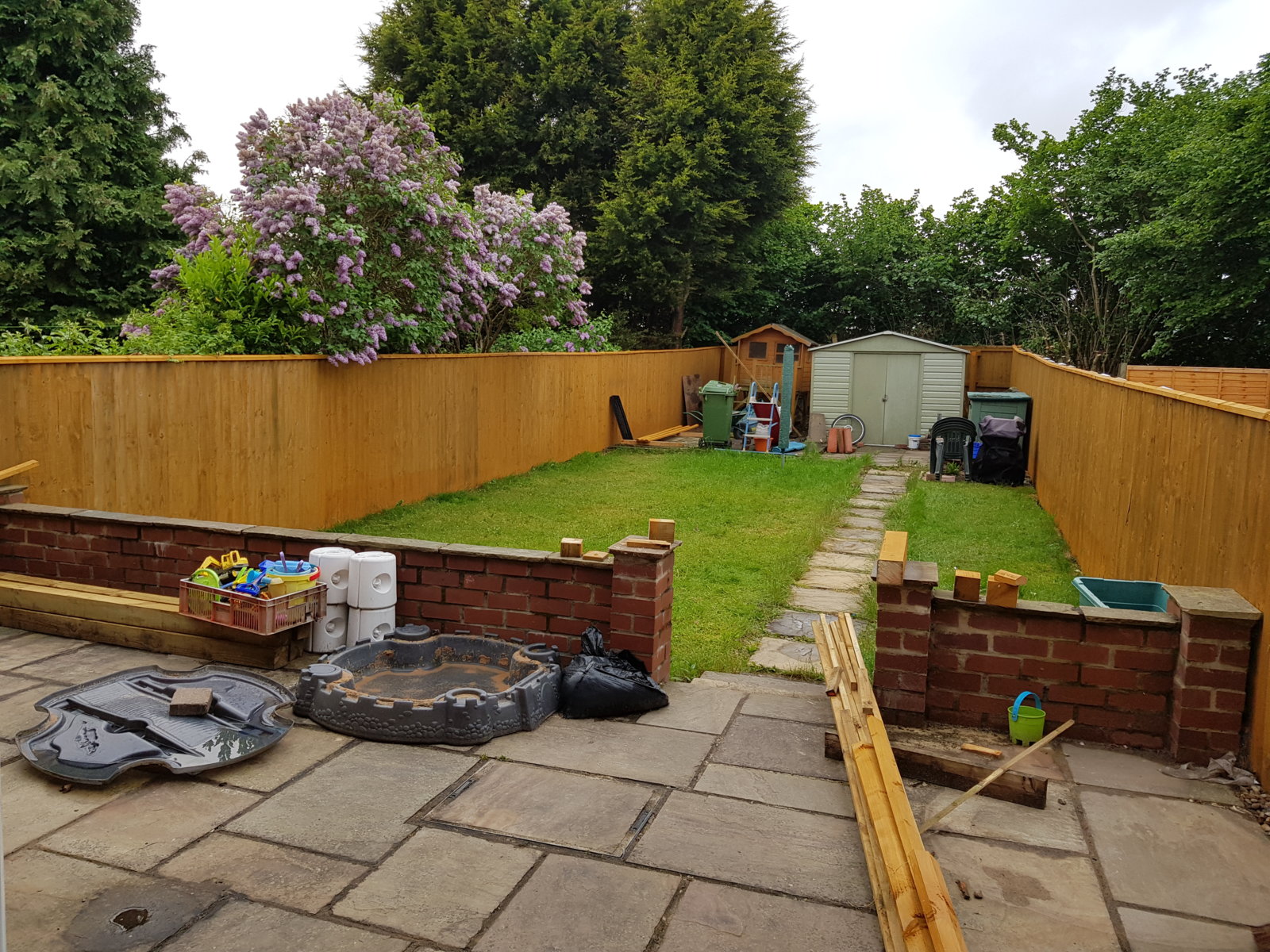

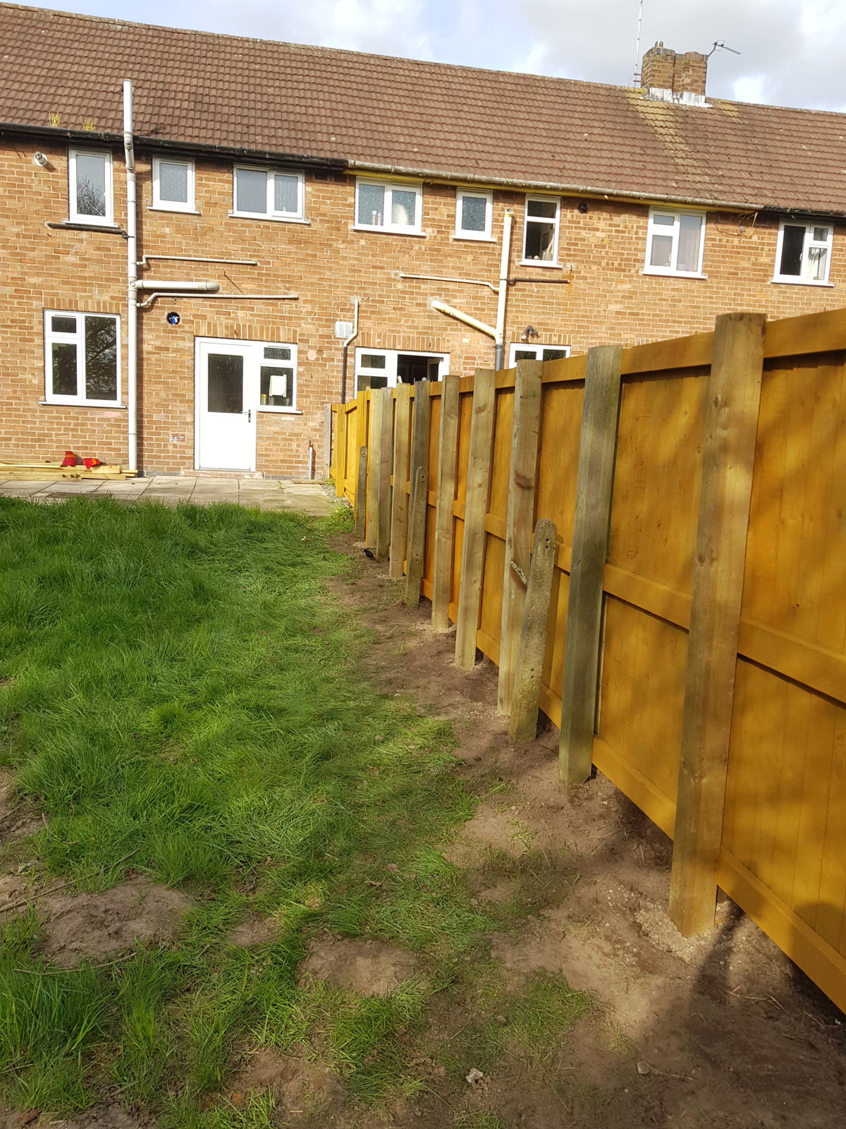

Ive just fitted 40 8 foot 100mm posts in 3 foot deep 200mm wide holes packed with gravel.
The fence is incredibly sturdy and hopefully the gravel will increase drainage!.

I had the option of carrying 40 concrete posts through the house and all over the garden or 40 wooden ones..
I'm amazed how sturdy it is, no worries about it going anywhere.
Worst case a few years down the line I'll have to re tamp them down but they seem even more solid now then when I put them in.
