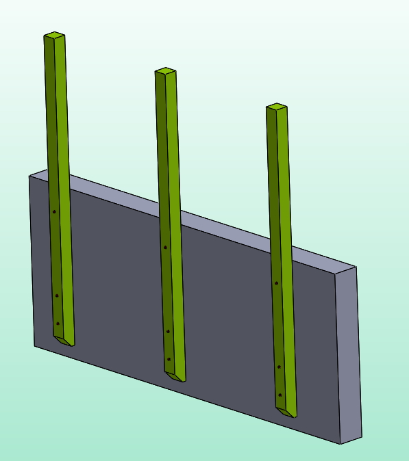

Fence post secured in metal supports sat on top of a wall will suffer in strong winds.
How about fence posts coach screwed to your side of the wall. Don't need to go in the ground and screwed to the side of the wall, will be better held.

Thanks for your reply DIYspanner !

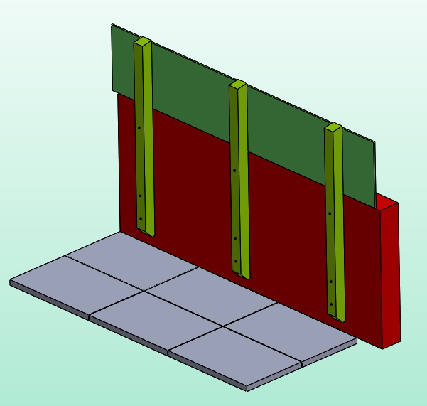

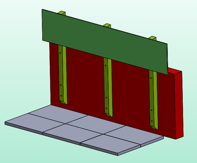

Presumably, the posts that stick out past the height of the wall would be 2ft? So I can fit 2ft high panels to them making them 6ft in total?
Thanks for the diagram.

I used to have that arrangement and a storm blew the fence, causing the wall to fail. Granted my fence was taller and this hopefully wont be an issue if your fence is only 2 feet high
full
I'd suggest running the posts down the wall to about 4" off the bottom so they don't get in the way when pressure washing the slabs. The posts above the wall to whatever height fence you decide on. Which side of the posts you fix the fence panels is best discussed with your neighbour. If they're on the wall side, they can sit on the wall and take a bit of strain of the posts.

Taking into consideration the collapsing wall mentioned above, perhaps some brick columns added to your side of the wall but for that, you need a bricky's input.
