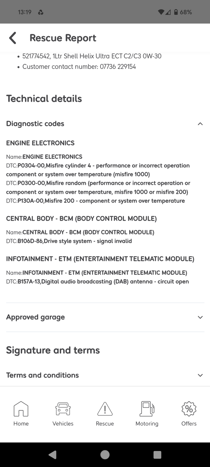

My car keeps misfiring I have replaced all 4 coils and spark plugs and still happening
Today I also got a code for the manifold sensor I'm wondering if they are linked?

Any codes for the misfire?
It can. What was the code?

Sorry one last question this was reported...
  • eml light showed map sensor fault. intake manifold temp showing 35 degrees c.
What does this mean is it to low or high?
It could be the sensor or the wiring. No one can say for sure without testing. The degrees is likely to do with when the code was set.
