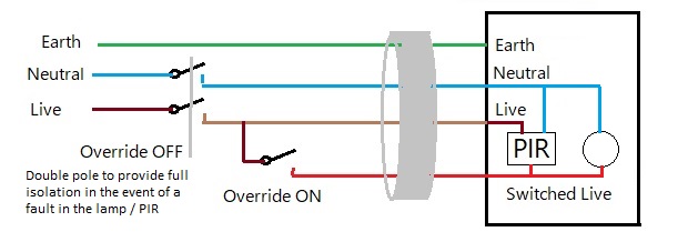

Hi guys,
Just a question in case any of you know the answer before I spend a lot of time hunting.....
I am after a Black half lantern PIR outside wall light with the facility to switch on via another switched live. I have run a 3-core and earth to the fitting.
Does anyone know of a place I can order from please? I have started the search but such information is neither there or is proving difficult to find.
Thanks in advance,
Dave.
