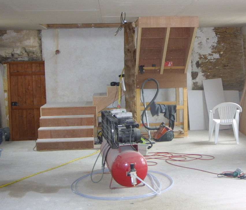

Quick question. I'm soon going to be fixing the finishing timber to stairs risers and treads. The stairs have been used for a while now with just constructional ply for treads and risers and no balustrade, spindles, etc.
Do I fix the finishing timber first to stairs, risers, and skirting, (which will be sanded, stained, etc) then the newel posts, balustrade and spindles?
Or do I fix the newel posts, balustrade and spindles first and cut the treads/risers around the newel posts and spindles?
The stairs are a two landing, three flight set, middle flight only is open one side. Lower and topmost flights are open both sides. No fancy bottom step. Top landing does return on one side so a level balustrade is required there, but it does not affect treads and risers.

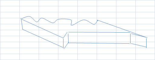

The nosings to the front of the treads, I was going to route on to the actual tread. (I've already routed an insert for the top tread/floor board, 'cos it was at perpendicular to run of boards, with a temporary riser to give proper dimension. There was a double joist to make it easy)
It was only the ends of the treads that I was thinking of half-round mitered in, slightly over-hanging the stringers, like this:
Having drawn that, I've realised that I might be better to mitre and fix the end strip prior to routing the end and the front nosing.
Thanks again.
Yeah that will work. I agree I would glue and fix the ends and then route the whole lot as one

Bringing up an old thread because I've discovered a new problem, if it is a problem.
I'm just about to start on the newel posts.
From the picture in an earlier post, (new one added showing mocked-up newel posts) it is obvious that the two lower newels, either side will be the same height.
However the second pair of newels, at the first landing will be different heights, the right-hand newel higher to account for the balustrade for the second flight of stairs.
The left-hand newel will accommodate the left-hand balustrade for the stairs and the landing, whereas the right-hand newel will have to accommodate the balustrade for the first and second flight.
Is this normal? It looks a bit odd with the newels simply placed roughly in position without balustrades, etc and them being different heights.

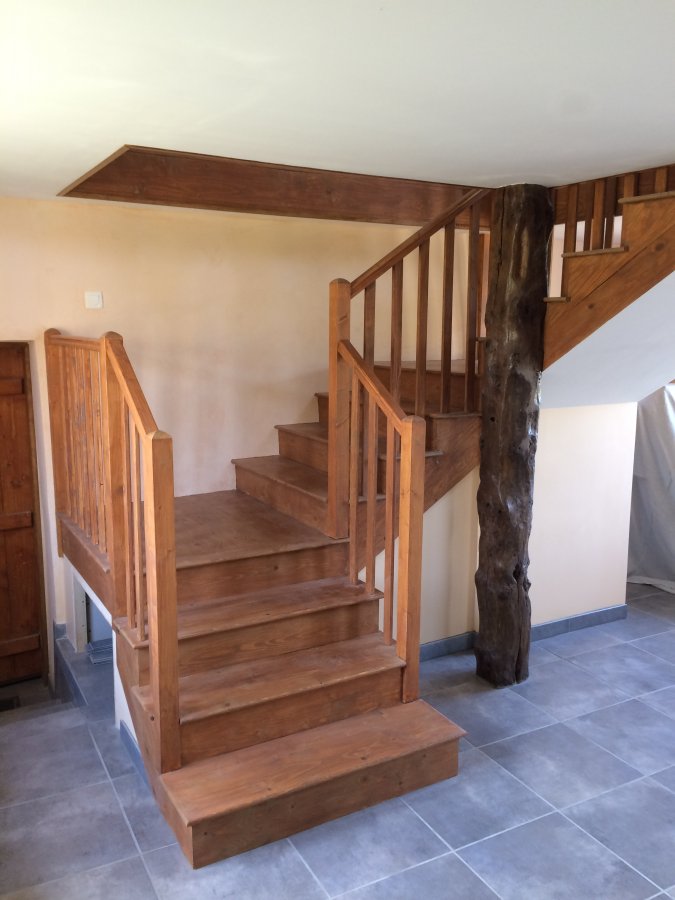

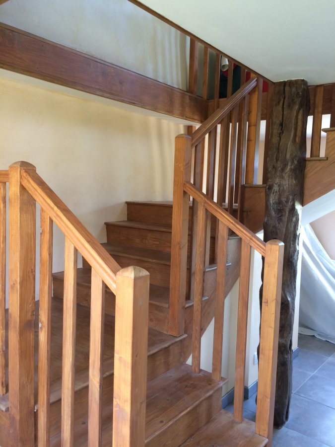

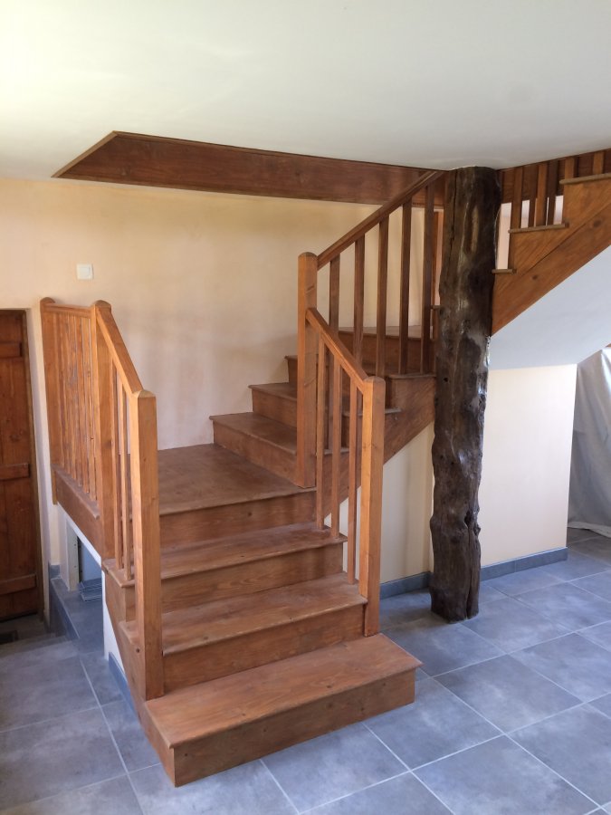

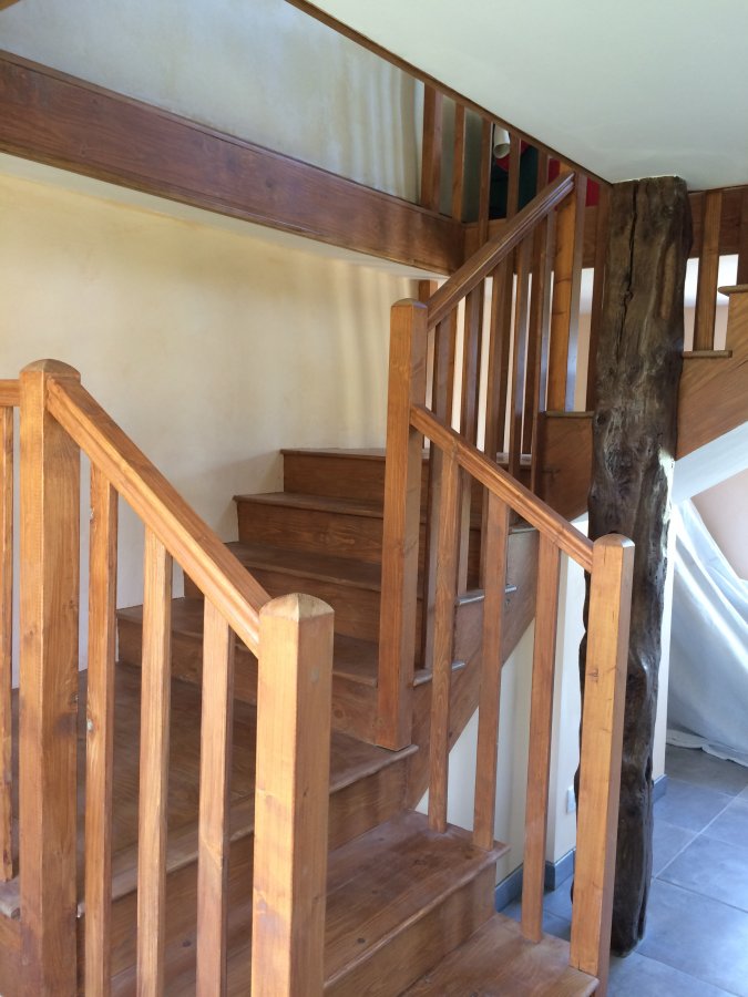

I did say I'd post a picture of the finished stairs:
It's been a long job, maybe because I had to make most of the parts my self.
I didn't, in the end, rebate a piece into the ends of the treads because the end grain wasn't that much of a problem. Maybe because I rounded the ends to match the edges.
I've still got to put doors on the cupboards under, but that's a minor job now.
