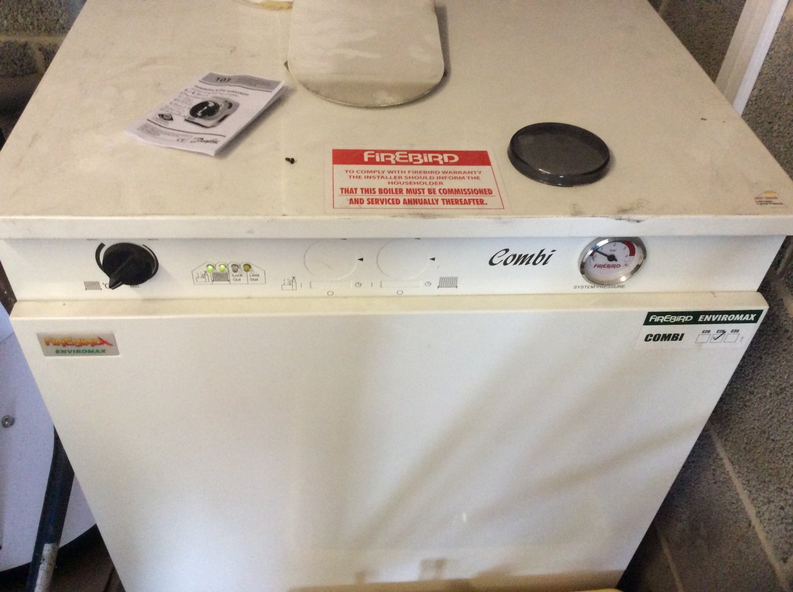

We recently bought a property with an oil fired Firebird Enviromax C26 combi boiler.
We seem to be going through a lot of oil. I have set the timer but it seems to be coming often out side these times.
Is there a way to switch it over so it will come on when we need it?
Not much money coming in at the moment so funds are quite tight, like most people I imagine.
Thanks in advance
Allan
It's probably firing up to keep the store of hot water up to temperature. Does it have any kind of timer behind the front panel? Can you post a photo?

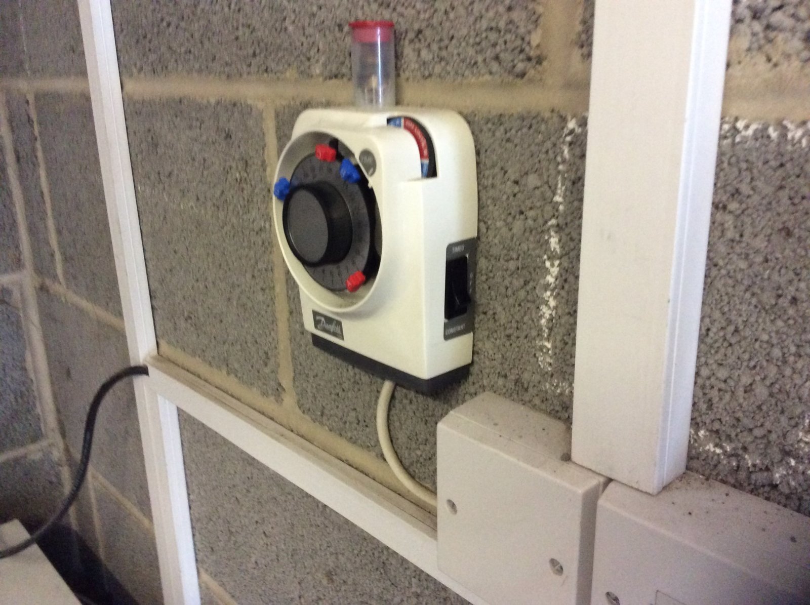

As a combi, it will maintain the heatstore temperature for hot water. What programmer do you have?
Hi Oilhead
It is a Danfoss timer
The question is if I turn off the timer will it switch off the boiler
If I put it on constant is the boiler on ALL the time?
That timer was normally used for solid fuel boilers with gravity H/W
Turn the timer to off and see if it cures the intermittent firing.
Hot water is probably on continuous.
With firebirds I’ve found they run very well with a smaller nozzle in than the manual recommends eg if book says 0.75 you can get away with a 0.65 and that will save you some oil. Bob
A randall 102; if it controls the boiler, then on timed it will not be maintaining the heatstore. A lot dependson how you need hot water, and how the heating is controlled. Do you have a room stat at all?
Hi Oilhead
That's only a single channel programmer, so it's just controlling your heating. Your hot water will almost certainly be hard-wired to be constant. You need to change to a two-channel programmer if you want control of the hot water as well.
