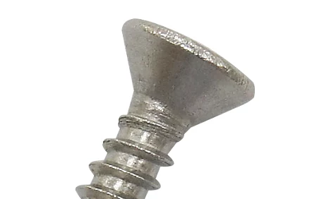

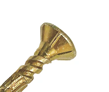

Whats the difference between double countersunk and just countersunk screws, is there any benefit to either? Was looking at screwfix and its like £4 for 200 packs so not sure how to tell if its good quality or not
For example :
edit: also thank you for all your help!
Countersunk have a head which can go flush with the surface.
Double countersunk are the same, but with additional ribs on the underside so they partly cut into the timber as they are screwed in.

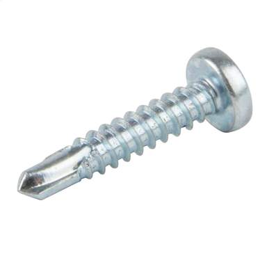

The other common type is pan head, which is designed to fix flat sheet materials with no countersink
