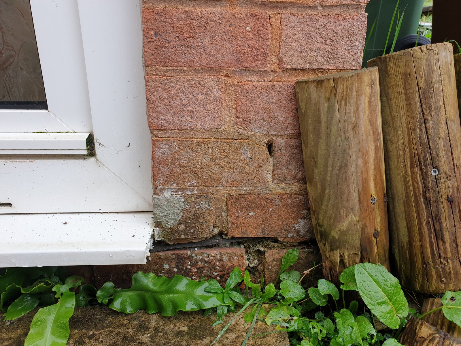

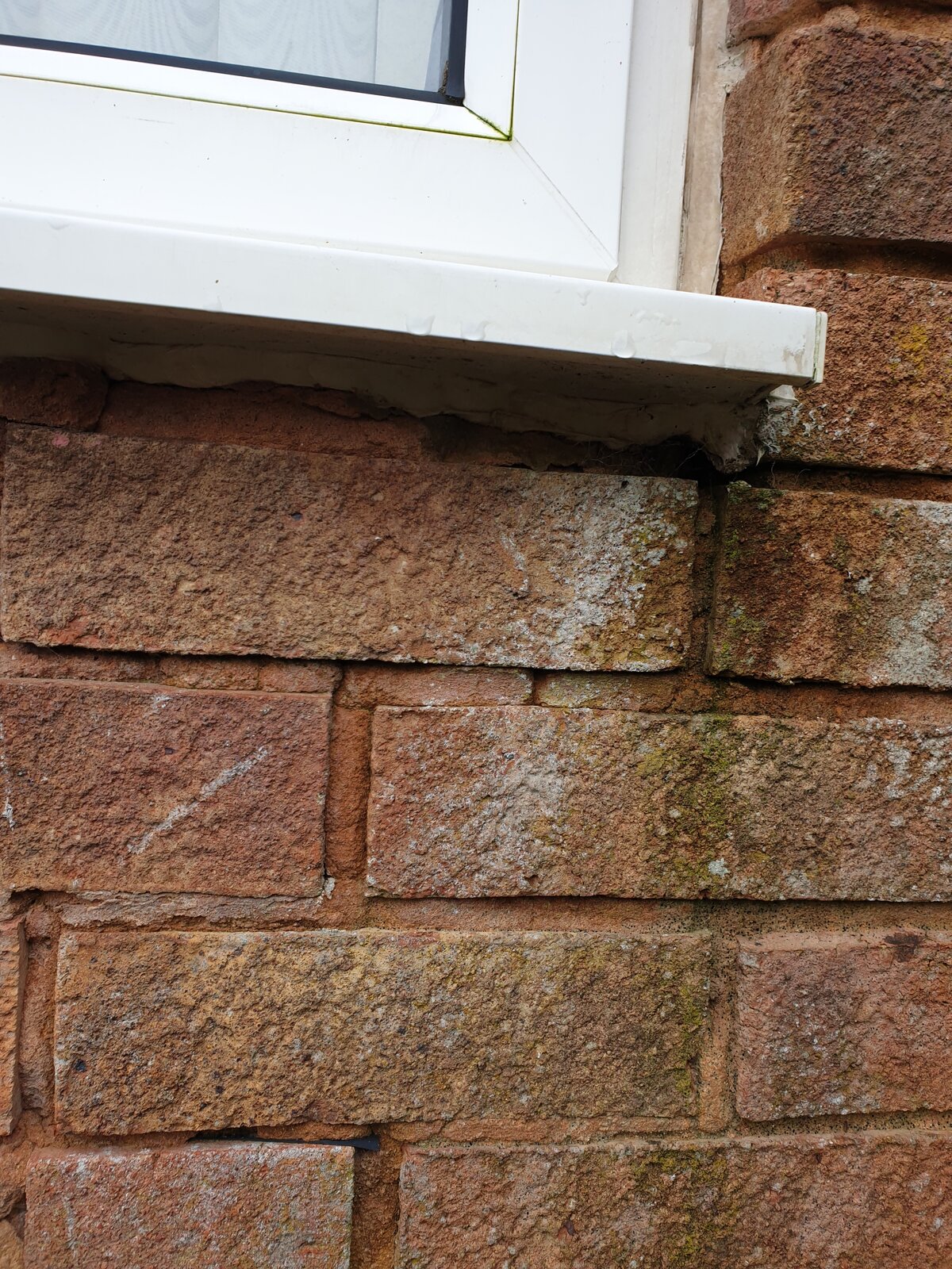

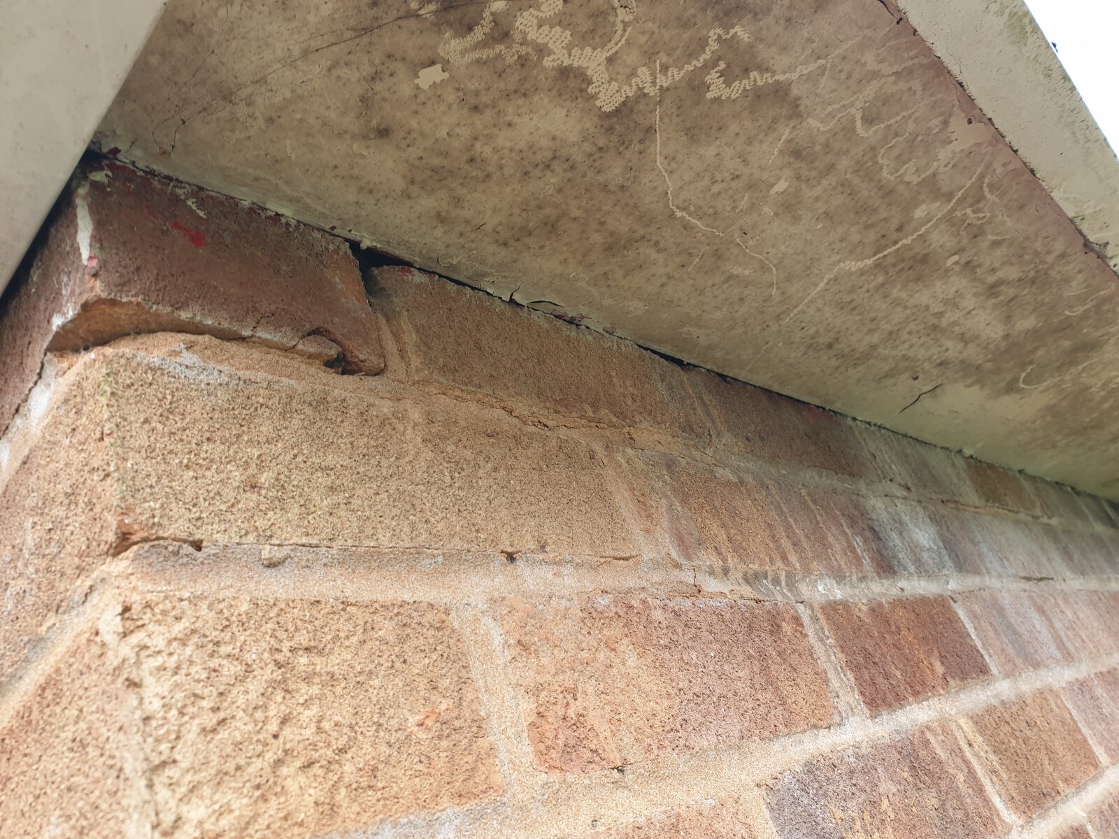

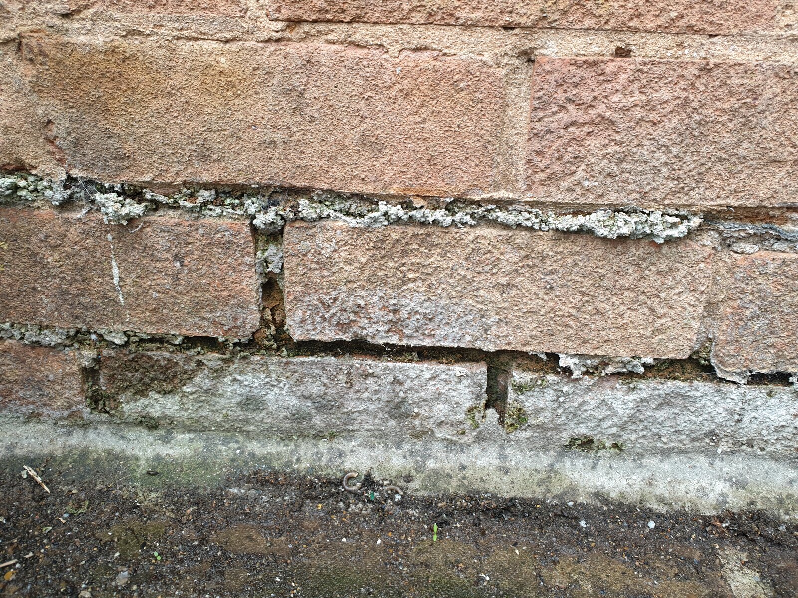

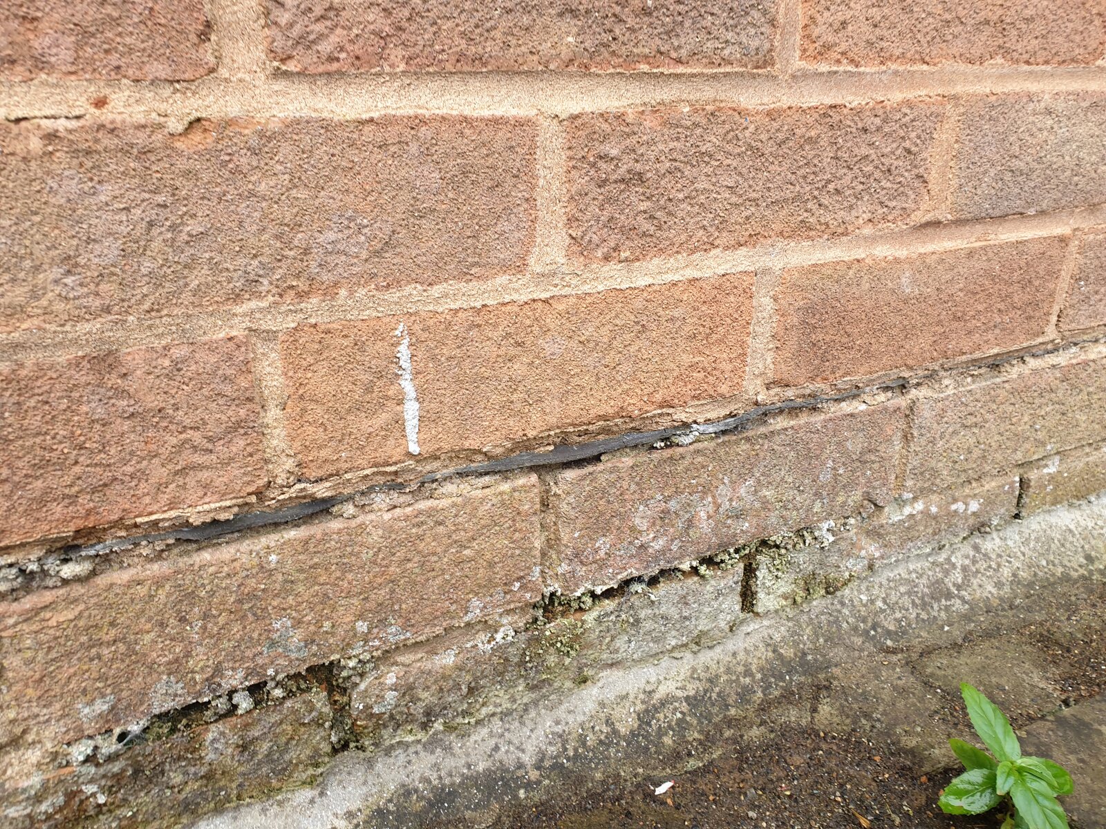

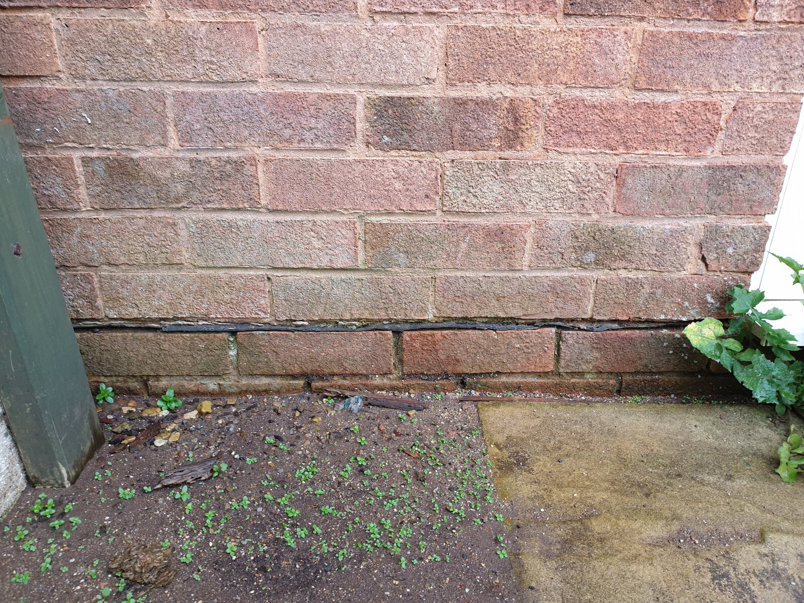

Hi, I'm in the process of buying my first house,
Upon close inspection I have noticed bad brickwork could anyone possibly advise me on the extent of the damage and possible repairs price as im not sure if I'm worrying unnecessary
Thank you for all your help.

Hi Stuart,
In your opinion is this damage to be concerned about or is it just standard cosmetic damage? As worried as its below dpc and could be costly
Thanks h
The image with the window cill shows water getting down the side of the frame or cill and into the bricks. That's a different matter.
Also under the frame the mortar looks broken and soft. Again this allows the wall to become saturated which is detrimental, and should be rectified sooner not later.
I see thank you very much for your reply what do you think around the dpc? Is this a case of just re pointing or can the dpc be damaged
Thanks again
Some DPC materials are degraded by sunlight, so should be kept pointed up.
Once the weathering face of a mortar joint is lost, the mortar erodes relatively quickly and the joint becomes more sandy and porous, and those bricks are not the best for frost resistance anyway. So what you find is that the joints rapidly get worse and the bricks then start to spall, so when you get around to pointing them up the edges are gone, bricks are chipped and the pointing always looks a right mess.
A stitch in time

IMHO There's nothing there to cause a great deal of concern. Maybe point it up when you get round to it, but it isn't going anywhere. If you like the house this is not a reason not to buy it. All houses need a bit of maintenance from time to time, and on a scale of 1-10 on potential nasties that need fixing this is at the very low end 1-2.

The mortar needs pointing and that window needs some silicone mastic around it. Simple jobs. They can be left a while if there are other priorities, but best not left for ever.

Your pictures for instance, are you aware of the high paving level, the reason for that angled fillet against the wall, the reason for those damp bricks at ground level, are those soffits asbestos?
