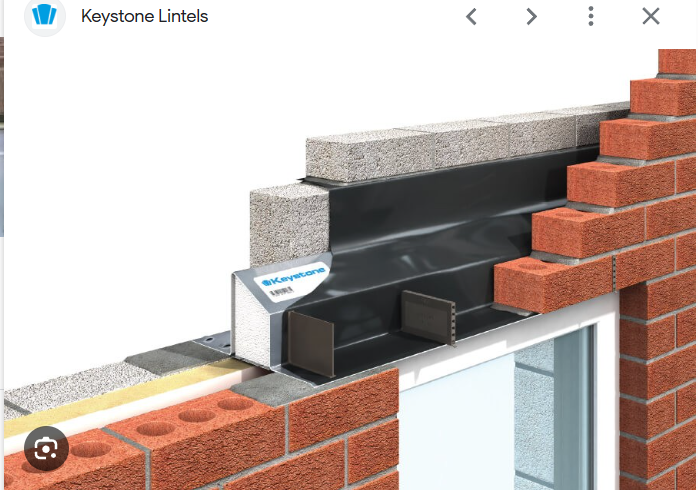

Maybe more importantly you seem to have no weepvents/cavity tray above openings?

Basically above your window opening where your lintels are its good practice to have either a sloping piece of DPM from the internal leaf to the external leaf so if there is any ingress of water it is directed to the external leaf above the window where it then passes through weep holes to the outside, or alternatively the lintel itself incorporates this sloping drainage section. As said, good practice but generally not an issue unless you have water ingress

...otherwise you can get a build-up of condensation sitting on top of the lintel that will make them rust. You could retrofit weep vents, you couldn't really retrofit a DPM without knocking it down.
Weep vents should be fitted as standard, and any builder should know this. But they never used to be fitted, it may or may not have been a major issue. The mortar does have a level of porosity that will allow water out, and lintels are always shaped as shown above to tip the water towards the outer leaf.

Missing weep vents are only really an issue with timber frames and continuous storey trays and not those just above openings.

Plenty of threads on here of problems with no cavity trays fitted above windows/doors Woody, surely standard practice that any brickie would do, i have for the last 40 years (y)

Having no cavity trays is different to having no weep joints.
Yes it is standard practice, but in context of this thread it's not a big drama. It's a "Can you drill out the weep joints. Thanks", not a "OMG, my weep joints, MY WEEP JOINTS!"
