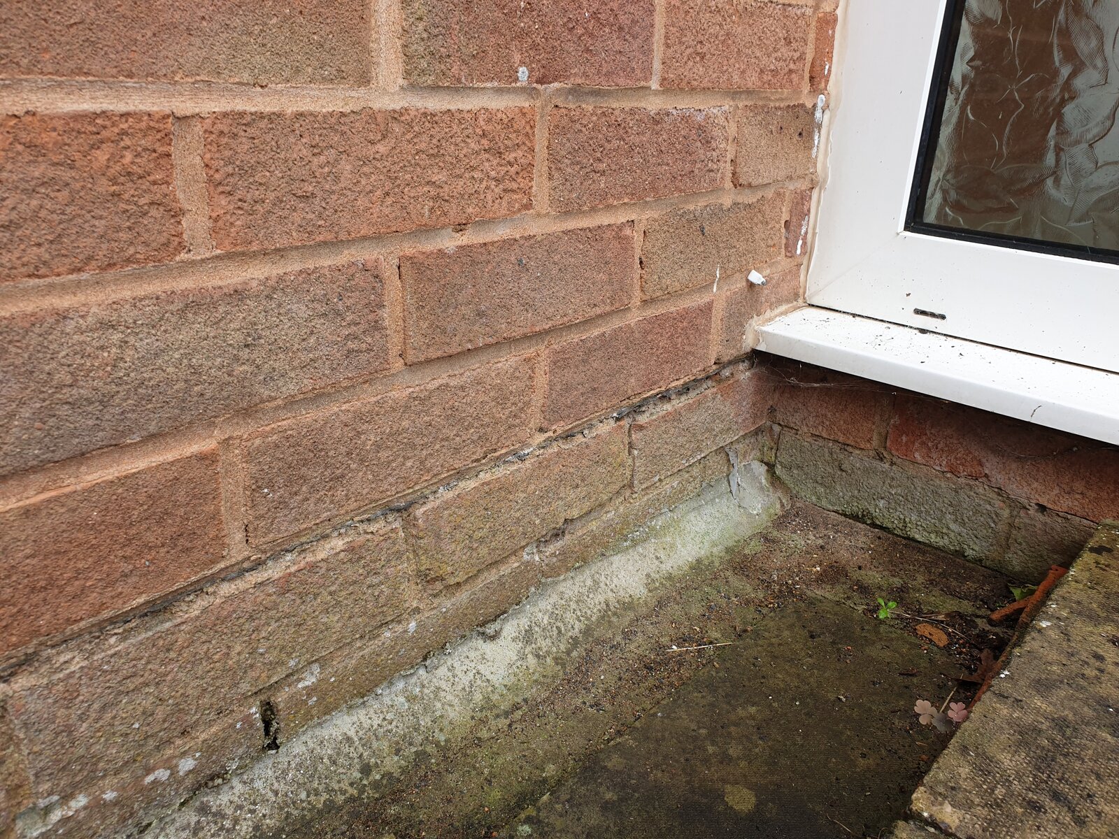

What do you mean by angled fillet?

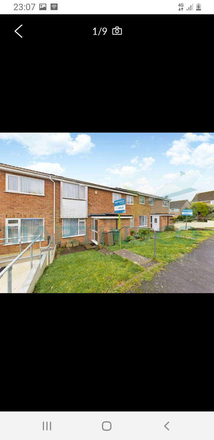

This is the house second in from the left
Ta-dah.
You and a surveyor can both see an angled fillet, but only one of you knows what it is and the reasons why it might be there.
It's the grey cement thing along the bottom of the wall in the first photo.
Ah yeah I see is there a reason for it ill try find a better photo :)

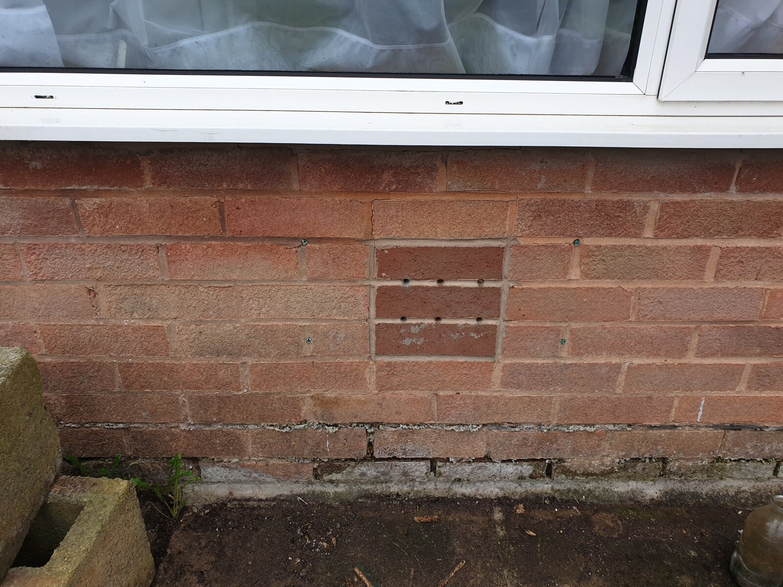

These are the photos I have

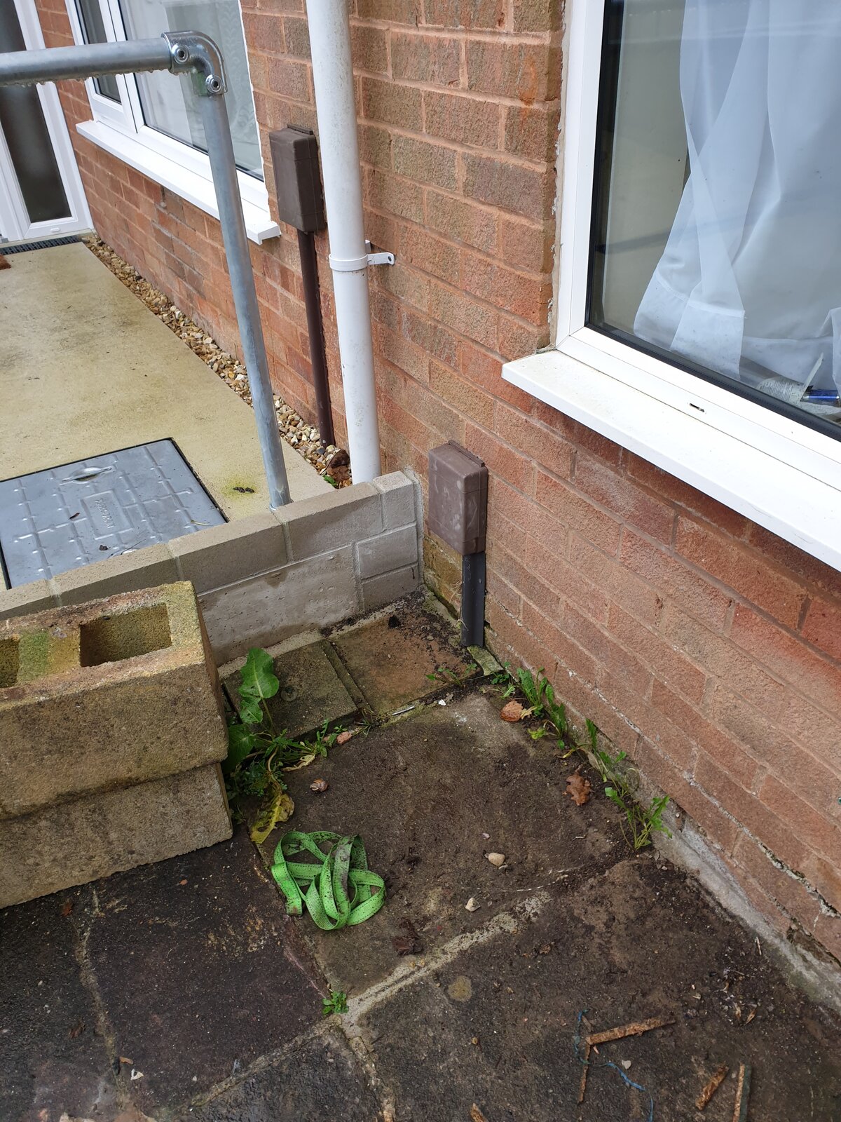

It looks like water is coming down the wall from the soffits (white stains and dirty soffit boards). You probably need eaves protectors fitting and investigate why water is getting onto the roof felt?
Also get rid of those wooden posts that are bridging the DPC
Ah yes I see that its the front porch I think people who fitted it bodged it as they knocked some bricks loose.
Also those wooden posts are being binned as soon as I get the keys :)
