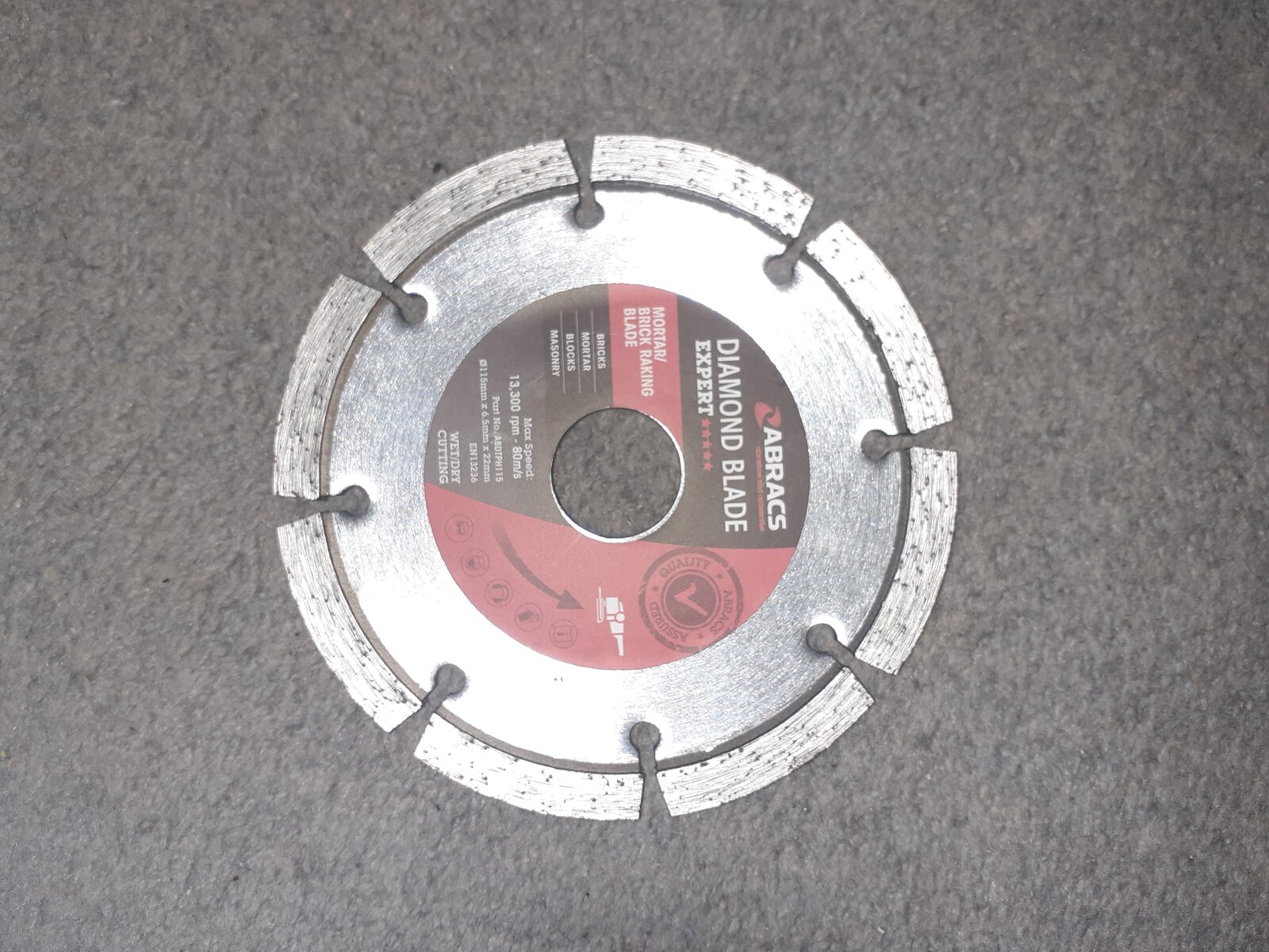

I can only talk about using them on dry materials. In general, on flat materials, they can be used single handed on a cordless angle grinder. Never tried them on green wood, but given thst they are in effect very coarse sanding discs, with the same sort if slotting you see on many masonry grinding and cutting discs, e.g:
I have to ask, what's the difference?

There have been times that I have considered cutting helifix bars to length using my (twin blade) wall chaser after cutting the chase, but in the end I have opted to use the single diamond blade on my angle grinder. I only have two eyes, one head, etc.
I suspect that you are asking why cutting green wood would be any different to cutting dry wood?

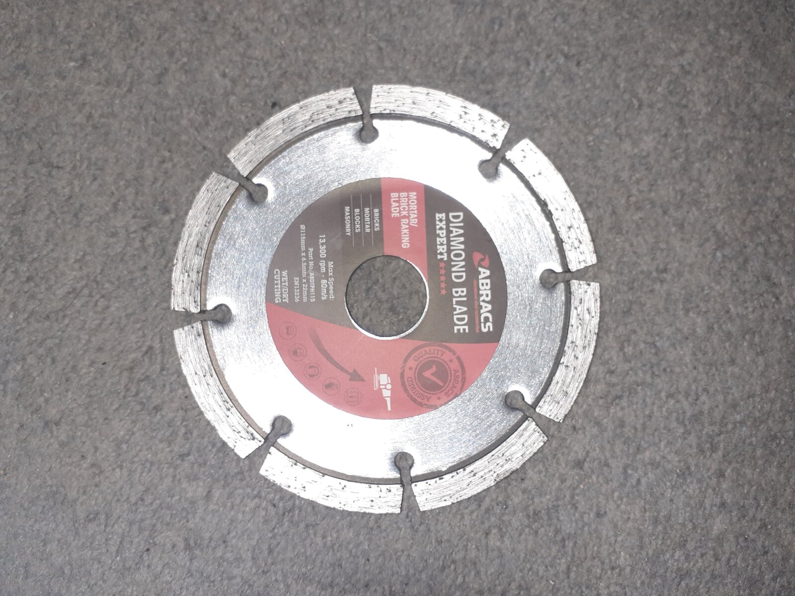

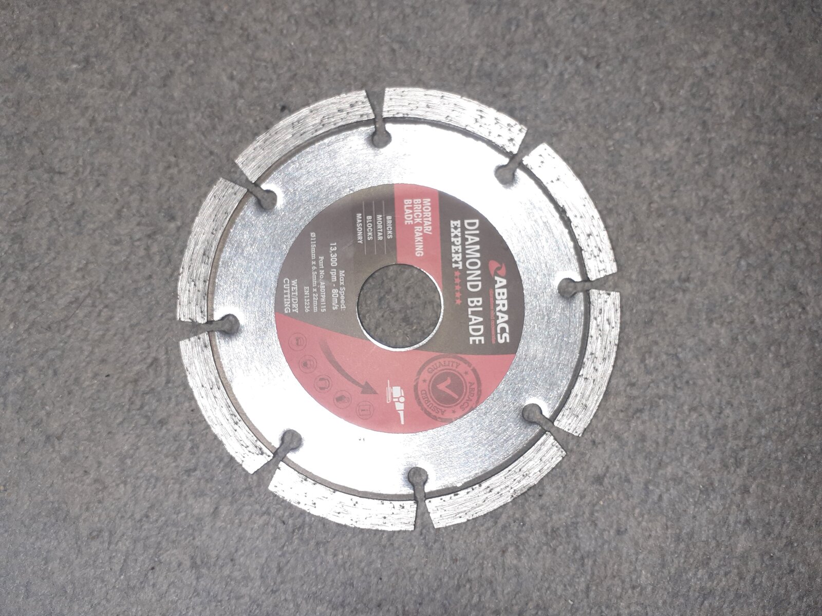

No. What I was asking is why a segmented cutting disc, such as one used to rake joints (as in the photo I posted), should be considered safe whilst the segmented abrasive cutting disc the OP asked about would be considered dangerous
I wasn't suggesting that either is any more dangerous than the other. The dangerous (and illegal) ones are the one circular saw blades that fit angle grinders.
