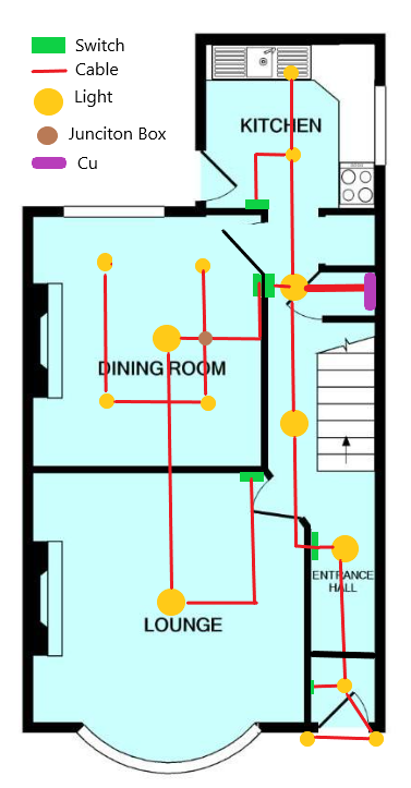

Hi all,
So I've just had an offer accepted on a dream home but its basically a shell and needs wiring, CU etc etc I'm currently an engineer but I will be retraining to become a domestic electrician in December so I thought why not get some practice in first. when it comes to the actual wiring I will probably be getting someone in and then just observing and learning with them if they are happy for me too. all the flooring will be up and unoccupied so id like to run as many cables as i can then get it checked as it will all be visible.
So my question, I've done a real rough sketch of what I believe would work but need some opinions and any mistakes I've made such as wiring route or switch positions etc etc.
Any critique welcome.

In my opinion the door hangs are OK but you don't want the dining room light switch behind the door.
Since it's a complete rewire the lighting junction box would be best located adjacent to the CU; yes, it increases lighting cable requirement, but it makes future servicing and rework a great deal simpler and doesn't involve buried MF boxes hidden in ceilings or under floors

I've only done a junction box so that the centre kitchen light is tied in with the spot lights? surely there is a better way other than taking the wiring all the way back just to join up together?
if that's all wiring wise them I'm impressed with myself haha
Doors are currently arranged in the Victorian style, where it was considered rude to be able to see into the room as the door opened.
Also ensures the door can be as obstructional as possible when entering the room and for the location of furniture.
As for the wiring -
junction boxes are not desirable or necessary
you need to decide if the supply will be looped at the switches or at the light fittings
do you really want that few lights in a 'dream home'?
what about all of the other circuits?

I'm not sure, I'd presume as I've got very easy access to the celling that looped at the lights would be easier or am I wrong?

Centre lights are fine for general room illumination, but worth considering task lighting too. Will you be happy with just the centre light on, for watching TV? I find wall lights better, dimmable ones. No bedroom on the diagram, but we use bedside lights, rather than the centre light.

I haven't done a diagram for the rest of it yet but I will eventually do a diagram for lighting, network and power. I know where the sockets are going but presumed as they will be completely separate circuits It won't really effect one another?

It appears from your diagram that the dining and living rooms are connected to the consumer unit only via the light switch in the hall. I assume that's an oversight? In any case I'd have assumed you'd basically just replicate the existing lighting circuit unless it's totally irrational(?)

While others may have "picked some holes" in your plan, I think that both you and your partner may find the "Kitchen Lighting" which you have proposed to be quite inadequate.
While you may intend to install "under cupboard" lighting and a "range hood" with lighting, individually switched ceiling lighting for the preparation bench space, cooking area and "sink" would be preferable to just one general central light (plus, a "light over the sink".)
Hence, I consider that you (and your partner) may appreciate more "specific" lighting in the kitchen area.
If that is not possible, make sure that the "Central" kitchen light is a large "Panel LED", since you cannot possibly consider a single "down-light" in a kitchen.
Also, you have made no mention of socket-outlets (?)
