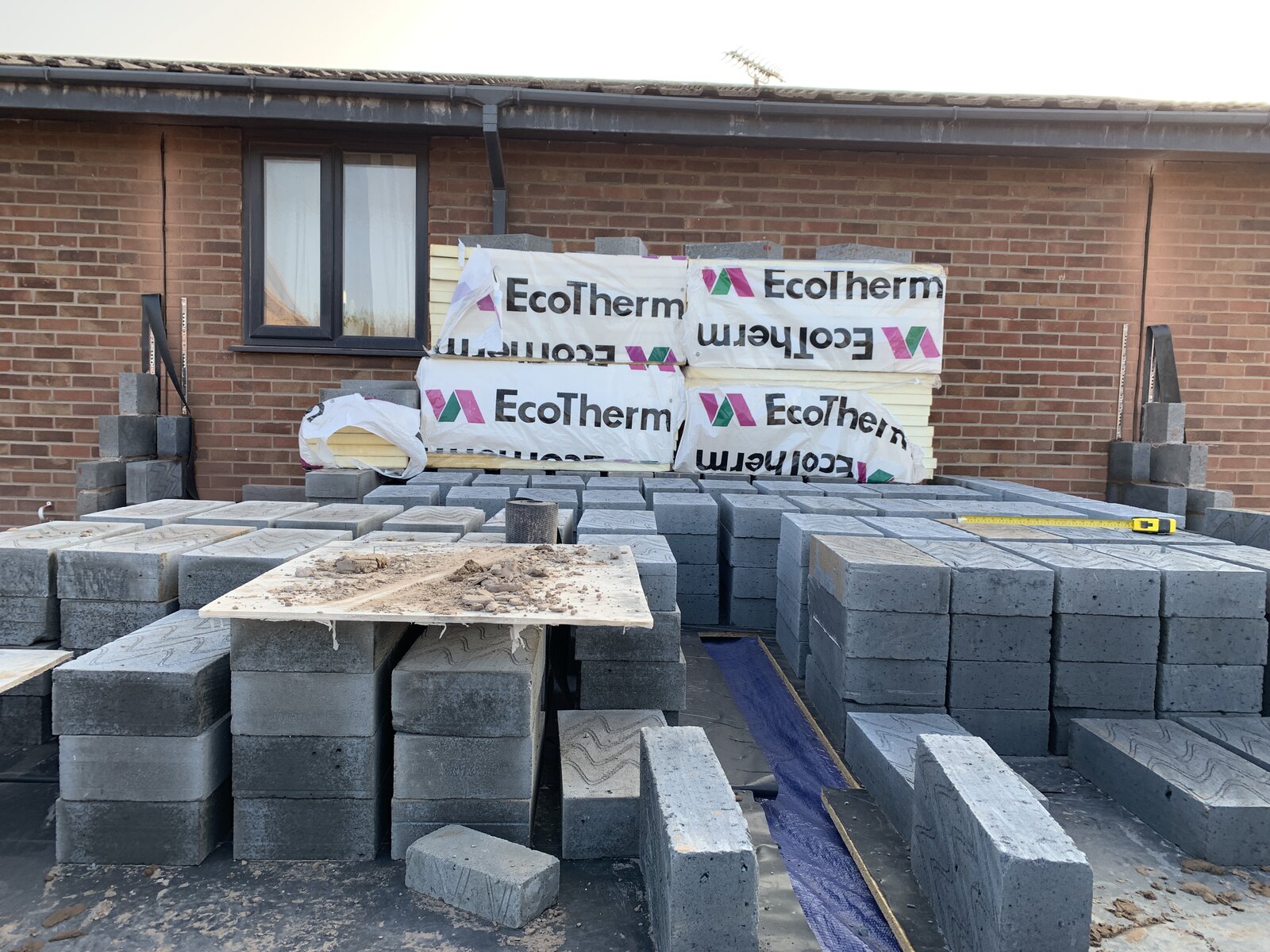

Hi all,
Ive got to the point where I can no longer build from my scaffold tower so need to get the proper scaffolders in.
I've never ordered scaffolding before, so I would rather look stupid on this forum and find out the stuff I need to know/ask before actually speaking to the scaffold companies... so I can sound like I know what I'm talking about to them!
I don't even know if scaffolders come out to price a job, or whether I just need to tell them what I need and they'll work it out over the phone??
Here's where I'm at/what I need:
I'm currently a third of the way up on the first floor with my blocks, so will need a first stage scaffold to roughly that height (3m) then a second 'lift' when I get up to near roof height in order to finish the walls and do the roof. This is the orange bit on my diagram.
Once that's completed, I'm going to need a scaffold around the whole property in order to re-roof the lot and render the whole house. So I assume I'll need at least 2 levels to that scaffold to allow that work to be done. All marked in blue on the diagram, with a bit in green where bridging over a conservatory is needed.
Any advice welcome on key info I'm missing that scaffolders will need to know. Thanks
