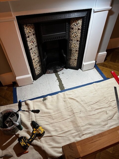

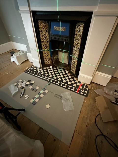

I've received the tiles now and made a rough layout. I am not intending to use the warm-up board, I just want to use it to make a perfect cutout for the flooring guy to work around. The Warmupboard is 1250mm wide, but all the hardibackers (or any cement board) are only 1200mm. I've indicated the red line, where approximately 1200mm is. So I need to use two boards and there will be a weak spot where the two boards join together. What would you recommend where this weak point should be?
1. Keep it at the outside that 95% rests on once piece and that little bit on the right is on a second small piece, risking a weak edge
2. Make two symmetric pieces and have the cut/transtion smack down the middle?
Other question, if I have space, any harm adding a schluter decoupling matt? There seems to be more and more preference to use decoupling instead of hardibacker. Or will it make things worse?
Get a Hardibacker, split it in half lengthways turn them round 90deg, then cut both to the right width. The join just simply has to run down the centre so that both sides are the same. Much more stronger than a small ' piecemeal' edge join, and more professional. It'll have next to no foot traffic on it, so no need to put any hardi-scrim tape over it, just fill it with the rapidset when you're tiling and scrape it flat with the roadside of your trowel

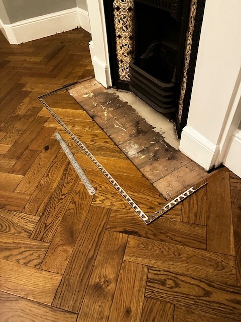

The floor has been laid and looks fantastic. As agreed with the flooring installer, they left the to-be-tiled area untouched and left a clean line.
The metal trim is measured, cut, bent and ready and I have everything ready besides the hardibacker, which brings me to my next question:

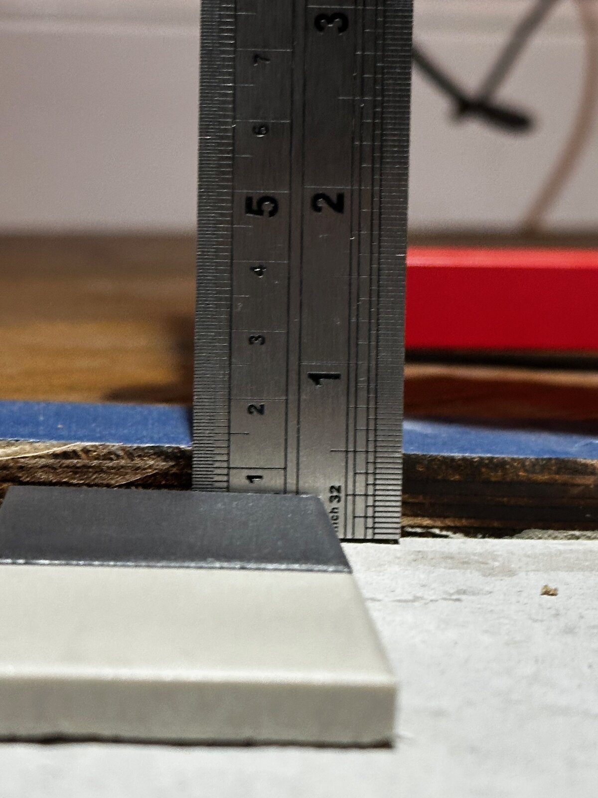

The total hight difference between the floorboards and the new hardwood flooring is between 21mm and 22mm. The Victorian checker tiles are 7mm thick. How do I go about filling the area?
Option 1
3mm adhesive +
6mm hardibacker = 9mm (although screwed down the adhesive might compress and I will only get 7.5-8mm) +
3mm adhesive + 7mm tiles = 18-19mm
In this scenario I would probably need to be generous with adhesive to get it level to the 21mm
Option 2
1.5-2mm adhesive +
12mm hardibacker = 15mm (although screwed down the adhesive might compress and I will only get 13.5-14mm) +
1.5-2mm adhesive + 7mm tiles = 22-23mm
In this scenario I would need to be quite scarce with adhesive and it still might be proud 1mm or so
Any thoughts/advice anyone?

A 6mm notch Trowel under a 6mm Hardie will give you 10mm once it's screwed down. A 7mm thick mosaic with a 4mm notch Trowel will give you 9 to 10 mm when lightly ' grout float pressed' into place. That's a total of 19 to 20 mm. Any extra height you want over this, has to go under the Hardie. Ie 8 mm notch instead of 6. Yes, you do need screws , a. To hold them in place and stop them moving until the adhesive sets, and b. To allow you a little adjusting on the boards height before it sets when you put your straight edge across them and discover its not as flat as you think !
Don't forget your Metal Edge size ( I'm assuming you've bought 8 or 10 mm) in your setting heights, as you don't want a big metal lip sticking up all the way around.

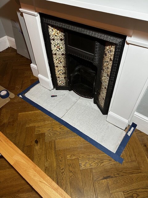

Ok, google tells me it is fine to use either side. Both pieces now cut to size, unfortunately during cutting/snapping small bits broke off on the lower left and top right... I think I will just live with it and just place the loose pieces in into the adhesive...
I bought mapei keraflex maxi S1 (non-fast setting, to allow more time for corrections)... once I fix the cement board, how long to I need to wait until I can do the tiling? Technical data says 24h for floors until grouting and 24h for foot traffic, but neither is applicable. If I leave 5-6 hours in between could I in theory do both on one day? Or safer to wait 24h to let it fully set?
Either side of the Hardi is good - they’re both the same. You can tile onto it even in your case where you’ve used ‘slow set’ to stick it, as long as you’ve used the screws as described earlier. The one thing you cant do is grout earlier - it’s not worth the risk. Tile it, and as a rookie trust me, you’ll appreciate the extra time to clear out all those grout lines !
