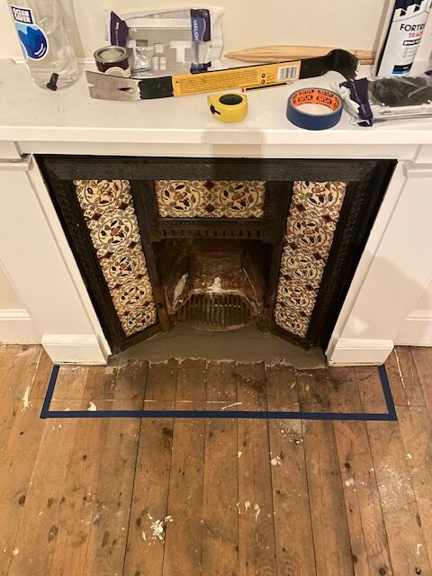

I've roughly sketched out the area to be tiled and the plan is to continue all the way into the fireplace:

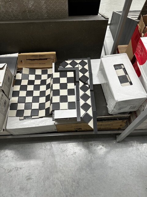

I've already ordered below tiles for this:

What sort of tile underlay/substrate should I use? I believe the base will be just as you see on the picture. i.e. the tiled area will be partially on floorboards and inside the fireplace. I still have some spare 6mm warmup insulation boards, can I use these or is it better to use this flexible polypropylene matting?
Is it recommended to use tile spacers for such a job? These mosaic tiles come prefixed into a mesh in smaller sections, but of course I still need manually adjust for the pieces to go together.
I think the flooring guy will put strip pieces of wood around the planned tiled area. How should I fill the gap where the tile ends and the wood section begins? Will regular tile grout stick to the wood?
Tiles can’t be laid directly to floor boards, need a 6mm hardibacker or similar to prevent movement .
If tiles meet any other flooring flush it need a metal trim to avoid breaking tile edges when walked on .Need a machine tile cutter or a grinder with tile blade to cut .
Better to adjust dimensions to suite tile dimensions to avoid cuts if possible .
The challenge you have is that the tiles will be solid and the flooring will flex a little, so grout is always going to break up. You need something that is durable enough to cope with the difference in flexibility. Quickstep laminate has a special colour-matched profile in their range ideal for this. You fix a plastic channel section between the floorings and then tap a self-locking height adjusting T profile in to it to cover the gaps. https://www.quick-step.co.uk/en-gb/laminate/accessories/laminate-profiles https://www.quick-step.co.uk/-/media/imported assets/flooring/a/0/d/qstdsaccqswincpincizoprofileenpdf47950.ashx?rev=8920f2165ed34efab4510ac9c0690dc5&type=original&filename=Technical+Information.pdf
You would need to arrange to have the flooring and the tile surface level, so if your flooring is e.g. 8mm laminate + 3 mm underlay, you have 11mm to play with. I wouldn't normally tile on to ply, but a 3mm ply + a little adhesive + those mosaics should be about the same height. Cut the ply to the tile area, fix the plastic channel around. get the flooring man to stop close to the channel, once all done mitre the cap strip and carefully tap in to the channels. Use a wood block and tap evenly to avoid breakage.
The mitres will be vulnerable, so if you intend to walk on them, then perhaps use either the incizo metal profiles, or any thin metal cap strip. The beauty of the incizo profile is there are no visible screws and it fixes securely along the whole length into the locating channel
The thing with mosaics is you don't want too deep cement, because if it's a thick bed as you push one down, it squidges up the others and up between the joints and is a PITA to get flat - use the thinnest adhesive layer that is practical.

Understood, the end result should look something like this. It does not look like there is a metal trim but they might have a heath stone supporting the entire area. A metal trim (L-Shaped) would then go inwards for the tiles to sit "inside"? If I can't find any, could I also get away with a flexible wood filler? This will not be a heavy walked over area.

No way with manual cutter? I don't think I will want to spend the money for this one time job. The idea is to adjust the area, so I can exactly fit the edge/surround and two-three rows of checkerboard tiles. Everything then will be adjusted inside, where I will need to do a few (diagonal) cuts. The fireplace also has a grate in front (removed for the picture) so a lot of the uneven areas meeting the tiles will not be visible.
So the flooring will be engineered hardwood, glued down piece by piece in herringbone. Just checked the sample piece, the wood is about 14mm and then with 4-6mm plywood underneath. So there is a full 20mm in theory to play with. I could either ask them to build around the area and leave it as is (then I have full 20mm), OR they just put the ply down (perhaps even tell them to lay the ply that one full sheet covers the entire area) so then I would have 14-15mm to build up. 6mm ply + 6mm insulation board, tiles are 6mm, leaving ~2mm for adhesive. Would this work? I prefer not to use a trim profile, but just one next to the other similar to that pinterest link above.
This sounds like crucial advice. Thanks. So if I have the space, would it make sense to "build up" with self leveller, let it fully set and then I should have a hard thin surface for the top tile layer?
If the wood is that thick it isn't going to flex, so yes, you will be able to do it without a trim. Yes, build up the level under the mosaics to whatever is the correct height for a thin adhesive bed. I'd use cement board if you have any.
