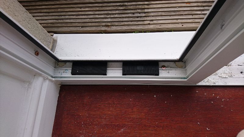

Two more questions, if two dark/grey pads (like on the photo 1 here in the old frame) are removed from one side of the side window panel (which is not ever going to be opened, like on the photo 2) to the balcony doors is it ok or not? And if the level looks like on photo 3 in one place is it ok? Should the level be used when fitting windows?

The grey bits you refer to are packers, used to ensure glass is correctly installed. How do you even know if they are/aren't installed in the side panel? Once glass in and beading on, you can't see them?

The packers are used to ensure the double glazed unit is correctly seated in the frame and they're a critical part of the toe & heel process, although that won't be as relevant to a non moving side panel.
I'm only a diy'er so others more experienced on here might correct me, however when it comes to packers in such a panel, I think the main priority is to ensure there are packers used on the bottom to mitigate the risk of the glazed unit sitting in water that might collect in the bottom of the frame. Side and top packers might be less important in a side panel assuming the glazed unit is completely secure with no movement.

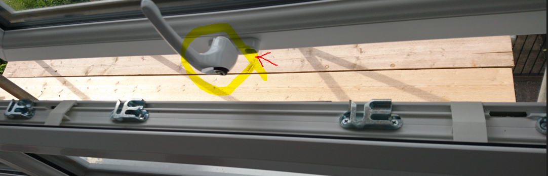

OK, As I have mentioned earlier the locks in the windows were getting stiff while opening them and closing them (the part which is getting stiffed is circled in yellow – it is the whole mechanism in this lock). During the first inspection the man from the company which installed the windows, sprayed them with some special spray (he sprayed those locks plus also underneath – I think - somehow “inside the lock” as the red arrow is pointing) which should help and it did for a couple of weeks. Now those locks are getting stiff again, it is getting really hard to open them. I do not think it is normal. If he comes again to spray again I do not think it will hep in a long term… And advice on this please?

Regarding the handles that are difficult to operate, are they still difficult to operate when the window is open? If yes, that indicates the window mechanism needs adjusting and/or is faulty. Not much you can do about that until they're looked at once more by the company and/or replaced. If the handles are only difficult to operate when the window is in the closed position, that indicates the locking pins might need adjusted. The locking pins are the 'lugs' on the underside of the opener that locate into the metal pieces on the frame, those are called espags.

Thank you very helpful. When the windows are open two handles work smoothly, the 3rd handle works ok plus makes a noise when I lift it (move it from horizontal position = when it aligned with the frame to the portrait one - the position which is on the photo in my earlier post today) - I hope you know what I mean. Not sure if they checked it, definitely did not compare how the locks work when the window was opened and when the window was closed during the 1st inspection. The man just sprayed the locks with some special spray...

This indicates the mechanism is probably fine and it's the locking pins/cams that need adjusting. You can normally have a go at this yourself, refer to the previous link. Sometimes they're adjusted by pulling out and turning, sometimes you need an allen key. The circumference of the pin/cam isn't a perfect circle, it's offset slightly. Turning them one way will create a tighter seal when closing the window (handle more difficult to operate) and turning them the other way will create a slacker seal (handle easier to operate.)
You want to find a happy medium between ensuring the window is closing/sealing properly and the handle not being too difficult to operate.
Re the noise coming from the other mechanism, it's difficult to comment on that over a forum as you'll appreciate. Small clicks and creaks from mechanisms don't always mean there's a problem. However if the noise sounds wrong e.g. grating and if you feel resistance when moving the handle, then it needs checked out.

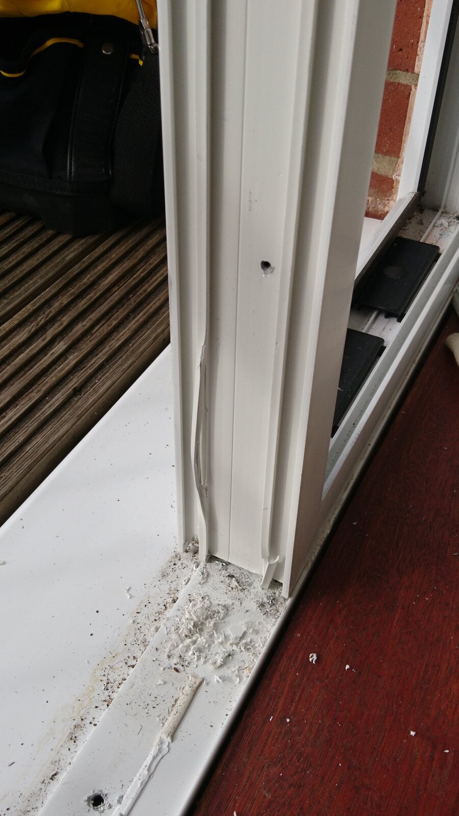

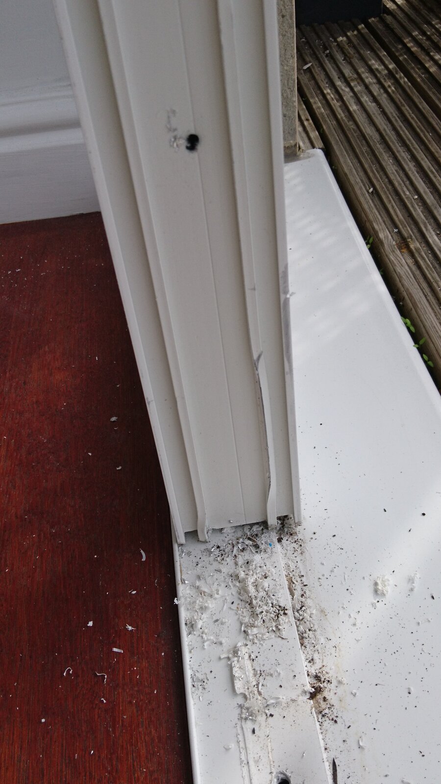

Unfortunately, this story is still going on… the fitters received the new doors (to replace the other “new” doors which had so many faults and were installed several weeks earlier), we set up a date and they came to fit them. On the day they removed the old ones. While doing so they damaged the side panels – photos attached. Next, they took the old doors away. After some time, they came back with the info that the new doors they had in the car were damaged and could not use it – as they said there was some plastic wrap and now when they removed it, it appeared the new doors were not good to be fitted. They brought the old ones back and installed them again on the damaged panels. They said they would order the new doors. I can not understand… The previous windows, doors were also damaged, at that time they also said “this is how we got it”… How come they did not check those ones properly at once when they received them? Plus when they removed the glass from side windows, in one frame, at the bottom, there were brown stains in the corners– photo attached – as if the rain water was coming through (it was not raining properly yet otherwise I think the stains might have been bigger?). I asked them if it means that the seal was not working properly? Still have not receive any answer… I do not know how long they will have to wait for the new windows (originally, 2 months back, they said 2 weeks and it stretched to over 2 months, now we have to wait again). Anyway I told them if they have them within the next couple of weeks that is ok, later, when it gets cold I will not let them in as having all windows removed for a couple of hours will freeze the house and I do not want to bear extra electricity cost for this, it has already caused me so much stress, plus not sure how dump, colder weather might affect the installation, seals drying up etc?
