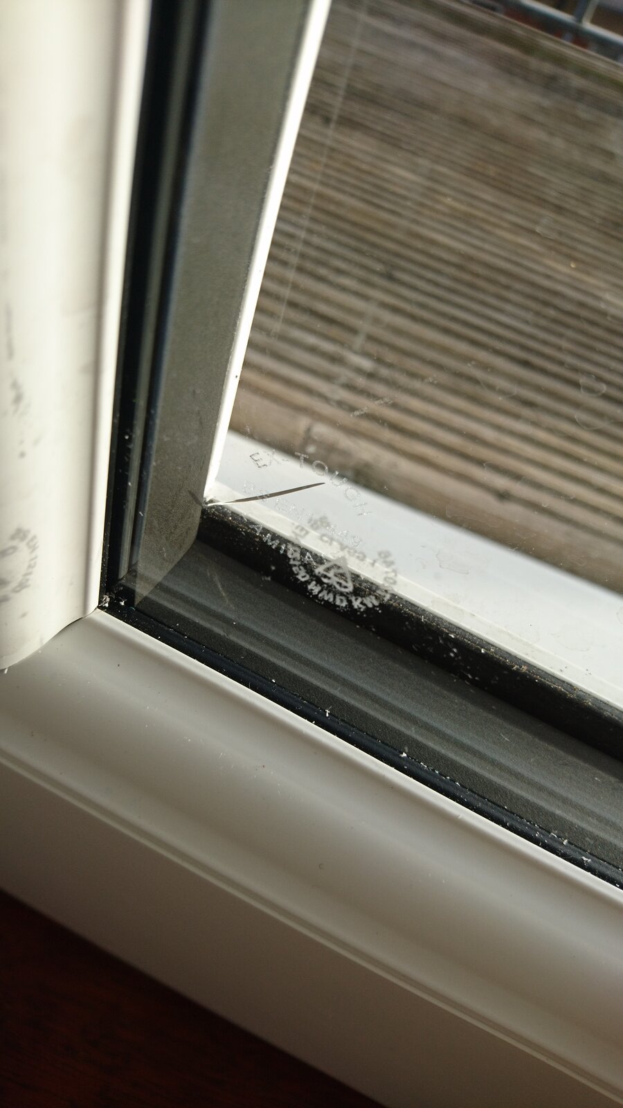

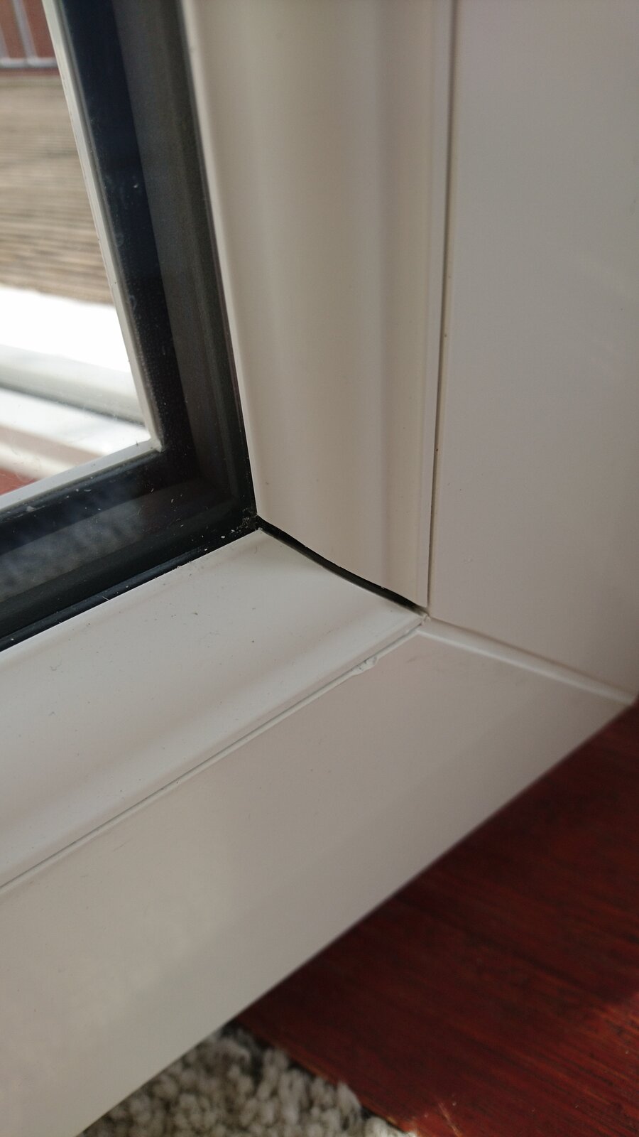

The fitters came and fix the new doors on Tuesday, it seems almost ok. Two questions: 1st: there are "breaks"/space/cracks in between the white thing ( I will call it tape) around the glass in the corners, in a couple of places (as per the photo number 1), this is only on the inside (= so inside the house). The outside corners have been sealed. Are those "breaks" ok on the inside part of the window, or should they be sealed as well or can they be left like this? The 2nd: only today I have notices a scratch on the glass, it is very small - about 2.5cm, this is double glazed window so it is on the outer glass, but somehow inside, so you can not feel it, you can only see it. Is it ok?

Picture one, the glazing bead has either been cut too short at the factory(not the fitters fault) OR entirely possible they got the left and right hand beads mixed up, they aren't always the same length, just a case of getting them to pop them out and swap over, if that wasn't the case then a new bead is required. Picture 2, the outer pane is cracked and the whole double glazed unit now needs replacing, what sticks out to me is the kite mark in the corner of the glass says its toughened, well the outer pane certainly isn't as it wouldn't crack like that, it would shatter. The only reason I can think of for mixing float glass(the outer pane) and toughened(pressumeably the inner one seeing as it says toughened) is that the floor level inside the room is within 800mm of the glass but the outer is more hence doesn't require toughened glass outside.

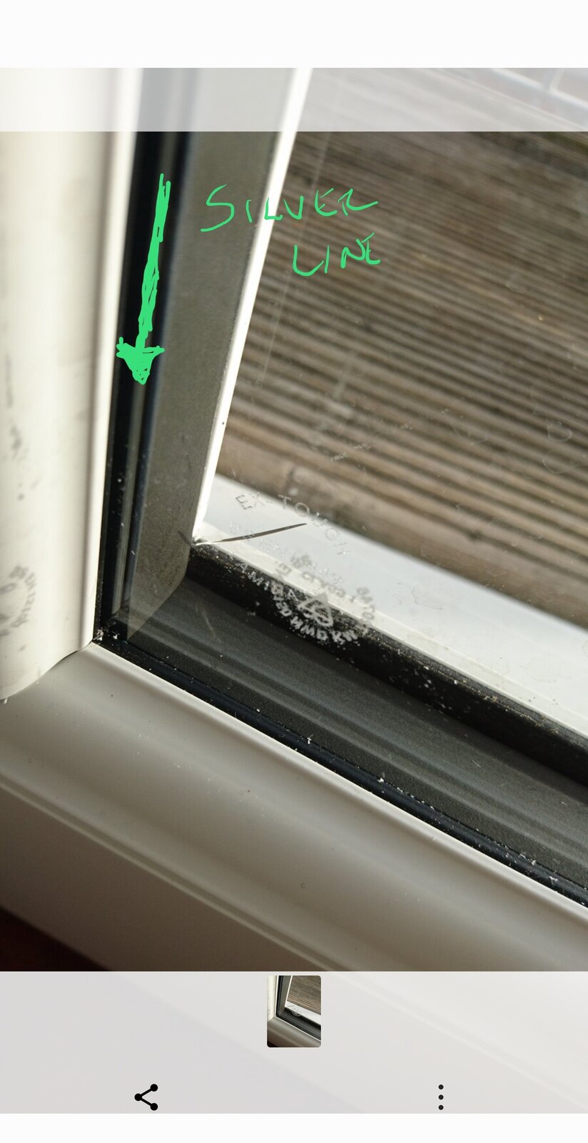

Also the glass unit has been fitted to far to the right as you can see the edge of the spacer bar, in this case a supa spacer, you can see the silver line, that should be hidden

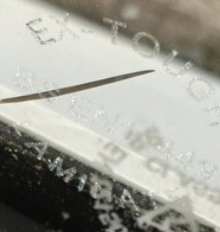

Definetly a cracked unit in picture 2 , but I'd say that was a laminate pane , and the the other is the Toughened pane. You can just make out the laminate kite mark. My guess would be it falls under Doc Q building regs , no other reason really to use laminate glass ( unless requested )
Yup! "Laminated" "BS EN 14449"
It was a little confusing, as the shadow from the crack extends across the spacer, making it appear as if the crack was on the inner pane! :)

5. In terms of the spaces between the beads, the same person said that "....it is just visual inconvenience and if the window company won't fix it I can fill with white silicone, if I want...." What do you think of this?
6. In relation to "....Also the glass unit has been fitted to far to the right as you can see the edge of the spacer bar, in this case a supa spacer, you can see the silver line, that should be hidden.." I checked on the internet, the super spacer is between the panes (as I understand it) so it is wide (photo attached), where is the silver line you have mentioned? Could you please perhaps, on the photo I attached earlier, where you can see this silver line (please note those are 2 photos from two different windows) - zoom in, point this silver line with an arrow (or somehow mark it) and post on this forum, so I can see where it is please? Thank you all again for your help.

1 / not 100 % sure looking at the picture but technically the laminate should be on the outside face for security reasons
2/ laminate is two panes of glass with an interlayer keeping them together , added security. It will be the ' inner ' layer of glass that is cracked so you can't feel it

4/ if it had been a scratch / mark / imperfection then if not visible stood 3mtrs away looking through the glass not at the glass and not in direct sunlight it would be deemed acceptable. This is broken so not covered by the 3mtr rule
5/ ideally those beads should be the right length, filling with silicone is not really correct, you are within your rights to have them replaced
6/ spacer bar should be fully behind the beading, so that the front face is at least flush with the black gasket, the silver line I have highlighted in the attached picture
