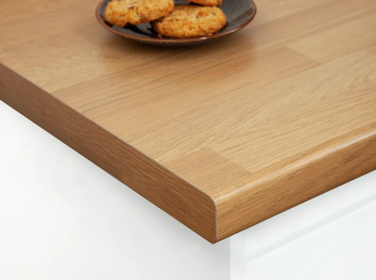

There are I'd say three common worktop profiles
One has a small radius top and bottom, with a slightly convex middle - your joint would be in mid-air and the front isn't always flat like this one
WHere it's convex, your front strip would be horrible to fit.
Many have a larger radius on the top edge, and either
1) go to a 90° bottom edge
or
2) carry the curve on so it goes backwards a little
With 1) you'd have a large gap under the joint, with
2) you have a large gap under the joint, AND a retreating surface to glue your front strip to, leaving a dangerous joint a the top which would be less that 90, and impossible to make neatly.

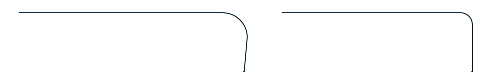

Having thought more I would still use two different preformed profiles, plus flat material.
One with a small radius at the top , and going straight down, which would suit the one pictured.
the other a much larger radius, because many worktops have a much larger top edge radius than the one shown. If it could be turned back slightly that would fit MY laminate worktops, and many others.
Like these
The first would fit most cases, the second could be cut to go over square edged small upstands, (turned to be vertical) where the hollow top wouldn't matter
The first would avoid leaving a sharp 90 in place of the rounded bottom edge in the picture shown earlier.
