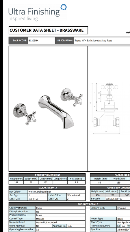

    Not seen that claim, but the spec sheet from this particular tap very definitely says China...it also says it's not WRAS approved, so it shouldn't be used on a mains water supply or fitted in a house with an unvented cylinder or combi boiler

  8. Depends on how you are doing the plumbing up to that sprout.many ways of doing it.
    Can get extensions like this one, https://www.amazon.co.uk/CORNAT-TEC382501-Chrome-Brass-Extension/dp/B000VT9HEK (not advertising and other supply firms are available)
    yes they are imports from China,dont be fooled by the product name.
    Fitted some of their Hudson Reed designer rads (not my choice) and they have been excellent.
    Personally i would buy steel items from this country rather than china if possible.

    Use rad extensions to get the reach into the wall.
