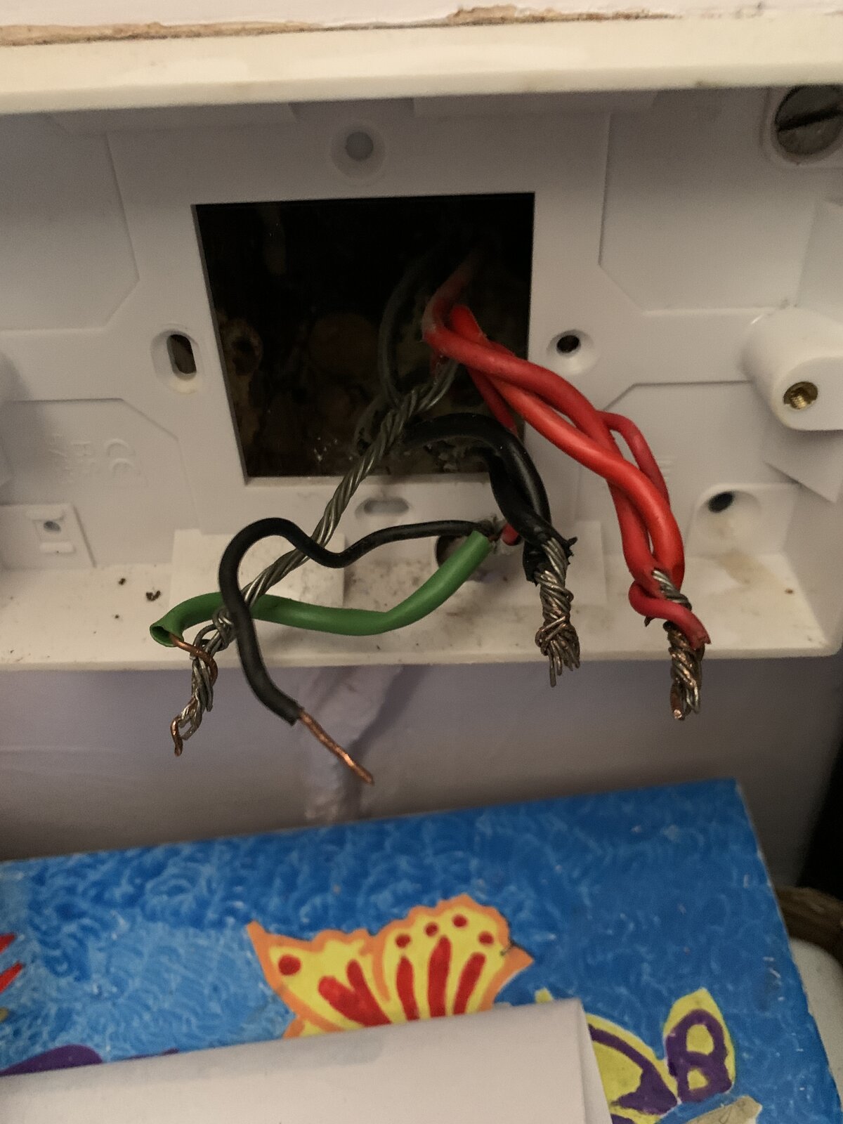

When I took the old socket off, I found the ring main is running on a braided (if that is the correct terminology) twin & earth, plus there is a spur on a single core running off to another outlet - please see the photo. The trouble is, the wiring is too thick for the terminal holes on the new socket.

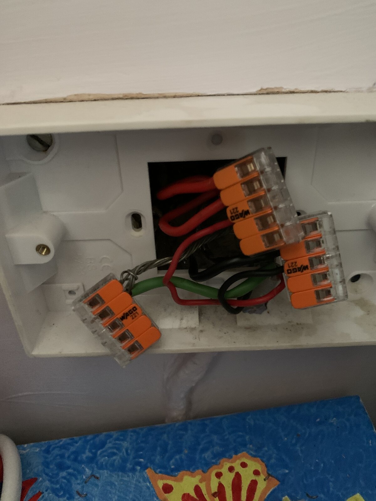

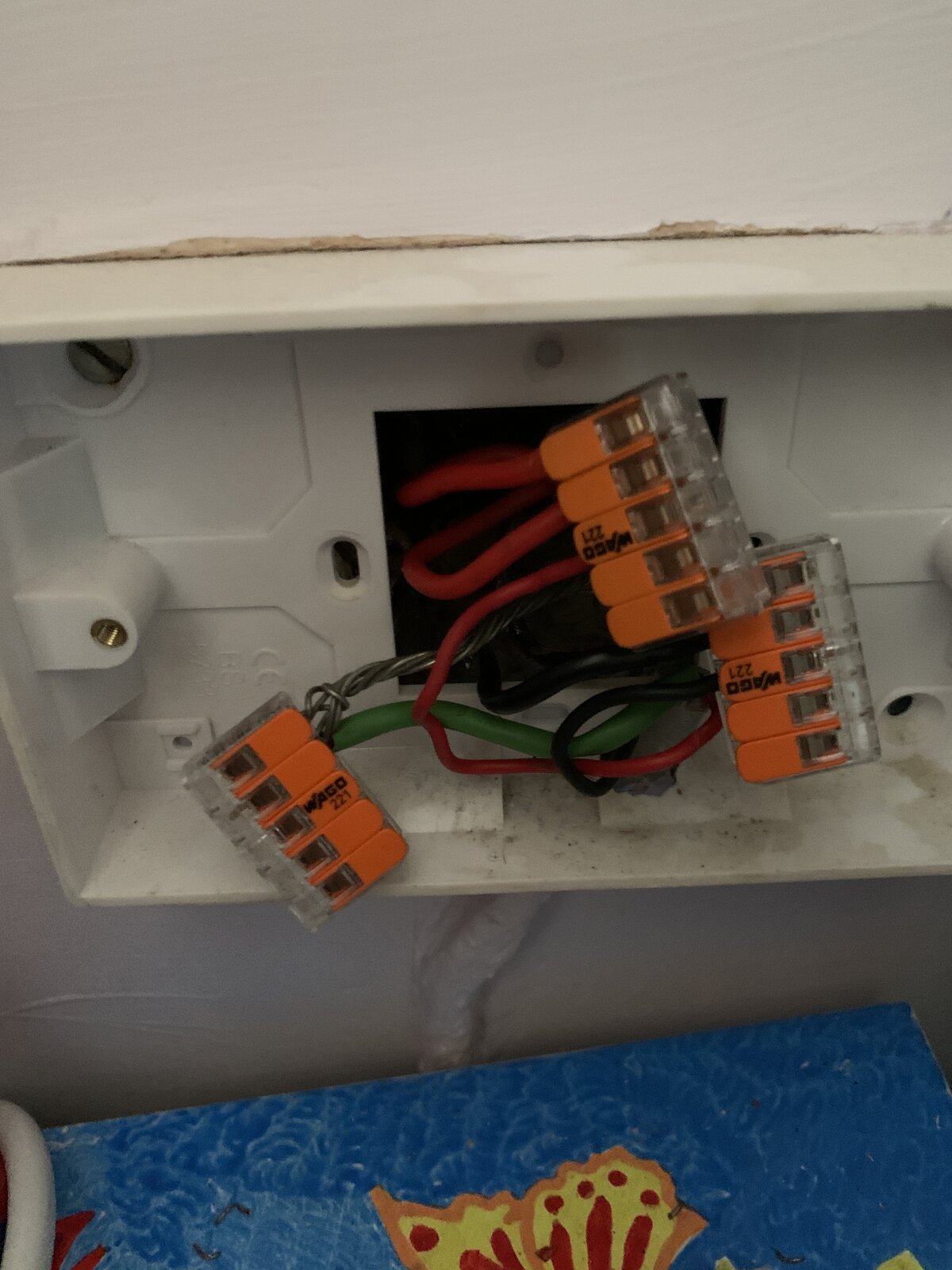

To get around this, I got hold of some WAGO connectors and currently have it set up per the second picture. So basically I have braided live ring main in, braided live ring main out and live solid core connected to one WAGO, then the same for Neutral and again for Earth - although oddly, Earth only seems to have one braided cable and one solid core. Is it safe to use WAGO in this way? and should I be bothered that there only seems to be one braided earth cable (they are unsleeved, so I guess it might be both of them twisted together)?
My thought is that I can now run a short cable between the outlet and the WAGO connectors. Is this safe? and can I run just a single cable between the WAGO and the outlet, or should I run a pair of cables to protect the integrity of the ring main?

earth is usually thinner than the main cable - for example T&E 2.5mm brown/blue are 2.5.mm and earth 1.5mm
check if the brad thats twisted together actually goes back to the 2 grey cables
if a ring main, for the braded 2 cables - then earth needs to be joined so the circuit is a complete ring
The earth should have yellow/green sleeving
where does the other cable go and feed - looks much smaller 1.5mm perhaps
you might struggle to get the socket screwed back on the back box with those wagos
Looks like old 7/029 on what might be the ring,
3 strands on the earth and 7 strands on the main red/black - so looks like the earth is complete for a ring, but still easy to check looking at the 2 grey main cables for the ring - to make sure
, OR perhaps a Radial
note sure how those braided cables will work in a wago connector - never done that in past
note - not a current qualified electrician .....
Stranded - not braided.
Surely you can tidy up the wires and get them into the socket terminals.
If definitely not, then return the socket as not fit for purpose.

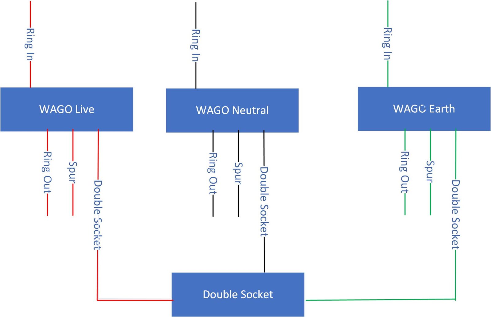

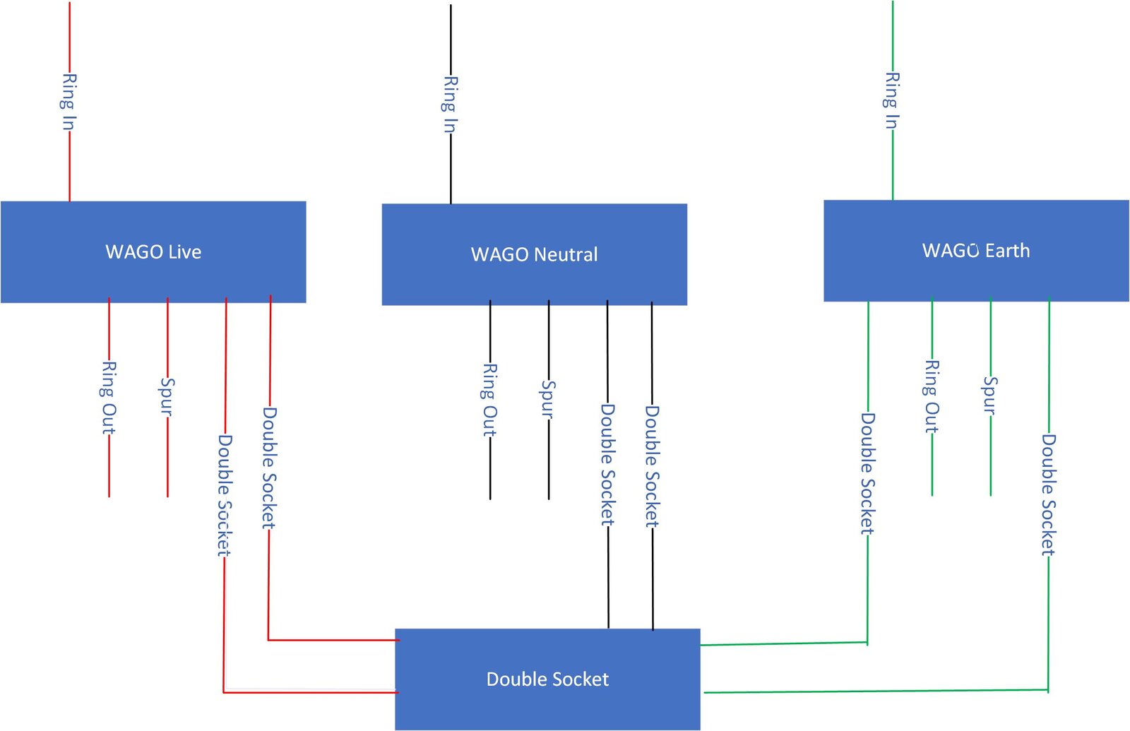

Assuming that I use a deeper pattress so the WAGO connectors can be accommodated and assuming that I can get a good tight fit from the stranded cables into the WAGO connectors, do I need to run a single cable from the WAGO to the new socket (so it looks like a spur) or do I need two cables into the socket (so it looks like a ring main) - i.e. should the wiring look like the first drawing or the second?
Single wires are all that is needed.

Just straighten the ends (or cut back to fresh if long enough) and don't twist them together.
