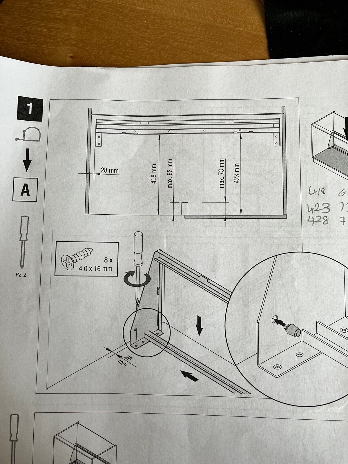

I am fitting the above unit. The instructions indicate that the centre post of the cabinet should not be more than 73mm. Mine is 80mm
The instructions provided indicate the back panel should be moved further back if the centre stop of the cabinet is wider.
ie if its 68 mm wide the back panel is fitted 418mm from the front of the cabinet and if its 73 mm wide the back panel is fitted 423mm from the front of the cabinet.
The stop on my cabinet is 80mm wide so should the back panel be fitted 430mm from the front of the cabinet.
Has anyone fitted a unit like this. Hafele just refer me back to the website which just indicates a 68mm post.
