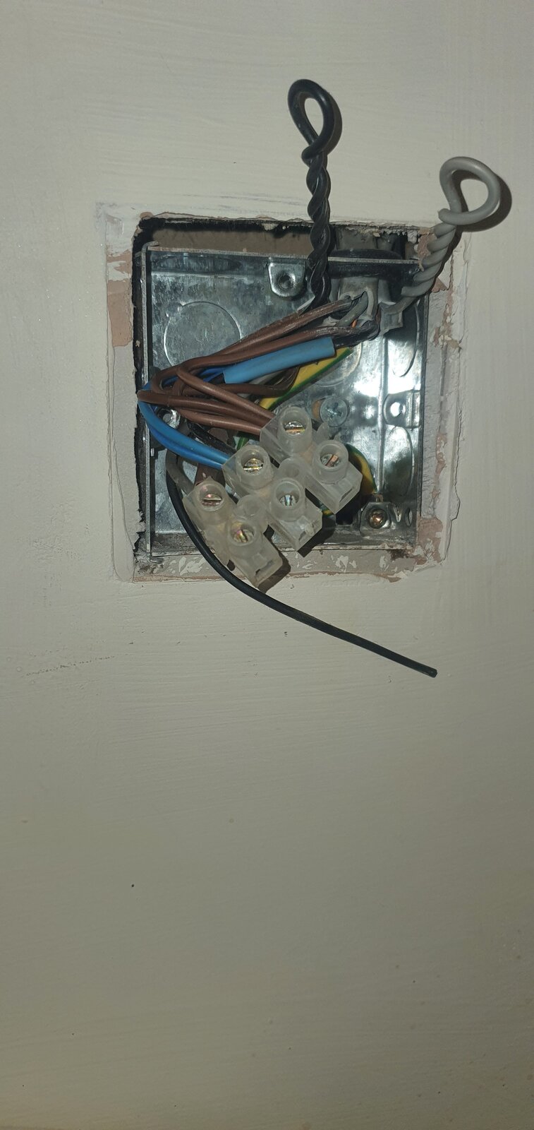

Sorry, me again.
Just for confirmation/a second opinion, this is next to the boiler. Looks like the thin black wire not connected is the one that terminates behind the tp5000. I just need to hook that up to the middle connector on the block (with the mains turned off as this isn't on its own circuit from what I can tell) and then I can re-test at the thermostat to confirm neutral is now connected on this circuit?
If:
1. The black wire you refer to is the unused wire with the blue sleeve that goes to the thermostat, and
2. The middle terminal is a genuine neutral that forms part of the heating circuit wiring [test with the multimeter to confirm]
Then yes.
