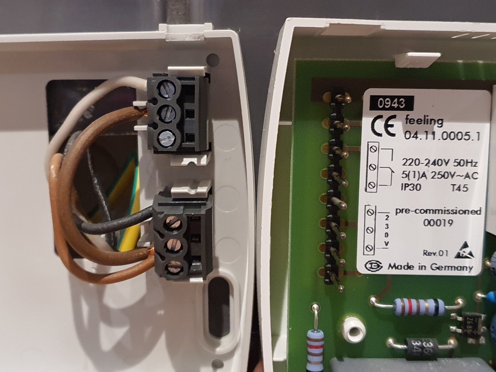

Hi Guys,
I'm looking to swap a Grasslin Rf Feeling for Honeywell Evo home. Grasslin is switching on fine but can't no longer rely on the set temperature.
Can anyone advise from my current install how I should be wiring a Bd91? I'm slightly confused as there is no neutral wire. Tracing the wires it looks as though the black wire is connected to a switched live. My boiler is an HRM wallstar
Any help is appreciated!

Marlon, are you having a laugh or are you serious
Take a moment and look at what you have at present
Where do you think 230 refers to on your present and proposed unit
Seriously, if you are challenged by what is almost identical setup, I wonder how how you will fare when pairing is undertaken and other hurdles encountered
From my understanding of the grasslin the bottom 3 terminals should have the neutral and live input, however both wires are live. I appreciate the setup does seem very similar but just want to clarify things.
BDR has mains terminals, one N and two L terminals
Black to N
Brown to L
The brown link 2nd L to C
White to NO. Cannot remember but switch terminals might be 1 and 2, go like for like to existing receiver
So are we saying my black is actually a neutral? It has brown tape on further down and this is where my confusion is coming from as I led me to believe it was a switched live!
Thanks for the advice guys. I thought most sparks were very anal in their work and would try and stick to colour codes.... Looks my guy found whatever wire was in his van!
Should my link go to C or A? Evohomeshop suggested A as its a 'common' terminal
