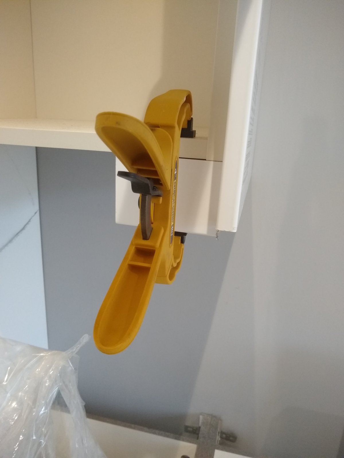

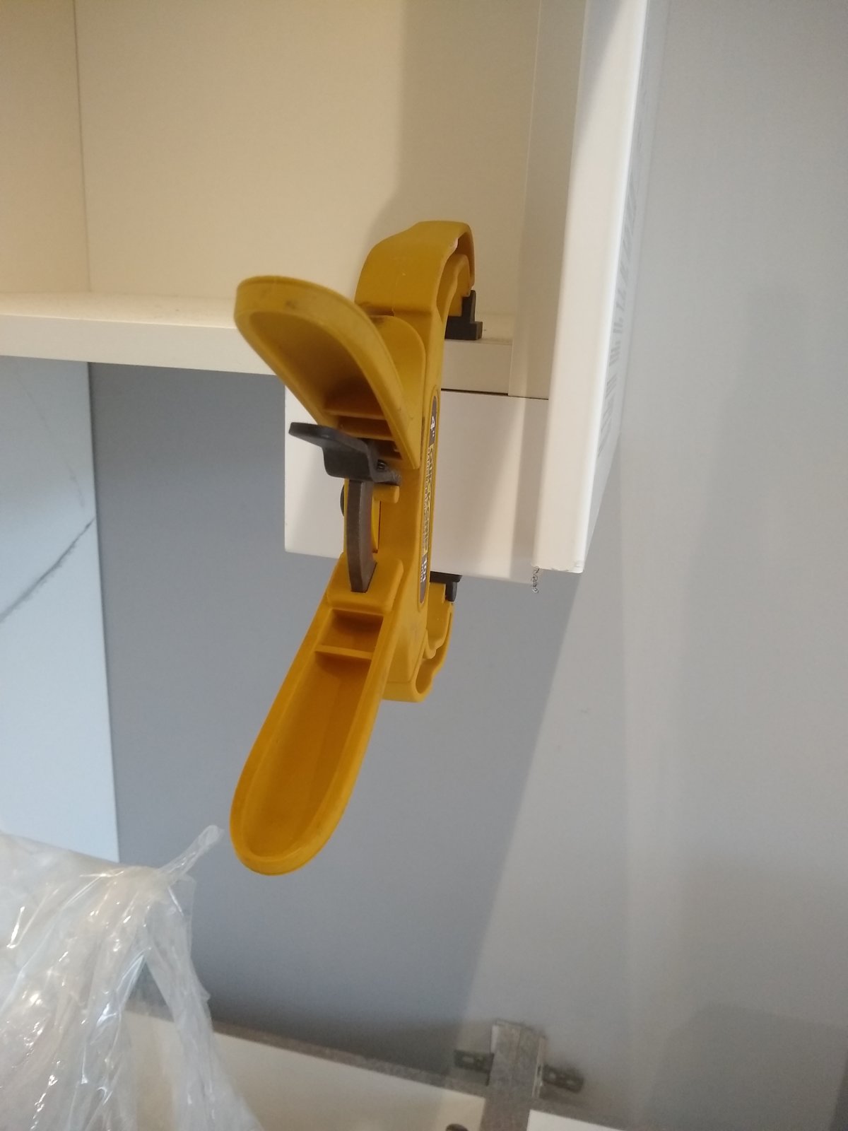

I'm just installing my wall units and about to put the fascia end panel on. I've cut a sample of pelmet off so I can ensure they I am getting the level of fascia end panel right before clamping and screwing.
Am I correct in saying that the TOP of the fascia end panel finished flush with the top of the wall unit, and the bottom part overhangs the bottom of the unit, which is where the pelmet is, this finishing flush.
My problem can be seen on the pictures. The only thing I can think of it that I need to cut down the width of pelmet in order to finish flush with the bottom of the end panel.
Am I correct in that you need to trim it down?
Thanks.

All the ones I have done are the panels same size as the cabinet and the cornice is mitred and run down the side too.
