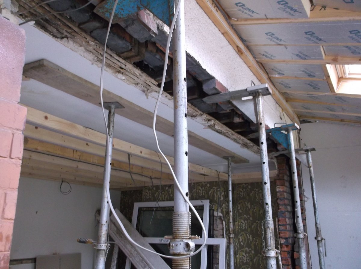

Strongboys can be used to support both skins - they're long enough.
(in this instance, the inner skin is supported via props under the floor joists).

Almost ready to get started on this now, just want to double check the temporary support...
I am thinking of using strongboys on the outer wall skin (one every 70cm or so), then support the inner cavity skin by using scaffold planks on acrow props holding up the floor joists (as they run 90 degrees into the wall) - as far as I can make out basically the same setup as Tony's photo above. Am I missing anything - anything I need to check (eg do I need to rip the plasterboard off the ceiling and check that the floor joists are fitted into the wall OK etc)? In case it's relevant, its a 1985 house with 75mm cavity and celcon lightweight block for the inner skin. Cheers!
