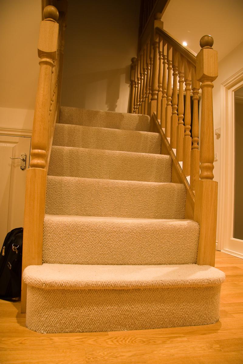

I need to fix a child safety gate to a nice oak staircase. The thing is, I don't really want to drill into the staircase so I'm wondering if anyone can think of a way I can do this? I'm thinking if there was some kind of bracket or other mechanism I could use to attached a piece of wood to the posts I could then screw the safety gate into the bits of wood and not have to harm the staircase.
Pic of staircase attached.
At the end of the day, my son's safety comes first so if there isn't a safe way of doing it we'll just have to screw it!

my solition would be to buy your stairgate making shure it will fit an opening 50mm smaller than the opening[25mm each side]
buy some timber the same size as the newel post [21x100x1200mm!!]width and length to finnish on a square section off the newel
attach gate to timber and use several cable ties to secure in place
just make shure the timber sits on the stairs so it cant slip down
the cable ties will dammage the wood without padding so you have the choice off padding out with some paper or not

is the gate to be fitted at the bottom or the top?
just a thought if its at the bottom,can you not slide the gate between the spindles on each side so theres some overhang,drill some holes in the stairgate and insert some dowells so its nicly wedged on the outside,i know what im trying to say wether its come accrossed properly???? :lol:
