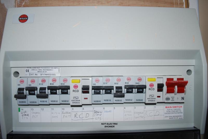

I am about to wire in my hard wired tumble dryer in a couple of days. Just want to double check before i get started.
I have a new consumer unit (professionally installed) with two 'banks' of mcb's RCD protected (see photo).
The tumble dryer istructions ask for it to be run from a 30amp fuse ... the Kw rating is 6.05 which is about 27 amps. Can i hard wire the tumble dryer into any of the spare mcb's on this unit or do i need a seperate supply altogether?
P.s i know how to do the hard wire and cable size.

It would be possible to use the spare 32A on the righthand RCD.
Do i see smoke detectors wired from the same RCD as sockets? Is that correct?
You could supply a circuit on position 5, since the 32a MCB appears 'spare'.
Obviously you know the cable size required and also how to test the finished circuit, pre commissioning and post installation :rolleyes:
You are intending to provide a new circuit, and as such that shouldn't be done without the correct tests and IEC sign off / Part P gubbins.
Take the cover off the wylex board and lets see the insides, I'm concerned that:-

Was he planning to use that 32A MCB for the upstairs sockets then?
If so then you might have to swap out the 16A MCB for a 32A one and hardwire the tumble dryer from this circuit with a 4mm² t+e radial.
It would have been a good idea to leave some spare ways. Or is that 16A MCB a remaining spare way after all the work is completed?
Looking at it again i think yes (as i said i will double check)
Sounds like a plan although i had intended to use 6mm

6mm may be required anyway depending on derating factors and if you are going to have some other high power appliance in this location in the future (ie induction hob etc) then this may also be a good idea.
