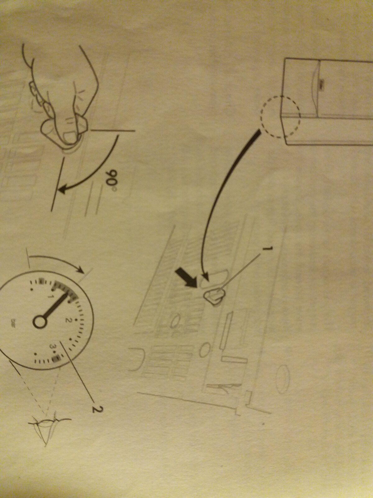

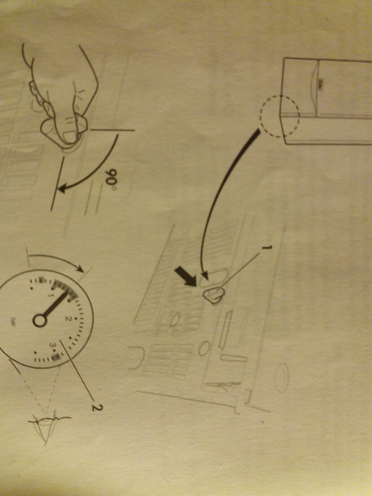

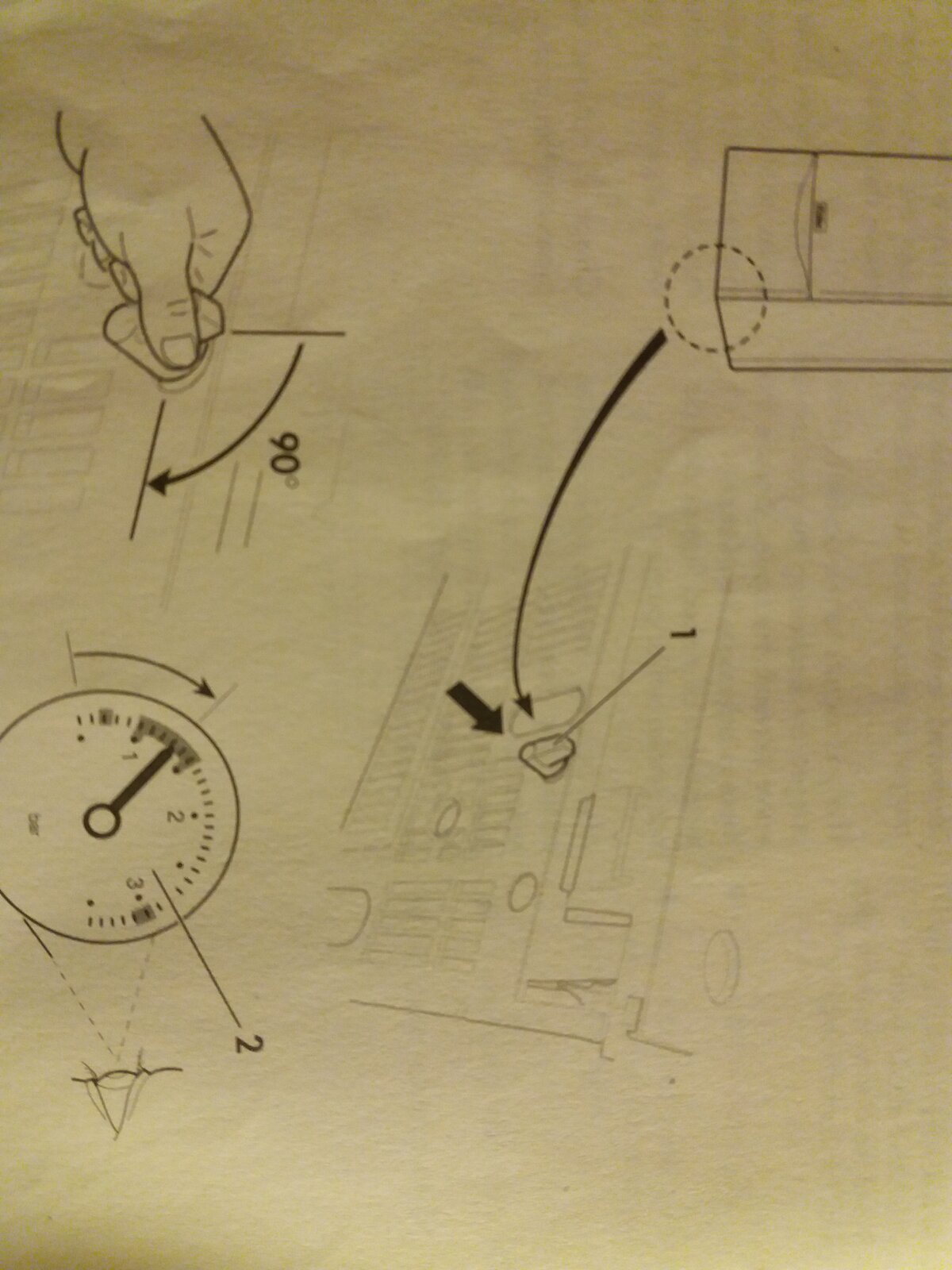

In which case, it can only be that is letting by slightly, or the plate heat exchanger is cracked (which I've never seen on a vaillant) although could be a one in a million fault, both are very straightforward fixes
Thanks for the info ScottishGasMan
The filling valve is underneath the boiler

OP, one of the (two?) filling loop isolation valve(s) is passing, causing the pressure to rise steadily. As previously advised, remove the 'temporary' filling loop to expose the cheeky little leaker, then repair/replace that valve.
