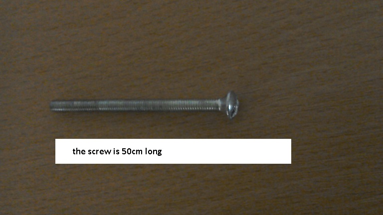

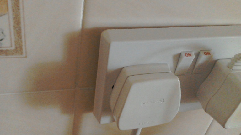

Hi. For years, my parents have had this socket in their utility room. The screws are round-headed and don't allow the plugs to be fully inserted. Apart from having to jiggle the plug occasionally, it didn't bother them.
It bothered me, though, so I intended to replace the screws. I took one out but now find that it won't go back – it seems like there's just fresh air behind the plate, nothing to bite into. Can anyone suggest what has happened here (i.e. why were inappropriate screws used) and how best to fix it?

Maybe the screws were too long in the first place but if you remove them both and gently pull the socket away, you'll see the lugs that the screws fit into. They do tend to float a little to allow the socket to be made level when fitting.
John :)
I assume that you turned off the power at the mains?
If you visit a DIY shop or look online you can see a metal back box to understand what should be in there
Presumably there is one.
You can buy replacement screws in the same aisle and it is possible that somebody has bodged it with screws that are too long. The problem may be that the screw bottoms out on the box before being tight.
I'll be damned... It took a bit of jiggling but it does screw back in after all. I'll see about getting proper screws now. My thanks to you all.

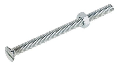

Well, this is depressing... I bought some 'switch box' screws (50mm, flat head). I can screw in the existing 'round head' virtually all the way by hand. The new flat head sticks almost immediately and can't be turned even with a screwdriver. The screws look identical bar the head.
Can anyone suggest why the new screw won't 'take' and what I might try to fix this problem? (e.g. run a file around the tip...)

NEVER force the screws in, if they don't go there is a reason. My guess would be imperial threaded box. In which case you can get an m3.5 thread cutter for a couple of quid and gently re-thread the old box. Easy peasy.

Thanks for the tips. I don't think the length of the existing screw is the issue, I reckon it's simply that it's round head is just a tad too big. I bought a pack of 'switch box' screws (flat head) which comprised 4 screws and 4 nuts. The new nut slips easily up and down the length of the OLD screw but new nut/new screw only just goes on then stops.
That suggests to me that the thread at the tip of the new screw is 'different' and so won't work in the existing setup. Does that make sense?
Switch screws with nuts ? Think you have the wrong product
The packet says Switch Box, the screws resemble the existing ones so I'm satisfied I have the correct product. True, I couldn't see any reason for the nuts...
Switch off the mains , pull the socket forwards and take some photos of what's behind. Can you measure the depth to the back of the metal box?
The official thread is 3.5mm - maybe you just got one cross threaded? Try the nut on the original screw to see if they are compatible.
