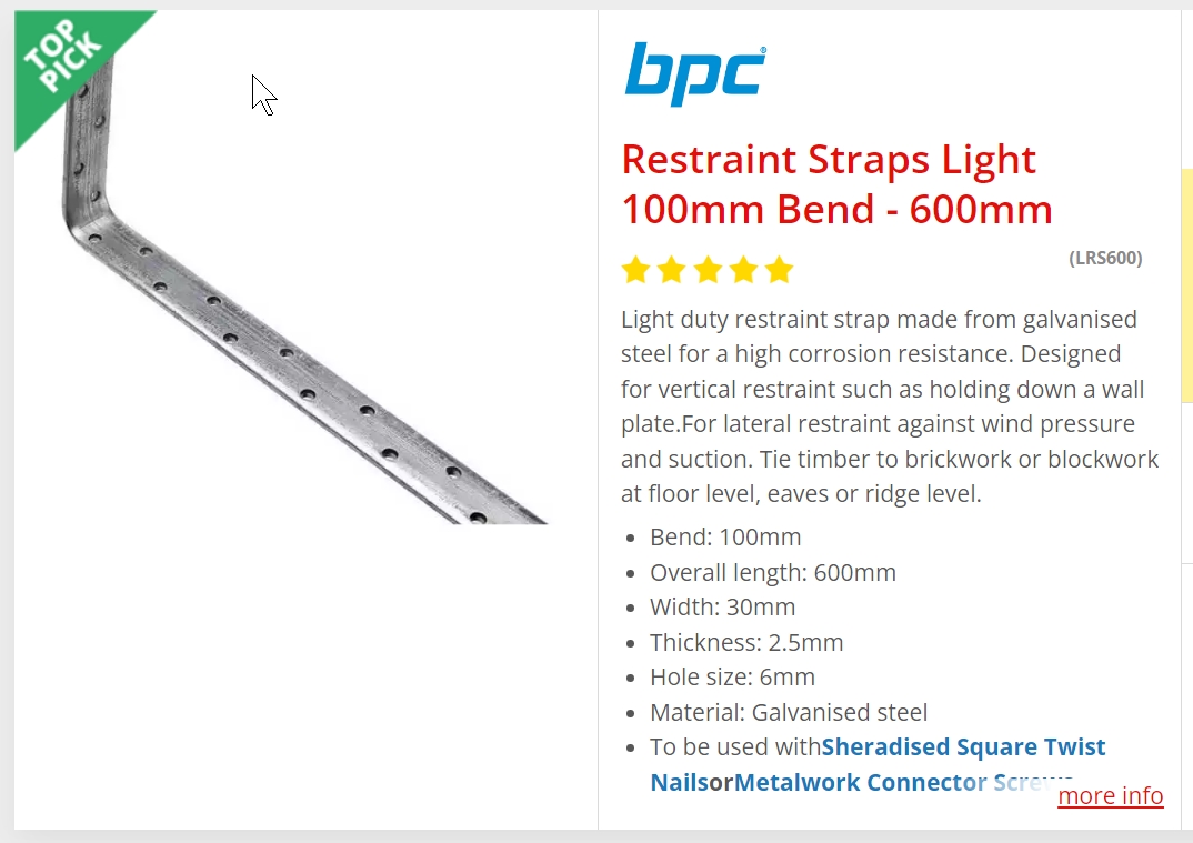

I am not sure how to fix door linings onto the blockwork. It is aerated blocks and you cannot really use large screws, the blocks crack. I can get away with 6mm wall plugs drilled right in the centre and a small 5mm x 60-80mm timber screw, but just as a temporary fixing, I would not have a door slamming closed on that. Plus, a screw in the middle of the wall does nothing to hold the lining from twisting.
I am thinking I must use adhesive all around the door lining to secure it in place. Could anyone please suggest the right materials to use, or method?

What is the name / make of the adhesive I should be using to secure bolts or plus into aerated concrete blocks?
For fixing the door linings:
1. I cannot use two screws side by side, as is the custom, I can only drill into the centre of the block to avoid cracking
2. The expanding foam will not stop the lining from twisting with time, or shaken off if someone slams a door shut.
For that I am thinking of using restraint straps as in the photo, on both sides of the walls where the door opening is. The straps will be secured onto the blocks with many more screws and then the hardwall over.
