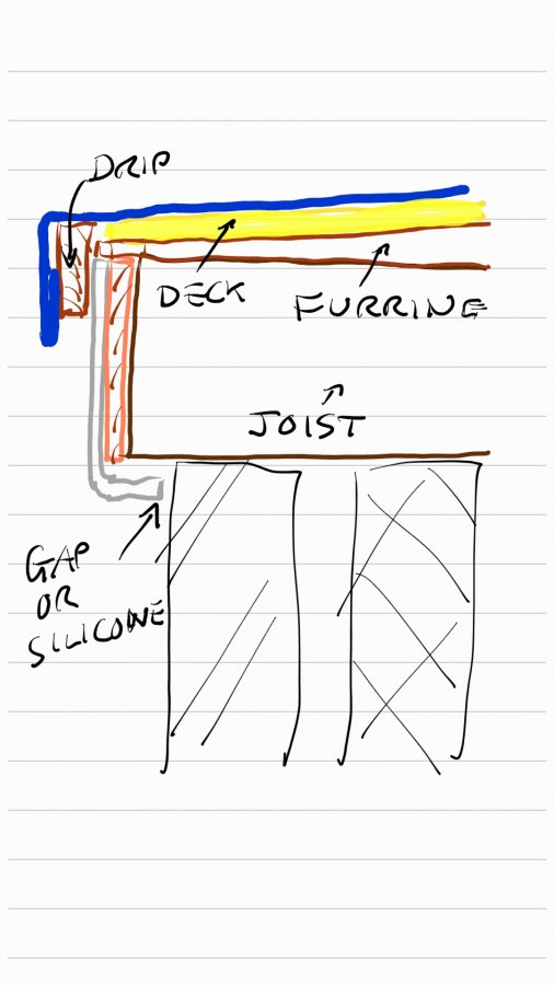

1. How far should the joists extend out of the wall?
2. How would I go about attaching a pvc fascia board to the joists? I was under the impression you just nail it on, but I read you should put some ply on the joists and nail the fascia to that?
You were up late!
1 out in which direction? From a structural point of view not all at, but if you want to create an overhang to protect the wall, that's fine.
2 fixing into ends grain isn't very strong especially if it gets wet, but fascia is not heavy. Thinking about it, I'd probably put blocking at the end of the joist and screw to that. But the pros probably have a better answer
You need to allow such overhang to accomodate any soffit, vents, or just the return leg of plastic fascia plus 5mm to stop water running down the wall.
Plastic fascia capping needs a base board. Normally 25mm treated timber nailed to the ends of the joists.
You also need to form a drip around the top of the fascia for the roof material to hang over - don't stick the roof covering to the fascia. This drip is a piece of tanalised timber 50mm deep and minimum 25mm wide.
You were up late!
Hah, I'm a night owl and relish the stillness of the night :p
Thank you very much for the replies guys, I have a much better idea of where I'm heading with the roof, and thanks woody for going out of your way to make a picture! That is very kind of you.

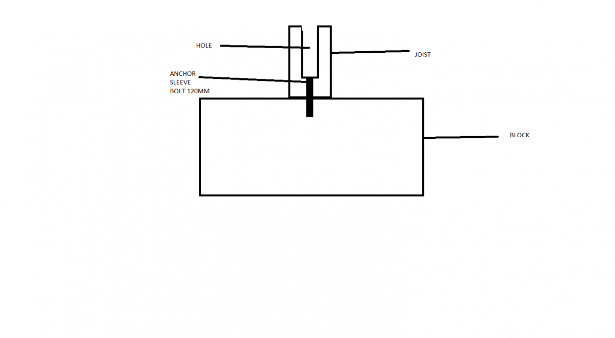

Woody, you recommended 120mm anchor sleeves bolts, with 70mm in the masonary. That means I will have to drill 170mm into the joist with an auger bit and then a 12mm hole the rest of the way for the bolt to get through so I can nut it up. Does this sound about right? I am a little concerned about weakening the joists by doing this.
I dont understand.
You are fixing a bearing plate to a wall. The timber is 50mm (or 47) and you will go into the wall 70mm, so that's 120mm.
But thinking about it, it will depend on what type of bolt you get. If you are using a masonry bolt or a hammer fix type, then yes a straight 120mm will do. If using a sleeve anchor or a expansive type bolt then you will need perhaps 130 or 140mm or so.
I dont understand.
Thanks for the reply. I'm not entirely sure what you mean by bearing plate here.
I've attached a picture of what I had in mind based on your replies. The hole was only there because the sleeve has a nut which needs to be tightened,
I do have some 120mm x 7.5 concrete screws, which would be much easier than using bolts.
I thought you were doing this
or a 8x2 timber fixed to the wall face with timber joist hangers on the front for the joists.
which would need the wall bolts
At the other end, you don't bolt joists down on top of a wall. You fit vertical straps every 2m.
Aha, cool. I was a little worried about having to drill through 220mm of timber, hah.
Those vertical strips look like a much quicker solution, I may just go with them. :)
