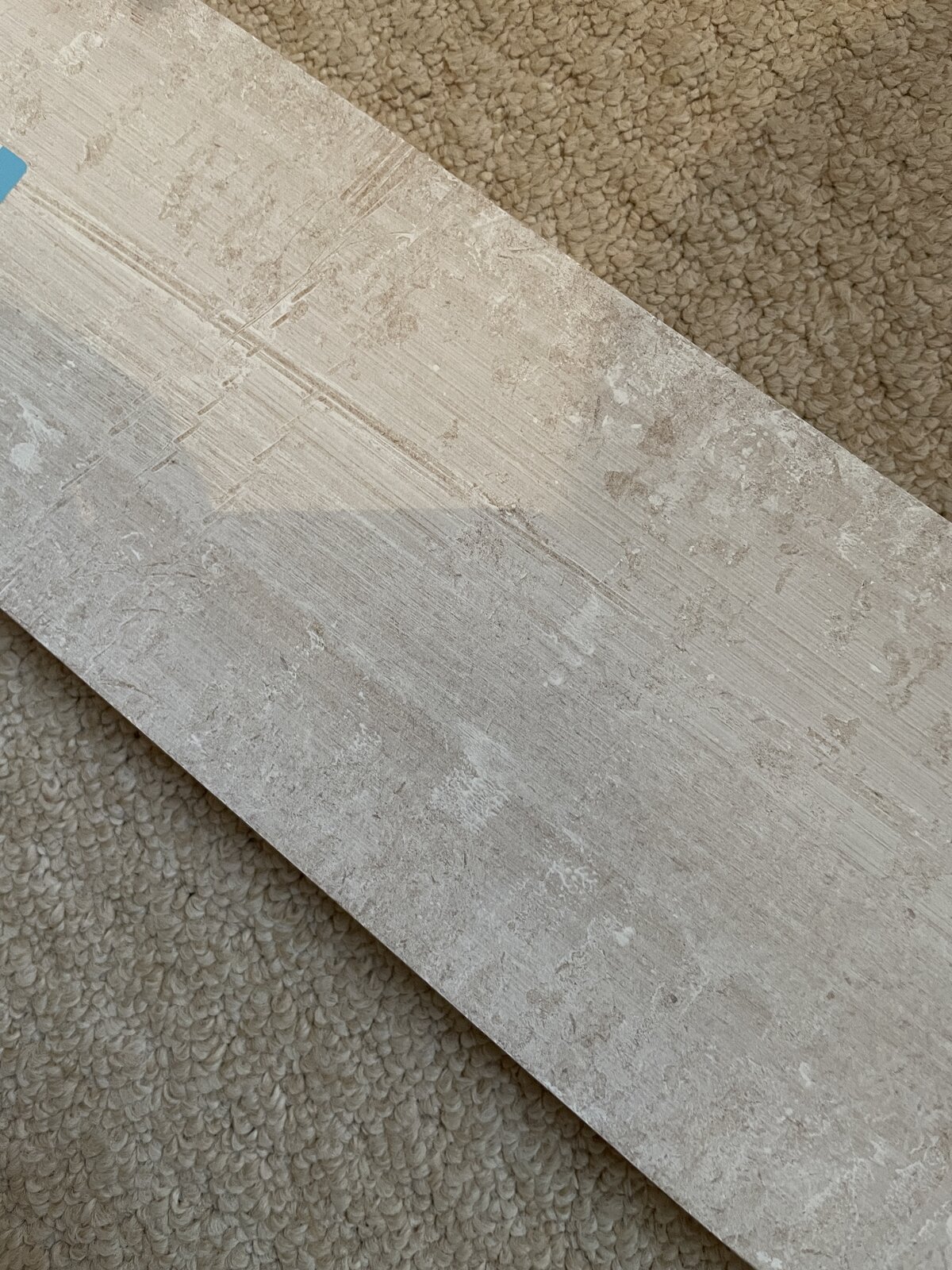

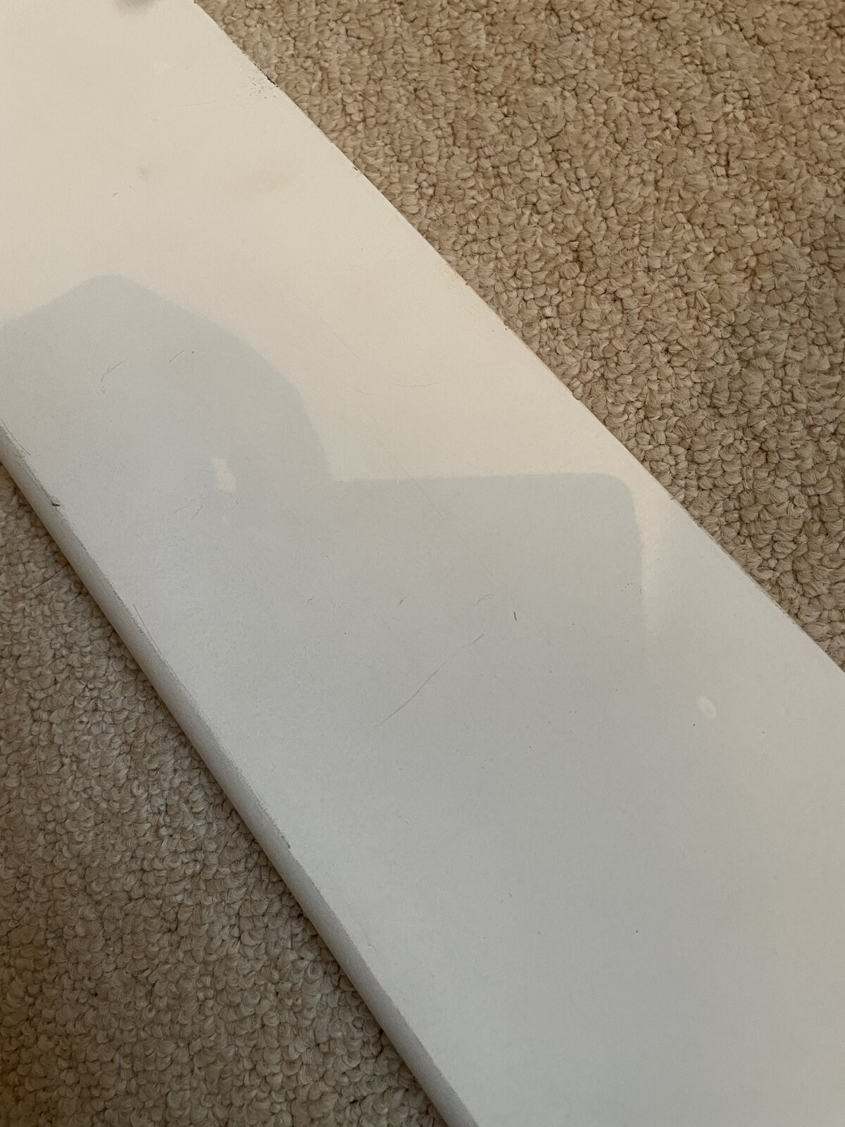

This skirting board is simply from B&Q
Here is a photo of the front and back :
As you can see, the front is primed whereas the back less so, so I’m not sure as to which out of your suggested products would be best
Would you lean towards the low expanding foam or would you plump for one of the adhesives you’ve listed @noseall ?
Thanks again for your reply
View attachment 379761View attachment 379762
We always use polymer adhesives. Foam is too unpredictable, even the low-ex stuff.
