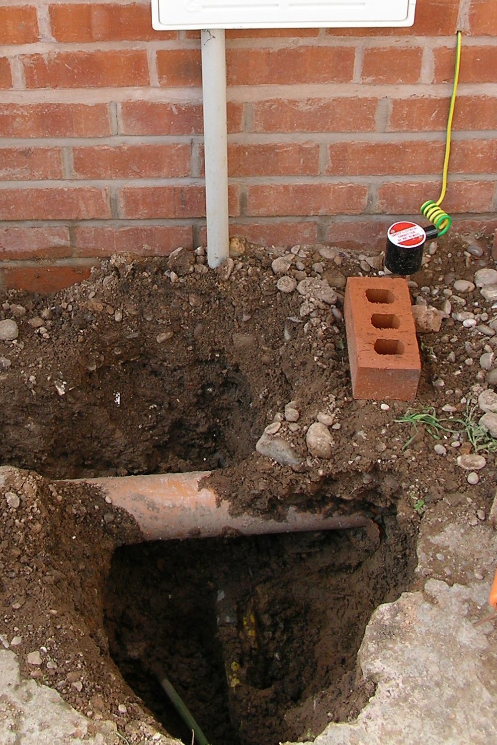

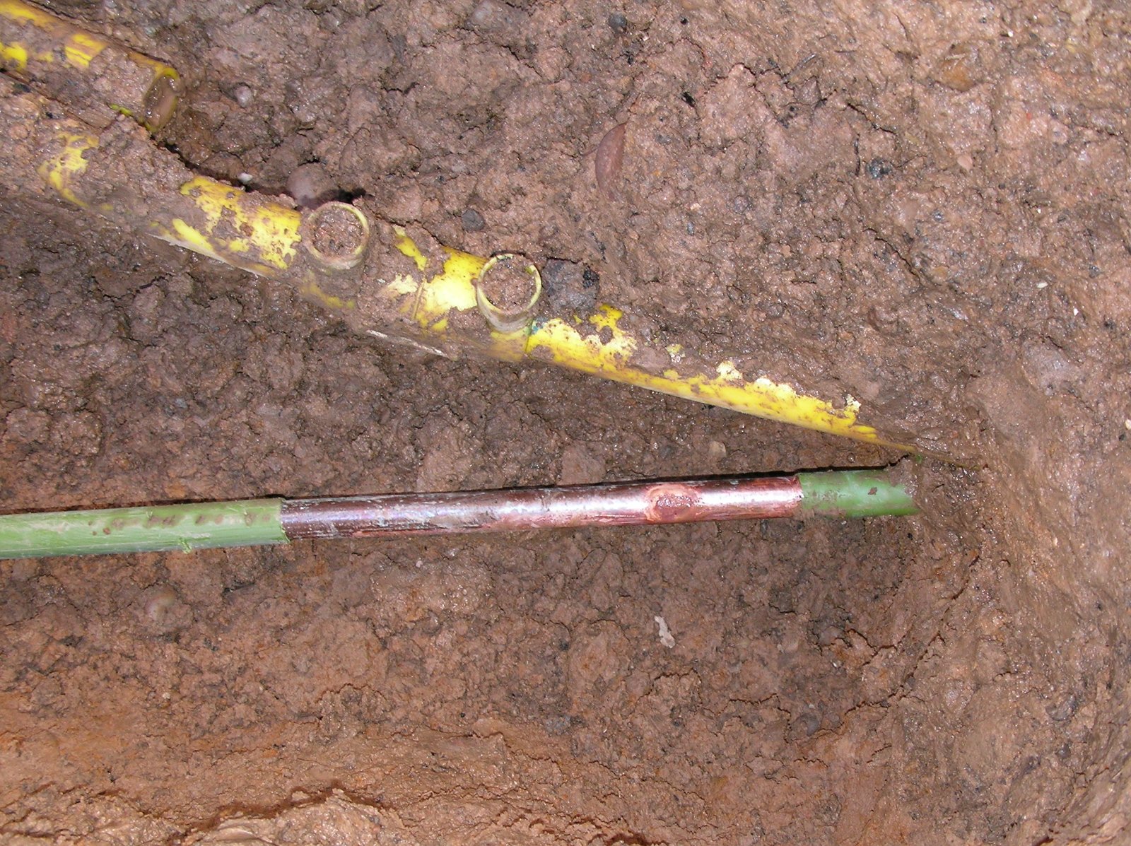

The water and gas enter the property right next to the earthing rod. The property was extended about 20 years ago and the gas meter was moved to the new outside wall.
When they moved the gas meter they damaged the water pipe and when this was repaired I took photos which show the locations of the green plastic covered copper water pipe, the yellow gas pipe and the earthing rod. The cut off yellow pipe went to the old gas meter.
There are two 10mm earth cables that run from the consumer unit, one going to the earthing rod and the other attached to the water pipes by the stop tap just behind the wall shown above. Both cables had low resistance and look to be in good condition.
1. The yellow gas pipe looks to be plastic to me and if this is the case does the gas meter need to be bonded?
2. If the gas meter does need to be bonded does it have to have a separate earth cable to the consumer unit or could it be joined to the water pipes bonding as the services enter the property?
I ask this as the distance between them is about 500mm and both are accessible at the back of a cupboard so it would be easy to whereas to get an extra cable to the consumer unit would be lot of hassle as it's in the centre of the property quite a distance away and it's not an easy route.

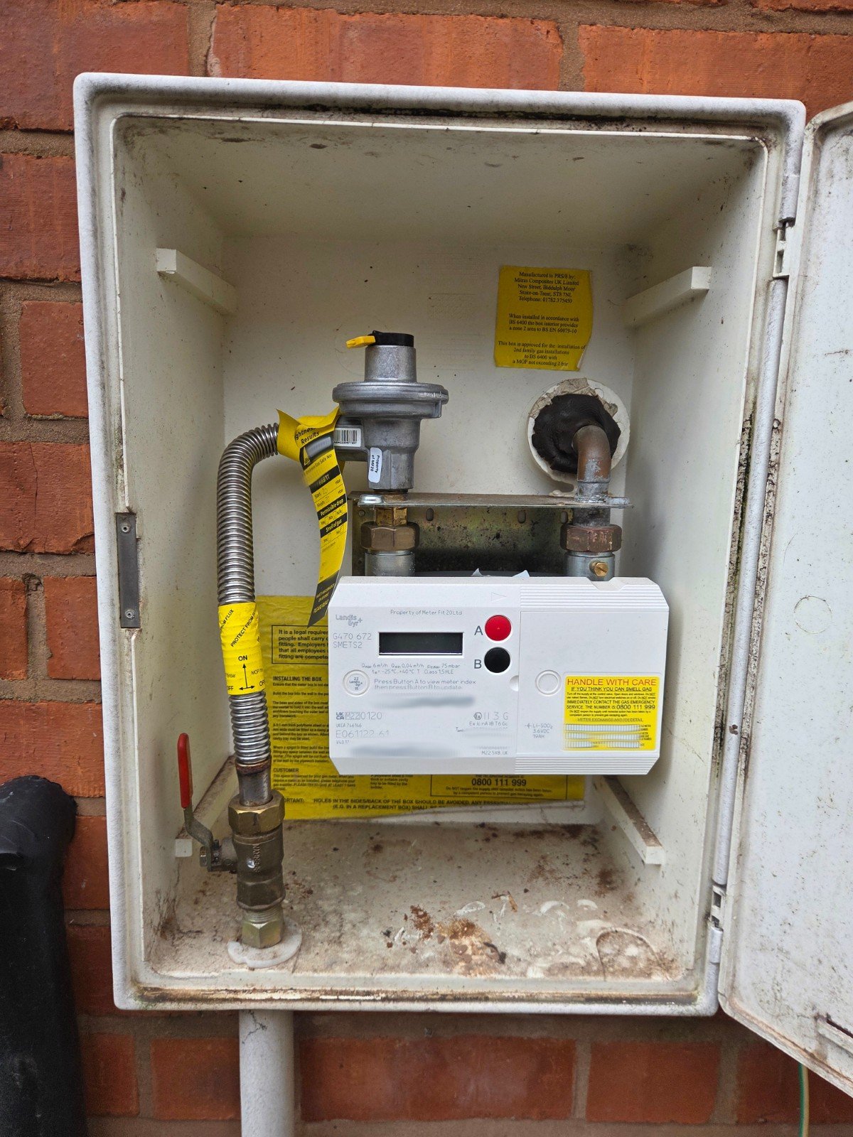

1. Can you post a picture of the gas meter showing the pipes attached to it?

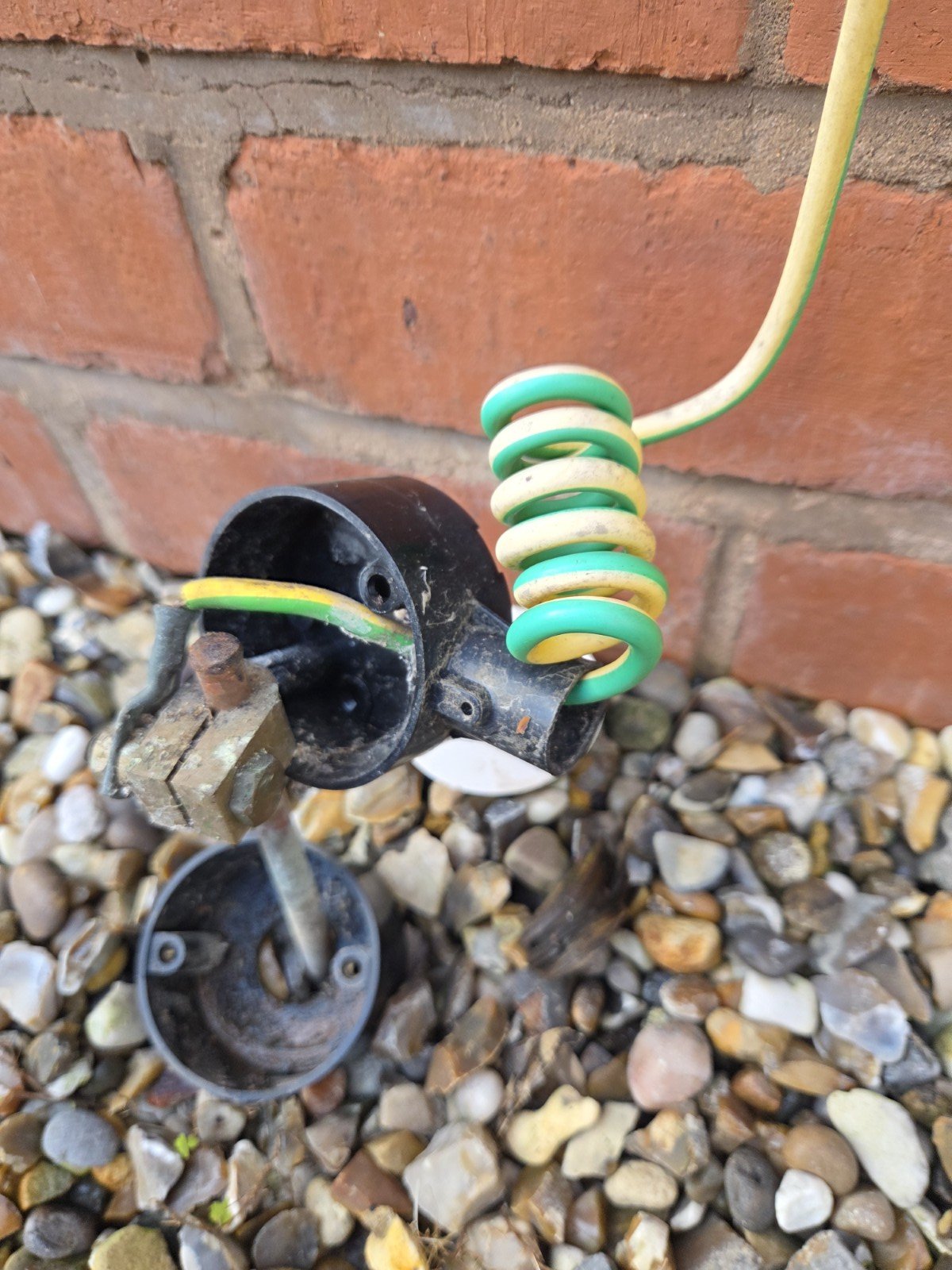

Here's a picture of the meter and the earthing rod as it stands.
Looking at the pipe entering the gas meter housing it's hard to tell what it's connected to as it disappears into the hockey stick.
From the pictures is it possible to say with any surety that the supply pipe is plastic or is there any other test I can do?

As for the earthing rod there is light corrosion on the exposed part of it with more at the top above the clamp. There is also a little movement left and right at the top of it but it's not loose in the ground.
The clamp itself looks intact and if I put a multimeter from the exposed copper wire before the ring connector on the cable to a cleaned up part of the rod before it goes underground then there is only 1 ohm of resistance and as there was low resistance in the earth cable to the consumer unit am I right in thinking that the problem is likely the rod in the ground.
I fortunately know the location of the underground services fairly well as the whole section was excavated for foundations and pipe repairs/work and there are photos. I believe there is soil down to a bit over a meter as shown in the pictures exposing the pipes and then it's hard rocky ground.
I take it if I was to replace the existing rod and clamp there is no easy way for me to test the rod without getting a sparky in with a proper tester?
Not without disconnecting the internal pipework.
If the supply is plastic do the gas pipes inside the house need bonding?
No, but it won't matter if you bond them unnecessarily as they will be earthed by appliances.

Incidentally there is a very old earthing connector with the frayed remnants of a cable attached to it on a water pipe near to the CU so my guess is that sometime in this house's 100 year history the water pipes were the earth.
