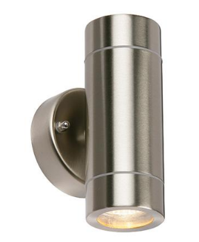

Fixing wall light to concrete fence post
glue.

Even traditional hammer actiopn is definitely a no-no, but I've seen people trying with SDS drills, whereupon the post usually 'explodes' or, at least, totally disintegrates!

There are clamp on brackets available - BAS provided a link many moons ago when I commented that I would be very averse to drilling the posts (I forget what the OPs question was). Aha, http://www.postfix.plus.com
What I changed the lights on the back of the house, I used Cavity Master solid plates which are just round pieces of galv plate stamped out. Drilled 5 holes : one in the middle to take a grommet, 2 to match the spacing of the cover screws for a standard conduit box, and 2 more to match teh spacing of the light fitting (which I tapped to a suitable thread size).
So conduit box fixed on wall, plate screws onto that with a short bit of flex coming through a grommet and a seal behind, and then the light fitting screws onto that.
I'll find out shortly whether that kept water out of the back of the light fitting - when I get something to replace them with. The supposedly suitable for outdoor use light fittings simply drew water up and the LED PAR38 bulbs filled with water :evil:

I’ve seen people fix 6x1 sawn timber on the front of concrete posts to cloak them. You could rout out the back for a cable, then fix with minimal screws. Concrete posts don’t look great. Cloak with timber similar to the fence panels.
just paint them with the same stuff as the panels - looks just like a wooden post.
