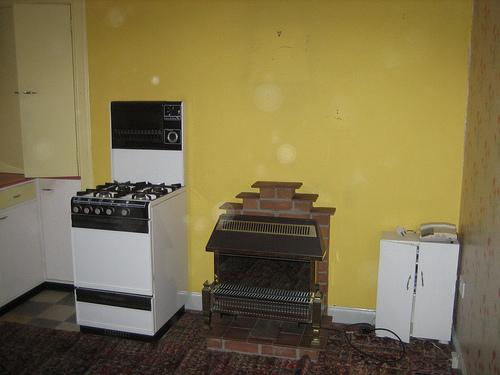

The Kitchen. Sadly the original fireplace has been replaced.

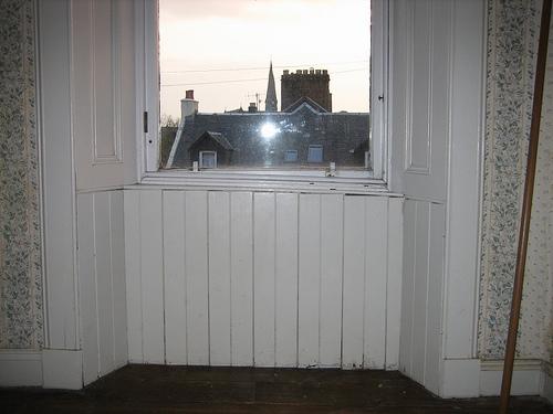

Bedroom 3. Window sill is bit lopsided.

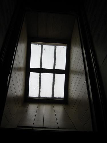

Skylight in the Hallway[code:1][/code:1]

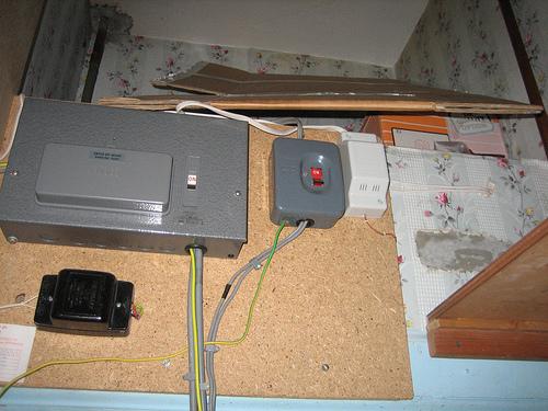

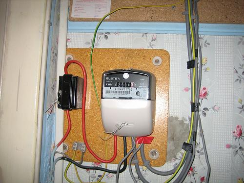

The Electrics

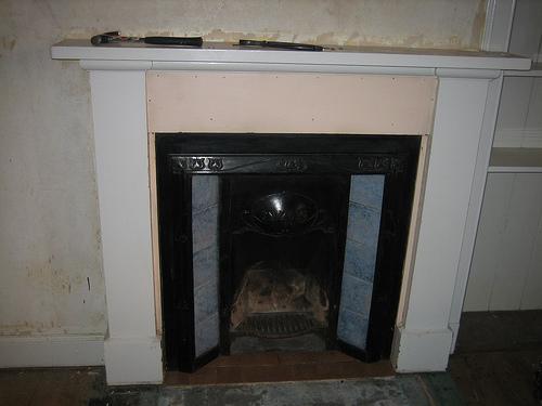

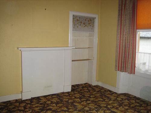

Behind the Hardwood panel lurks the original fireplace

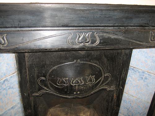

And another one.
Just a heads up that something looks very dodgy with the electrics - someone appears to have split the tails inside the meter (i.e. taken two feeds out from it) - most meters wouldn't have the terminal space to do that properly, so i'd be rather worried about that.
Also, the second set of tails feeding what looks like a switchfuse look far too small, in fact, is it actually a switchfuse, or just a switch?
just looks like a switch to me, no way to access the fuse without removing the cover if it is a fused switch..
might be a shower addition?
the electrics might be worth looking at, and definitely do something about that bodged on addition..
New CU might be an idea if you're doing it all out anyway, now's the time..
good find with the fireplaces.. if you intend to keep them..
lots of fireplaces though.. seems like every room has one? including the kitchen?
I had a look at the switch yesterday and couldn't workout what it was for (I never thought to check the shower though) and have just switched it off for now. I'm going to need some new sockets put in for the kitchen anyway so will get it all checked out then.

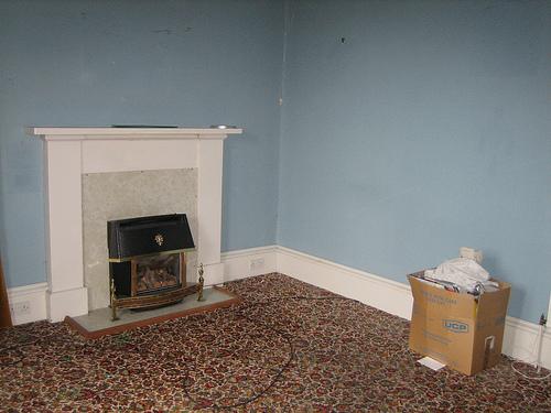

Unfotunately the 2 bedrooms are the only rooms which still have the original fires intact. The living room has been ripped out and concreted up. I'm thinking of putting a multifuel stove in there now and keeping the fires in the bedrooms for decoration.
The loft is pretty huge but we don't really need the extra space at the moment so will just insulate and board for now. The idea of Scalextric is appealing but not sure if the missus would go for it :)
