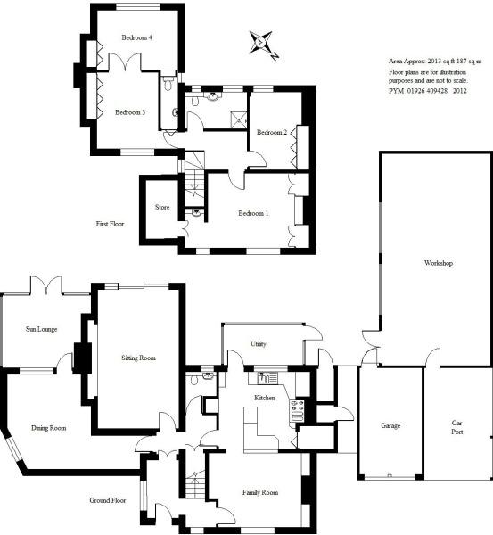

The initial house was built in the 30s. A typical two up, two down affair.
In the 50s a two story extension was built on the left hand side of the house. This is the "Sitting Room" and bedrooms 3 and 4 in the plan below.
In the late 60s/early 70s a single story extension, with a flat roof, was built. This is the "Dining Room". Then a UPVC conservatory was added; the "Sun Room".
What I'd like to do is remove the "Sun Room" and extend the "Dining Room" into that space. I'd also like to replace the flat roof with a pitched roof. Currently I'm getting a no from the council, but I haven't yet clarified their objection. So my questions are.

The original post is pretty confusing to me tbh, I'm not exactly sure what was existing prior to 1948, which is what is relevant for any PD additions. Maybe identifying the outline of the house as per 1948 or before would help ......

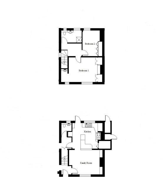

This is the original house.

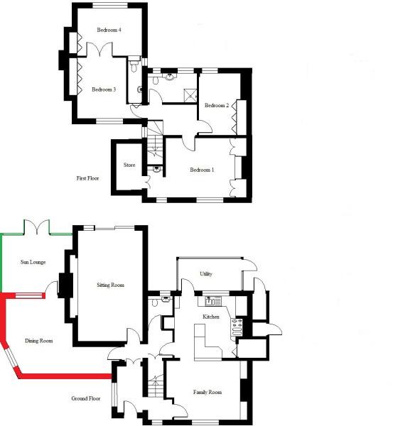

This is how it is now.
The red bit has a flat roof that we wish to replace with a pitched roof. The green bit is a conservatory that we'd like to replace.
OK, its obvious now, thanks.
You can only add Permitted Development works using the original plan as it is existed before 1948. Therefore building anything bigger than would be allowed by the PD rules will not be allowed. So its pretty clear that your roof extension and replacement conservatory would not be PD. Your architect should know this without having to ask the planners, it's basic stuff, the Muppet!
