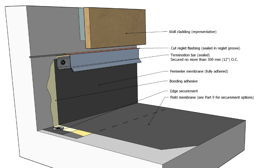

The other question is how best to finish the EPDM where it meets the vertical wall - much of it has a bellcast, so I'm thinking I can just check that it's sound, and that there's nothing bridging the underside, and leave the top edge of the EPDM stuck to the wall under the bellcast?
Where there's no bellcast, I'm wondering about grinding a narrow channel in the wall? Or put on another bellcast? I'd welcome any advice...

For the upstand yes you can tuck the EPDM under the bell cast as long as you can get a good seal and there is no way for the wate to track back under the bell cast drip. Where there is no bellcast you can grind a slot or some suppliers just recommend sealing with a flashing tape over the EPDM.
Something like this may be more elegant along the whole lot
