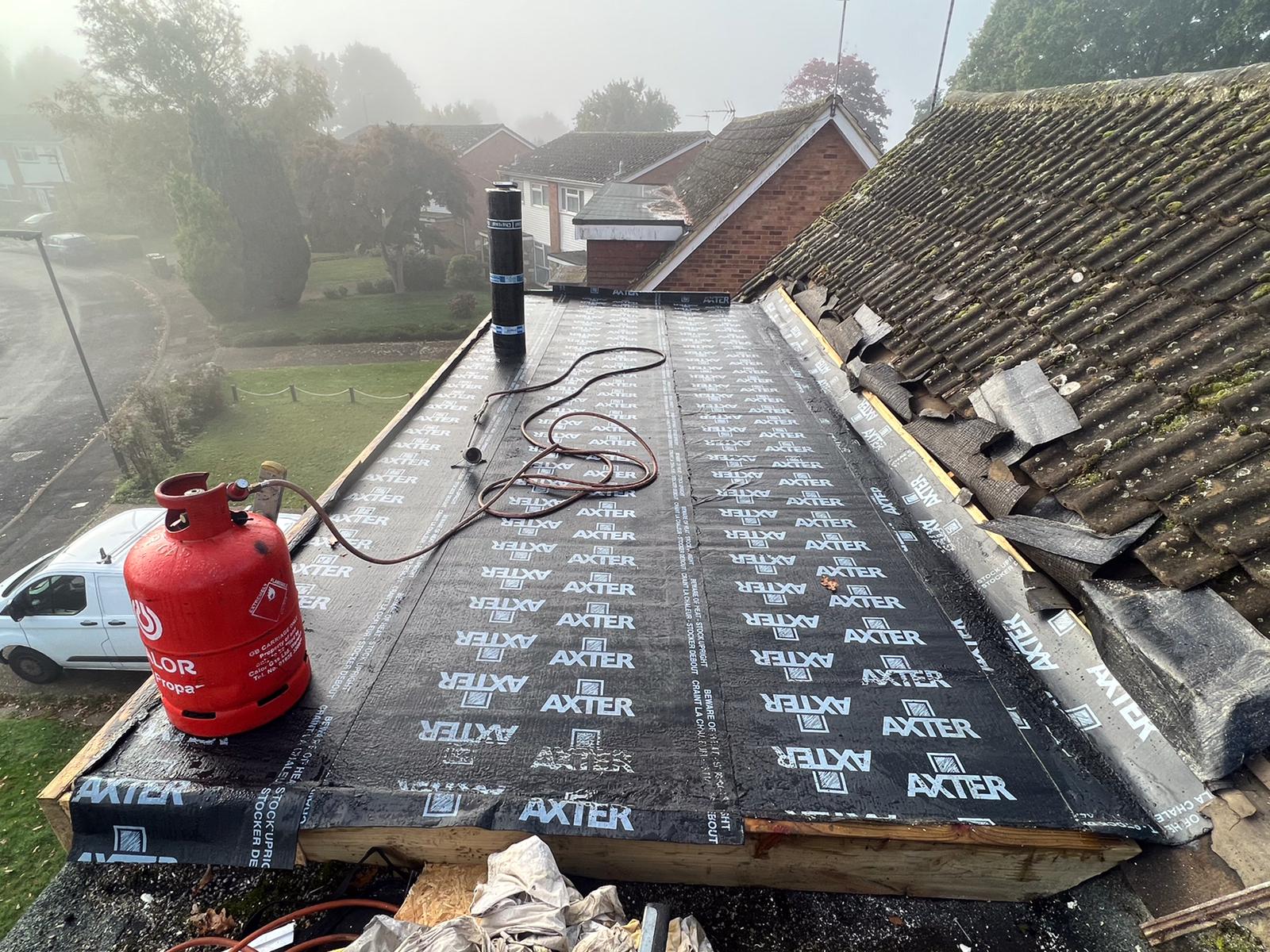

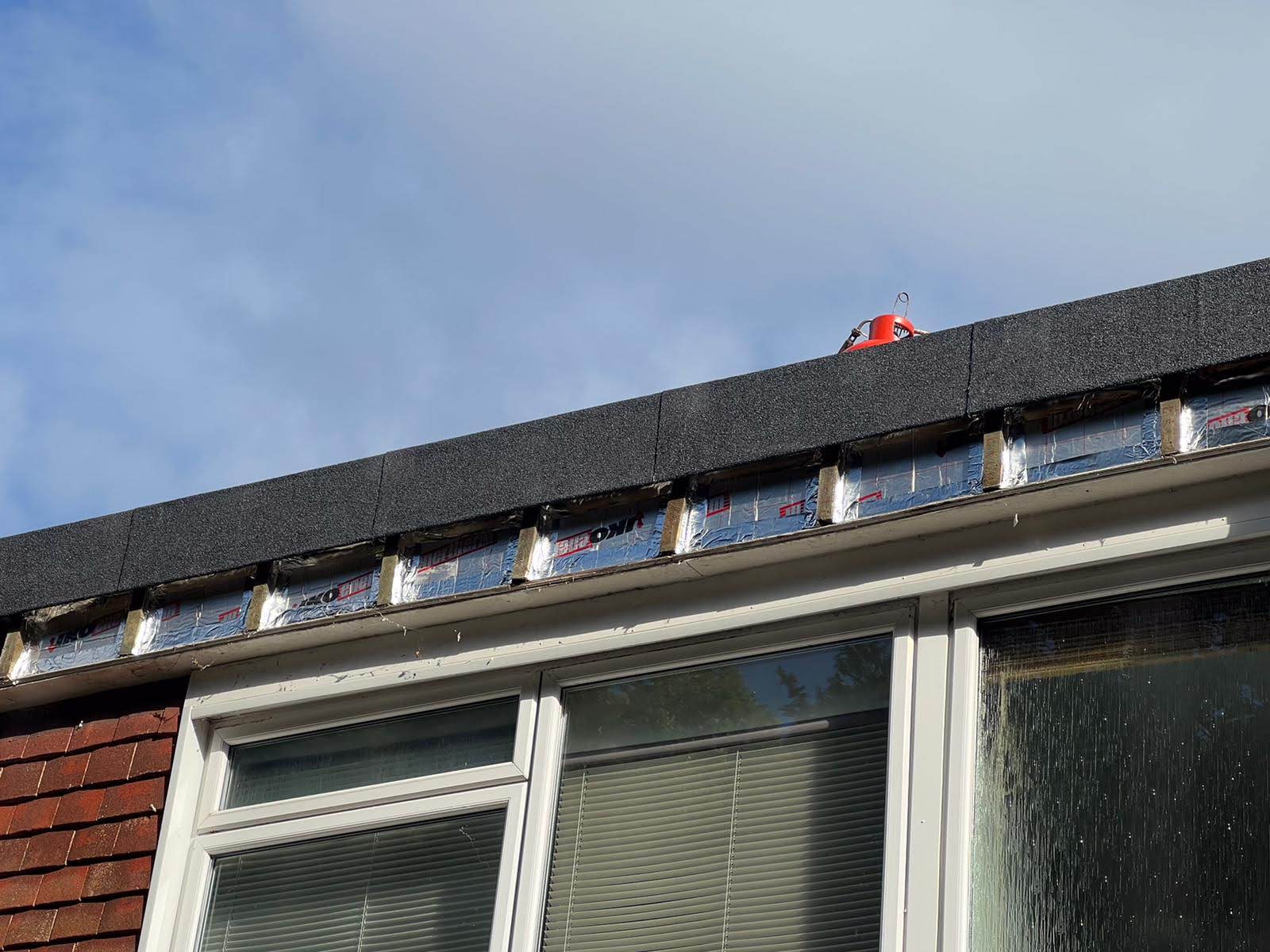

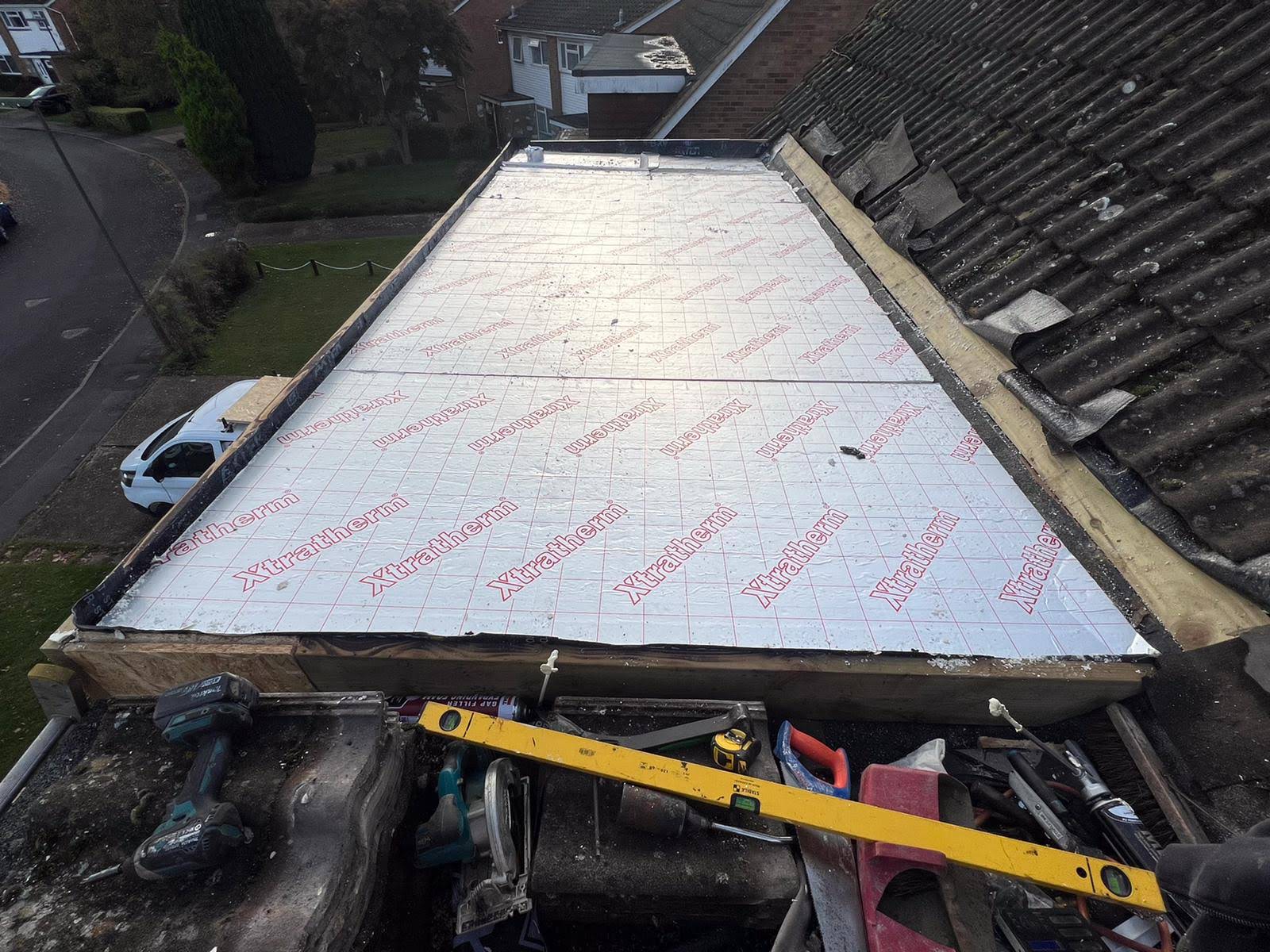

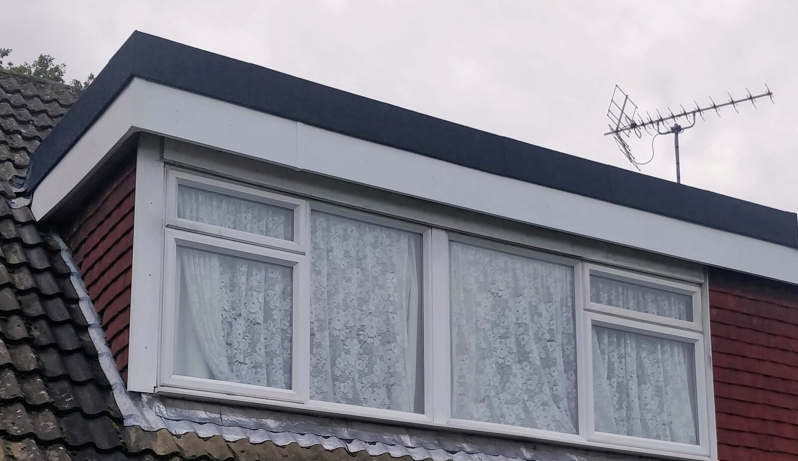

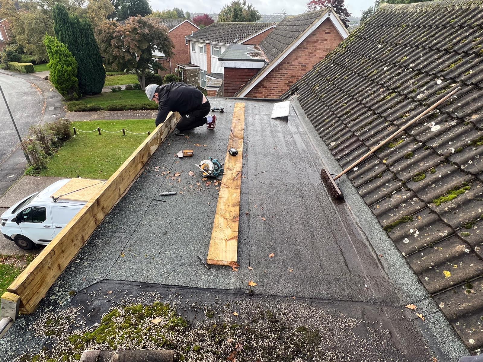

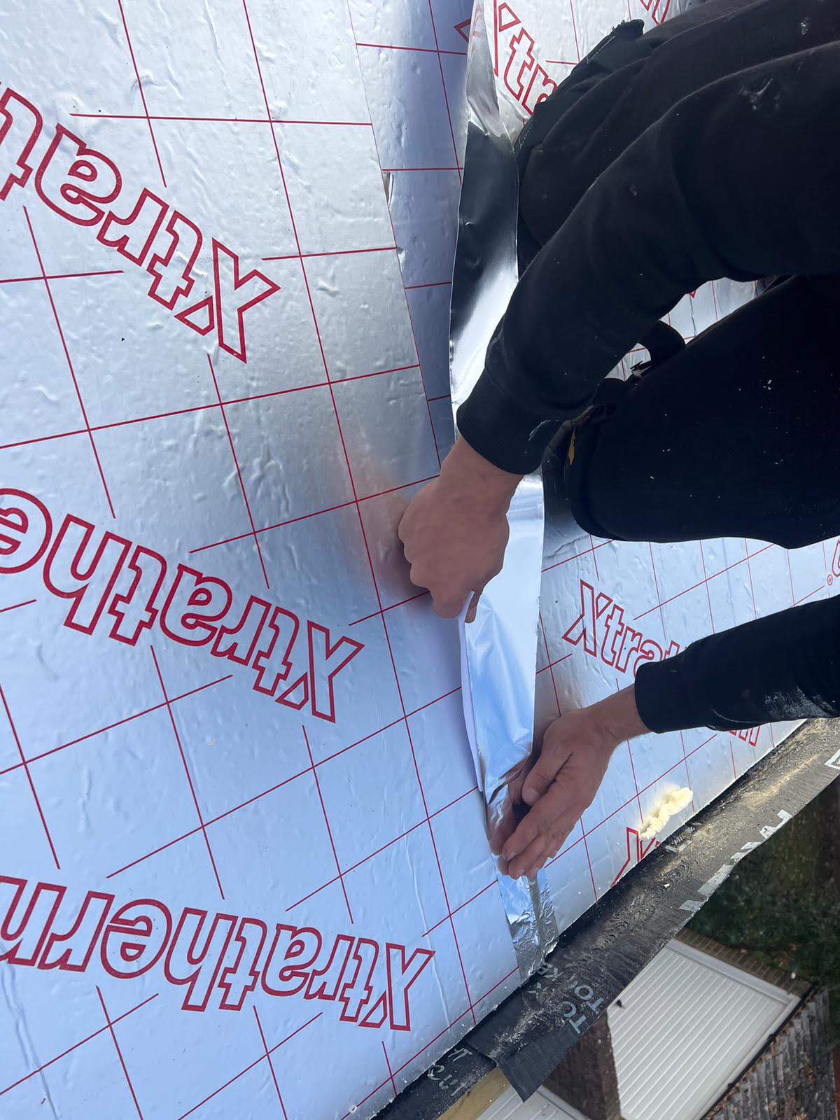

I just had my flat dormer roofs upgraded into warm roof by adding 150mm PIR.
So far as I can tell you can just lay the PIR without any additional support other than the boards around the edge. I went up on the roof when it was finished and it supported my weight just fine. Mine was felt, though.
Structure after retrofit:
- felt
- 150mm pir
- VCL (in my case we used the existing felt)
- OSB
- joists with insulation only around the perimeter
- plasterboard
Photos attached. You can see I had insulation inserted behind the fascia, but otherwise the insulation is just a layer above the joists and VCL.

Yes. The standard make up is the insulation "sandwich", no additional support required.The hardest thing with that much insulation is keeping your 240mm screws straight so they hit the centre of the joists.

Photos attached
Felt straight on the insulation?
@^woody^ I think so - it had a slight give to it. Can't say for sure though - I don't have photos of that bit.
If it's horribly wrong best don't tell me ;)
